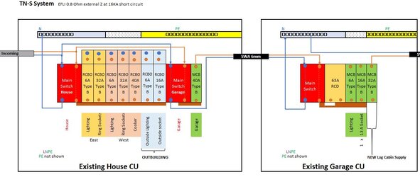

I wondered if it is OK to have 2 x Main Switches in the same consumer unit. One feeding the RCBOs in the House and one feeding the CU in a garage, so that the outbuilding stuff can be isolated from the House CU?

Thanks, but the consumer unit in the garage has its own 100A main switch and 2 RCBOS. This on is for isolting the supply to it.

You should have one main switch which isolates the whole installation.
After that you can add any other means of isolation you need/want.
You can use another 2 pole switch in the CU, in addition to the fuse/MCB, to isolate the garage or you could add an isolator next to the CU, it cannot replace the fuse/MCB. You could even use a 2 pole MCB.
Something has to protect the cable to the garage other than the DNO's fuse (which is probably a bit over-rated for that!)

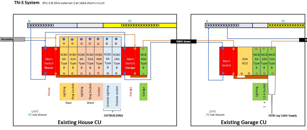

oh, yes, I have allowed a 40 A mcb. Does the attached sketch make sense if practical? Second option is let the Garage Switch to be fed through the House Switch but then if I need to disconnect the outbuilding then I the house will be disconnected as well.
, Yes, so a double pole mcb to isolate both the N and the L, N should be isolated as well. By using a double pole MCB I will save space (instead of the 40A MCB and the Main Switch).
Another option is use 2 x Henley blocks to add a separate CU in the House to feed the Garage CU?

If a board is marked up as having a main switch then it should isolate that DB so that there is nothing live after that main switch.
