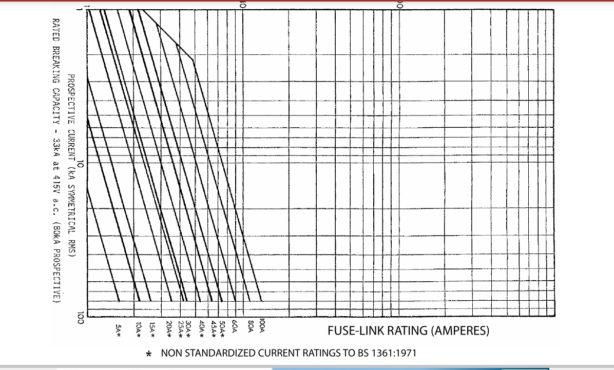

A PFC higher than the breaking capacity of the MCB/MCCB isn’t always an issue.
If there are fuses at the incomer, these do have the ability to limit the current.
The term perspective fault current is that level of current that would flow if nothing interrupted the current. If there is a high enough current, the fuse will blow and interrupt the current before it actually gets to the perspective value.
Take this example - for the standard incoming fuses used in residential properties.
On the left is the perspective value, take say 10kA, this would be higher than the normal MCB breaking capacity of 6kA.
However, looking across the 10kA line, it hits the 60A fuse curve at 5kA (measure on the bottom scale), thus a 6kA capacity MCB would actually be ok for a 10kA PFC if there is a 60A fuse fitted by the supplier.
However, if this was replaced with a 80A fuse, then the through fault level is just over 6kA, so a 6kA capacity MCB wouldn't be safe.
If the PFC was 9kA, then a 6kA MCB would be ok with a 80A fuse, put a 100A fuse, and again 9kA PFC would result in too much through current for a 6kA MCB (a little over 7kA) etc.
So a PFC higher than a MCB breaking capacity could be ok - but it involves some detailed investigation

Where is that chart from Julie?

For the domestic situation the CU is certified by the manufacturer to be safe in conjunction with the usual DNO fuse range. Basically as @Julie. has described the fuse has good current-limiting characteristics so the PFC can be higher than the MCB as under a big fault it will start to blow and so limit how much the MCB has to interrupt.
Sometimes you will see tables of "cascading values" that provide the breaking limit of a given fuse and MCB combination and they can be used for other situations to decide if a circuit is going to be safe under worst-case fault conditions.

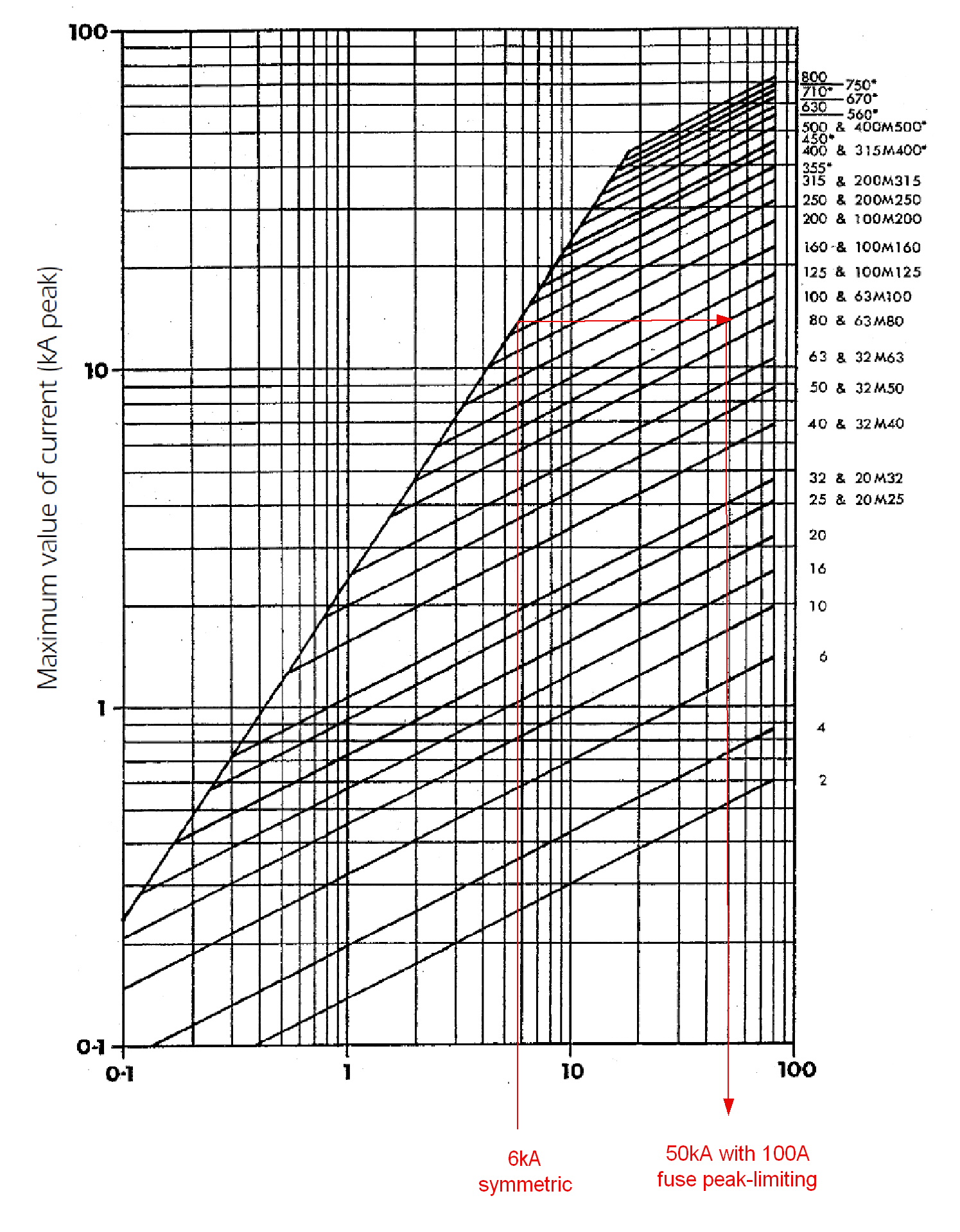

I always though the MCB was rated at 6kA symmetric PFC, in which case that is close to 14kA peak, in which case a 100A fuse is limiting to that up to around 50kA symmetric, making some crude assumptions:
Yes there is a difference between the two, unfortunately the info in the MCB, and fuse manufacturer's data isn't always clear - so I just kept it simple, if I was doing the checking myself I would ensure I got the data. Especially the actual peak Asymmetrical to rms symmetrical ratio of the MCB, I haven't looked at the most recent standards for MCBs and RCBOs - last time I actually looked at the proper standard it was the old standards!
Indeed the "correct" answer is probable between those two cases (assume MCB is peak-rated, assume MCB is symmetric rated but peak is in keeping with fuse's resulting peak, etc) but quite device-specific.
