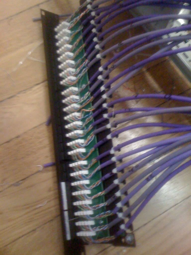

Have completed many office refurbs and put anything up to 14 points per office back to comms cupboard and connected to patch panels.I check and test with a simple Ideal tester basically just tests end to end termination.Then have a Lancat datacom 6 unit which will certify up to 250mhz speed.All installs now CAT 6,spend the right money on cable about £70 to £85 per 305metres box.Wilts do there own brand which is very good or try Cable Monkey or BLack Box.Only time i have ever had problems is with cheap wholesale Cat 5e stuff,stay well clear.Only use MK logic brand Cat6 connectors although just got some from Mintrans to play with.You must keep the stripping of the cable to a minimum as this does have some effect of performance (so they say). The picture above looks very neat but outer insulation stripped back to far.And a previous post mentioned about other trades showing no regards for you nice cable runs,very true.The Wilts stuff is purple and very obvious ,yet everyone seems to tread on it and use the same feed holes through buildings.
A lot of installs are redone in compartment trunking so power and data are seperated,but if power runs to close to data you do get some effect of performance so plan your runs.No kinks and plenty of sweeping bends and don't cable tie everything to tight.You can get some good velcro straps now.
