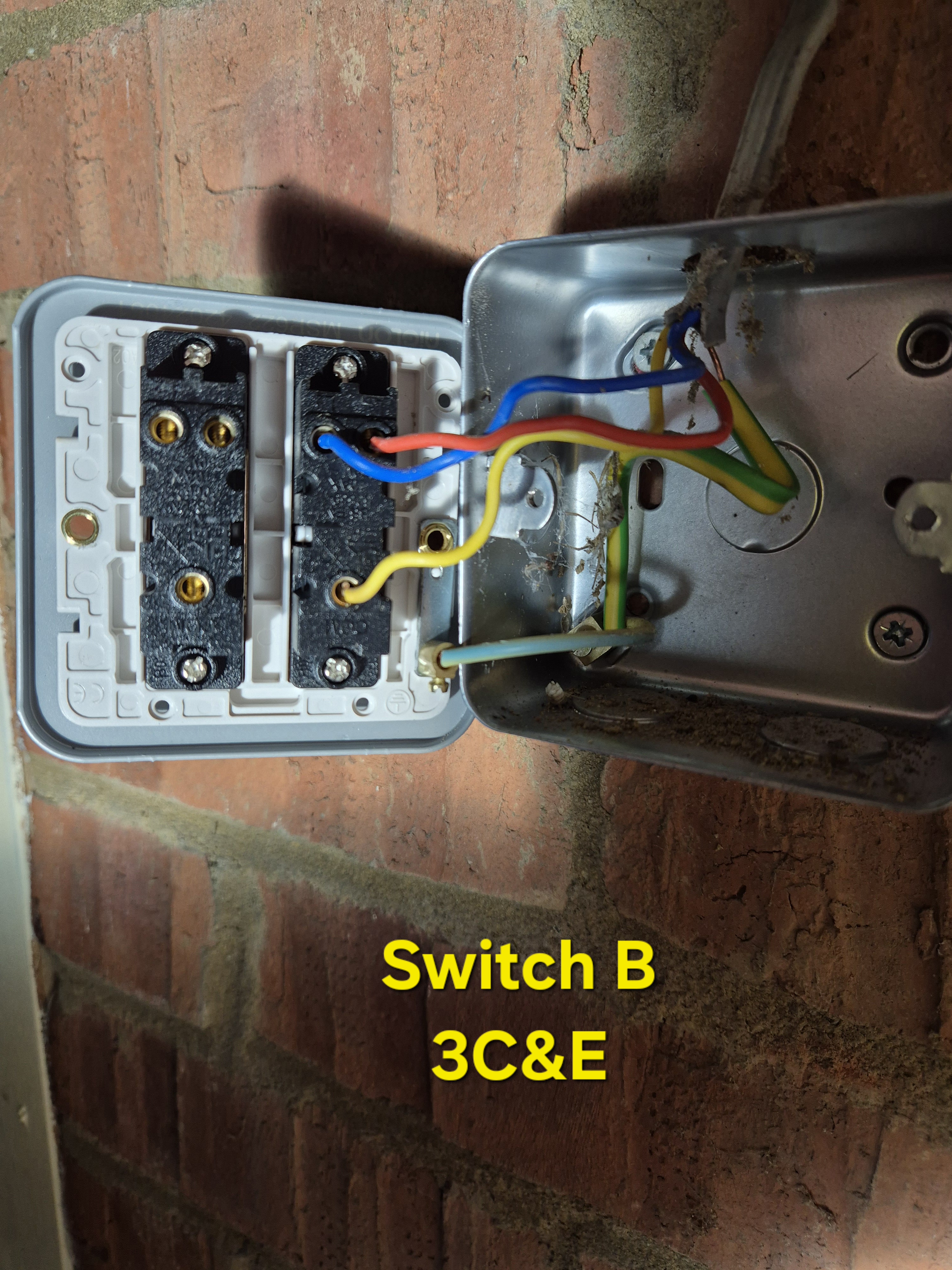

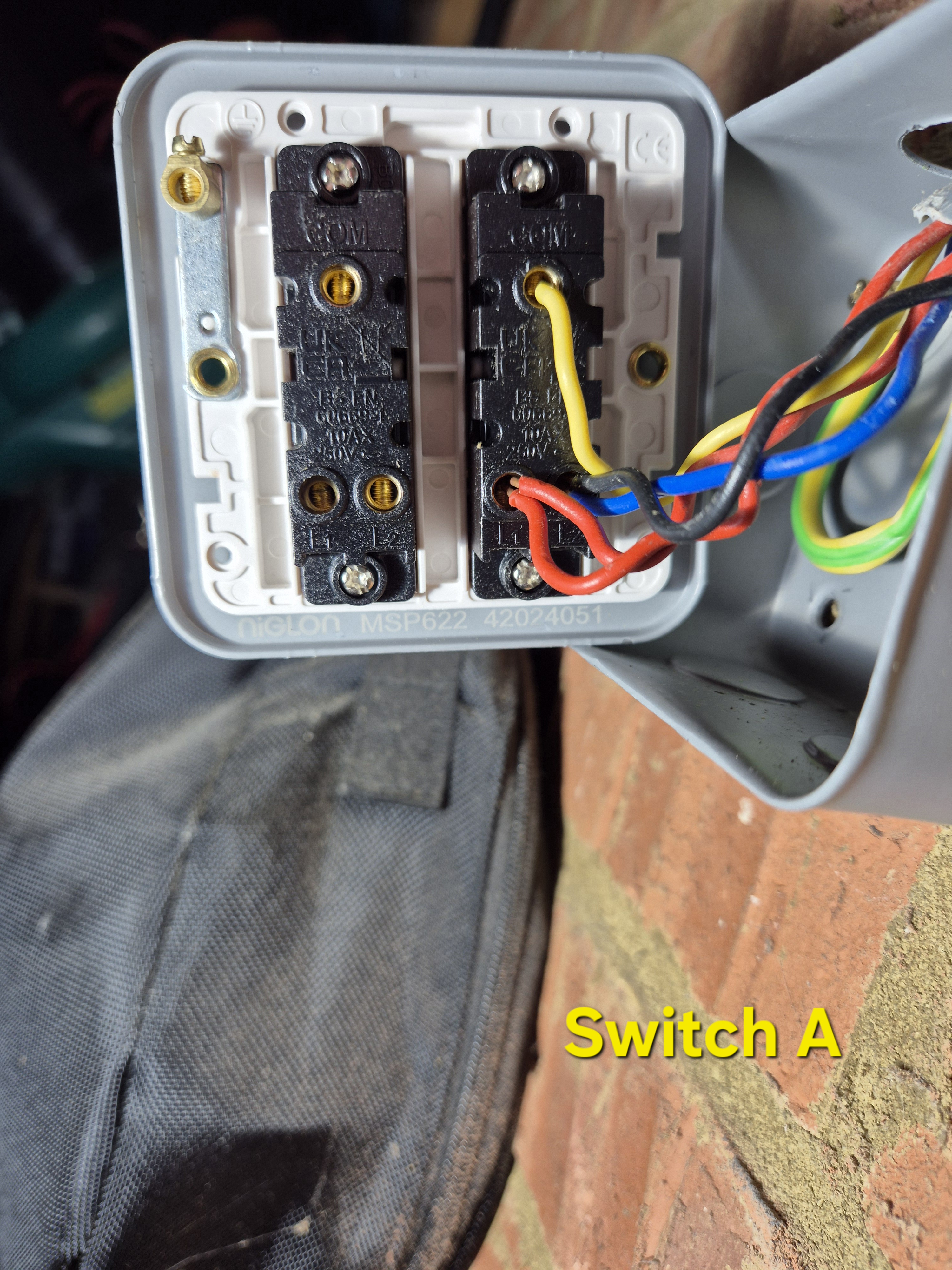

Photographs of 2x newly installed 2-gang 2-way switches, both having replaced earlier 1-gang 2-way. Original backbox temporarily retained on switch B. Neither old nor new switches had grommets, plan to add.)
That doesn't look great, no entry grommets/sealing, earths should be connected to the front plates and one cover screw missing.
get it right before getting it working would be a good motto.
Hi @westward10, thx for prompt response. I forgot to mention missing grommets in my original post (explains all the crap in switch B) - I assume missing since house was built mid 90s, mentioned it in the reply with the photos earlier.
I'd started removing the faceplate to photograph inside when I realised an external photo might be useful (hence missing screw) - that is back in place.
Flying earth added to switch B (in photo), but agreed need to do same on switch A. Welcome the feedback, all important.

It doesn't look like 2 plate to me, it looks like standard 2 way.
You haven't a Neutral at the switch to take along with your S/L to your new light fitting.
4) Preferred option, if regs permit... can I run the neutral from feed at switch A,
As per Mainline above, none of your wires at switch A are neutral.
If you have a multimeter you can check that.
My understanding is 3C&E implicitly has a neutral
That's not normally the case
The possible wiring options are shown, for example, in the link below.
(Yours appears to be the "standard" two way switching circuit shown first)
The "alternative" way of wiring shown, where you supply power to one switch COM and take it from the other switch COM to the light, would allow one of the 3 cores to be used for Neutral, but I don't believe that's consistent with where you have L and N available at the moment.
As I'm sure you know, you can't make assumptions based on wire colours!
