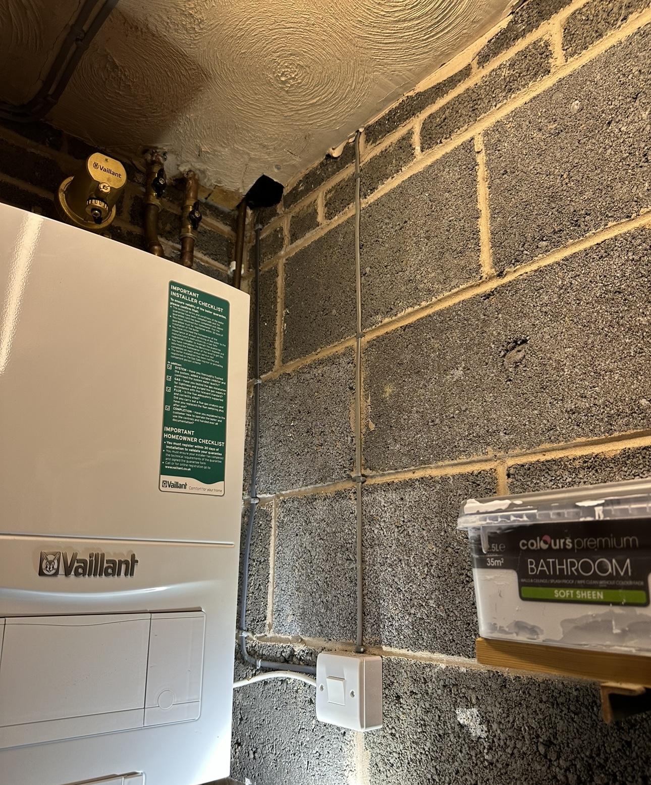

Called out to a boiler not working and keeps shutting off. Plumber blamed the boiler, Manufacturer sent an engineer who said it’s wired wrongly. Plumber said his spark has wired it properly and the property has obviously got dodgy wiring.
I’ll let you draw your own conclusions and yes. That is a 3pole fan isolator. 😂🤦🏼‍♂️
It's normal to fit a 3 pole isolator next to the boiler if the switchfuse is remote from the boiler, this satisfies manufacturers and gas-safe requirements for a local isolator to the boiler.
Obviously it needs to be 3 pole in order to isolate live, neutral and switched live.
That’s the point, it isn’t. The grey T&E coming down the wall is direct from the CU.
I would have used a TP isolator as well, but would have fitted it on a PVC surface box, fitted with a 20mm gland for strain relief of the flex.
Is there something a bit dubious where the flex connects to the boiler PCB?
If you follow the black wire from the flex which is in terminal RT. That leads back to the centre common on the 3 pole switch.
The only cable connected on the outgoing 3C&E is the brown into Common L1
The L & N on the T&E are connected to L2 and Common N.

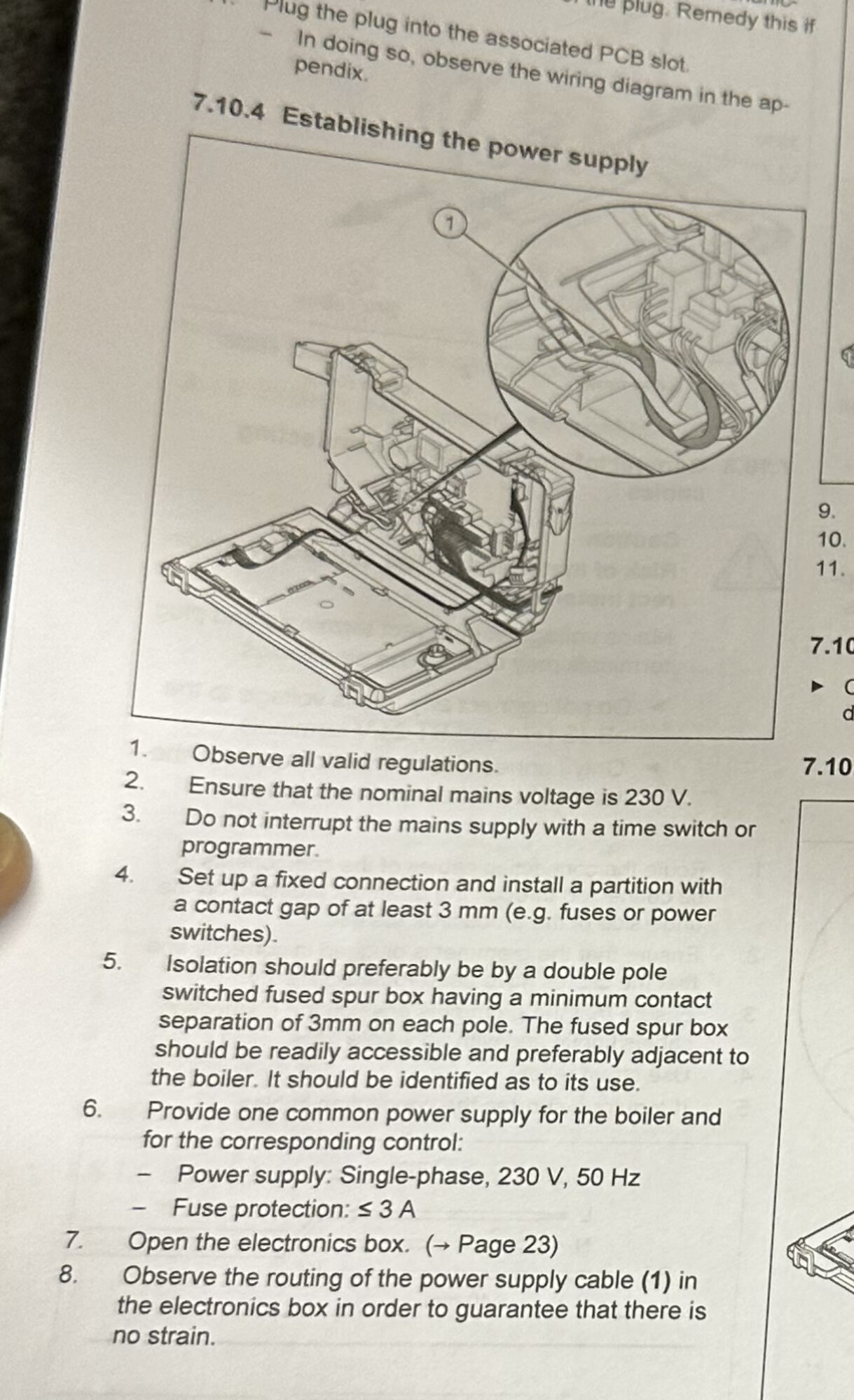

So what I’m trying to fathom, as the instructions aren’t great. Is how this should be wired as the Vaillant engineer said it should be wired with a 5 core cable.
They have done that but cut some of the cores in the flex and only wired one to the controller.
This is how the instructions say the power should come in. Sorry not very clear as it’s a photo I took to take away and look at.
So L, N & E
If you then wire in a controller you have to do it like this. So the live is doubled up and switched live is in RT. The bridge has been removed as I checked it.
So it seems it’s a bodge between 3 & 5 core wiring. But I need to work out how to wire this now and plumb in a FCU as well.
It just needs a supply and an extra core for the RT terminal.
When the RT (room thermostat) terminal becomes live, the boiler will fire. The Live can come from the supply side, it doesn't need to loop back.
You also need to remove the little link that says "ignore the room thermostat" on the other plug as per your photo.
That link has been removed.
The 3C & E goes to the controller. So when I go back next week I'll have to look in that and see which core is connected to the RT in that.
At the moment if the CH & HW are left on it stays working. However, because the RT is obviously not connected, if left to be controlled on a schedule it then won't fire up and throws a fault.
Hence I think I might need to start from scratch, put a FCU in and then work from there.
