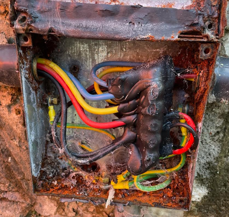

No. That was the electrician.
Easier to snap apart?
Never liked using them as a fixing hole, unless it’s a really thin screw.
The thread cutting into plastic could get too close to a live terminal.
Agree. It really needs to be a machine screw and nut so that there is no risk of that happening
I have come across connectors completely split open when sparks have driven big wood screws into the hole in the connector to fix it to something. if you really feel the need to anchor the connector to the box then a dob of super glue would be better imo

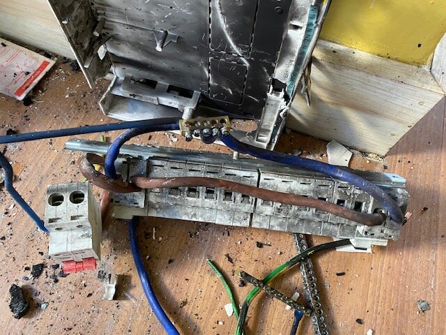

Can we make consumer units out of the same material as that meter?
Its virtually unscathed
Err plastic?
Perhaps we should see the dangers of metal cu's and move over to plastic.
Seemed to work last time we did it.
Old plastic (bakelite) - dangerous let's move to metal.
Old metal - dangerous let's move to plastic
Old plastic - dangerous let's move to metal
So when's the next switch over planned for?

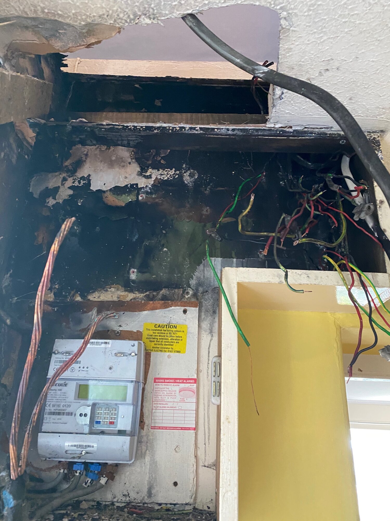

Last time I had that scenario (DNO head burst into flames and set fire to CUs directly above it), DNO sent an invoice to the customer for replacing the head, claiming that the source of the fire was one of the CUs.
Basically the same scenario here, dno moved to an outside cabinet at no cost.
At no cost would have been fine. Customer didn't want the agro, and just paid up (£800 or so, I think). Still had to pay me for replacing the CUs. I said she should send my bill to the DNO, but she never did.
I’d have gone through the agro for £8. For £800 plus cost of CU etc, I’d have been camped outside head office pestering like that plank in Westminster with the megaphone!
There's a bit more to the story that I've stated. This was a 40kVA single phase supply that was connected to a bigger than normal service head, rated either 200A or 300A max. This was connected to an old rotating disc meter, officially rated at 100A max.
Tails were 35mm, the fuse must have been at least 160A, and everything had worked happily for decades.
Enter someone to change the meter (expired calibration), who must have reduced the size of the DNO fuse to match the new meter, so 80A or 100A. This, of course, resulted in frequent power failures, where the fuse had popped, eventually culminating in the fire, when the well cooked head finally cried enough.
The eventual solution was to fit a polyphase head, with two fuses connected in parallel to the incomer, and connected to two channels of a three phase meter. The metered output tails then went to a large Henley, and on to the original wiring.
I turned up on site just as they were finishing this, to sort out the damaged CUs (which were actually Wylex 160s to two sub mains), and pointed out to WP's cowboys, that the four 16mm2 tails, with all their insulation burnt off, that were running horizontally just a few mm above their newly fitted meter board, had been live (from a 25kVA back up generator) all the time they'd been working.

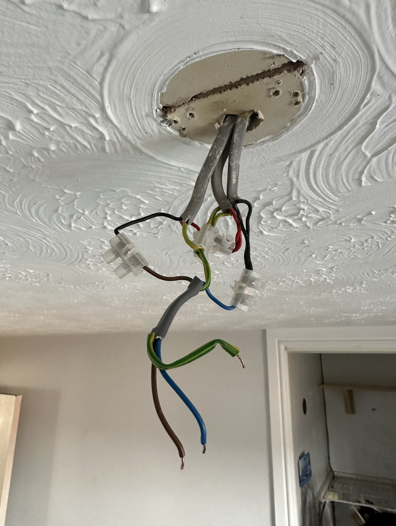

Don't think Wago's where available when the red and black T&E was installed, but obviously worked on since then, the drop to the light fitting is so short they could have used two blue cables instead of a bit of T&E, keeping the earth.
You often see this where people have tried to fit an Ikea or John Lewis light that comes with a tiny crappy connector block just big enough to accept 1 x 1mm cable in each connector
Did two of these recently. Amazing they're all stamped with thag "game changing" UK CA mark. The ones I did were the best part of £300, had those stupid connectors, were designed as Class 2 (somehow) and obviously had no way of connecting 3 plate wiring or even anywhere to park the earth.
Enclosed within the rose and accessible. While not the most elegant of solutions, were any regulations breached?
If one were to be ultra-pedantic (not that any of us ever do that of course) then the bit arrowed should be sleeved with LED tape lights that alternate between brown and red.

Old fluorescent in a kitchen to take down.... Had a red into live, another red into neutral and 2 x normal sleeved cpc.
Up into the attic to see what was going on.... The 2 reds were from 2 x 3core & earth, the yellows connected together, the blues connected together... not in a box.
2 way switching.
Its getting rewired anyway, so will not be staying like this.
No, it was a neutral. Light worked fine.
L&N feed to one 2way switch. L to common, Y and B of the 3 core to L1 and L2.
Y and B linked through at light to other switch, Red coming back from second switch stops at light as switch wire, other red from first switch is neutral from light back to feed neutral.

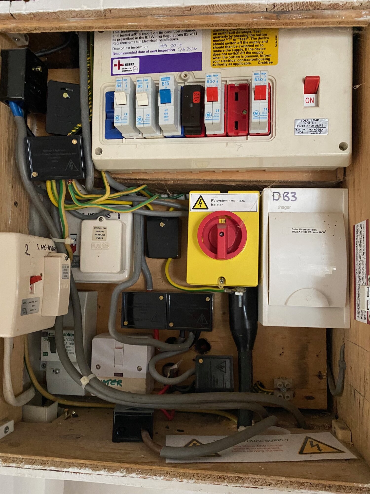

Thicko's don't know how to get to a fuse terminal in an old MEM Exel DB.
RFC needed isolating.
Three phase supply installed, by them, from right hand side fuses but had to do a bit of circuit shuffling. RFC moved to top left to accommodate. All red fuse guards broken off to get at the terms.
Obviously incapable of working out how to remove them.
No sign of any alterations to schedule.
PS. Not the first time I've come across this, by the way.

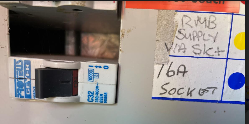

Manager says we had a pir on one of the cottages and Sparky man says that the sub main hasn't an isolator, can you sort one out.
It's fed from here, another cottage next door.
A pair of 16mm t&e feeds 2 cottages from the henleys.
urmmmm i think it needs a bit more than an isolator.
Ho do ou remove those fuse guards? only ones I have seen like that pull straight out or they are held in by a clip and a ph1 screw
