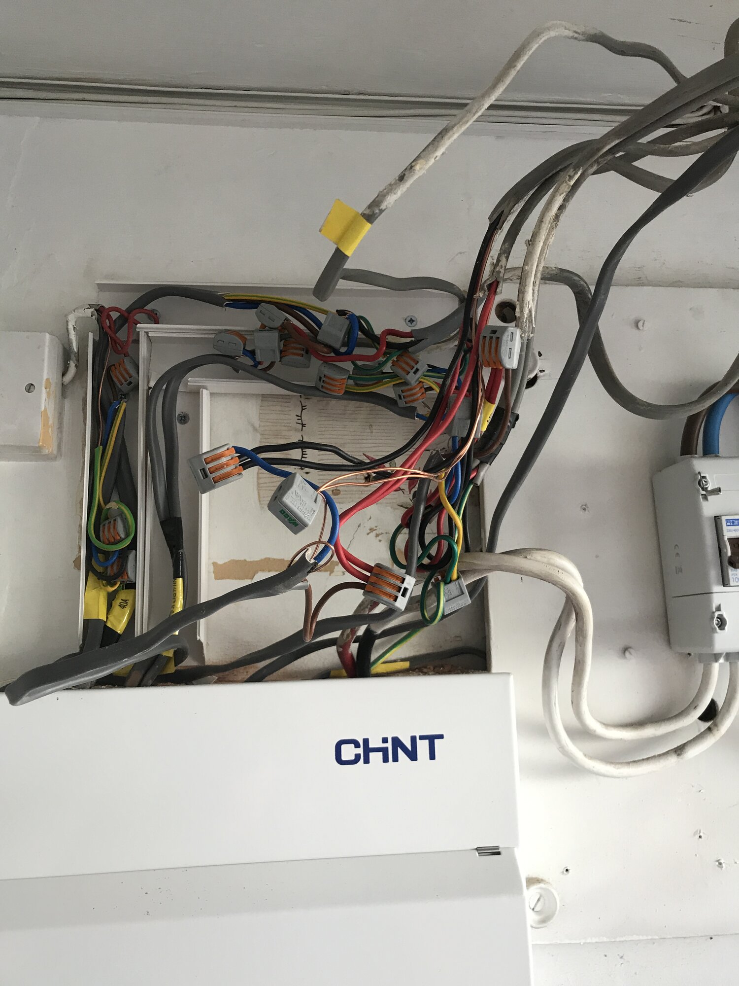

My friend had a new fuseboard fitted I went to test it .unreal

Was that all hanging like that, or have you pulled it out the trunking?
live?
wagos should be in an enclosure, not the trunking, but sometimes it’s unavoidable to joint and extend cables into a new board.
looks like finishing quick came above tidiness in this job
Difficult to really know without a photo further back showing more, but I'm thinking why was there not room to just install the new board where the old one was, and not need any junctions? Possibly moving the isolator a bit if needed.
@littlespark , is there a reg that prohibits connections in trunking? Sometimes I use a length of 100 X 50 plastic trunking in which I extend cables for board changes. It would be good to know if I'm getting this wrong.
I was under the impression that trunking is an enclosure, this is from definitions:
Cable trunking. A closed enclosure normally of rectangular cross-section, of which one side is removable or hinged, used for the protection of cables and for the accommodation of other electrical equipment.
Agree …trunking is an enclosure.

The consumer unit is a Skrewfix brand. Maybe a clue it's a DIY-type replacement, not a time-served sparks. The fixed cables should have been marshalled into an adaptable box with a DIN rail connector bar to extend the circuits to the CU. Utterly dismal workmanship which should be isolated, corrected and tested.
Trunking can generally be accessed by just pulling the lid off, is there anything in the UK Regs, as in France, that says to be in an enclosure only accessible by the use of a tool?
That is my understanding, so a length of ordinary plastic trunking is not suitable for joining cables, unless the joiners themselves are enclosed inside the trunking.by something that needs a tool to open it.

A ceiling rose cover, for example, can be also be removed without the use of a tool. Thus revealing live connections. I would be ok with a properly made joint in PVC trunking. In fact the lid is often hard to remove.
It's a dog's dinner certainly, but, electrically speaking the only real things I'm seeing are crowding/grouping issues, wrong size terminations for the 6mm and some missing cpc sleeve. For a handful quid more this could have been done properly in a DIN rail dappy box with DIN joiners.
EDIT - just had a second look - have they made an RFC off into a lollipop??
As usual it looks like someone has spent more time creating a crap looking job with issues than they would have creating a half decent one with none.

There's a degree of truth in this, but often the difference in cost between a pig's ear like this and a first class job is almost nothing.
oh I agree , £65 on a din box and some decent din connectors and the job could have been so much neater
but if the original sparks quoted low to begin with they probably didn’t have £65 to Spend on the proper gear so throw up some trunking and lashed in som3 wagos
im not forgiving this dogs ear badgers claw abomination of a job but the world isn’t perfect
as I said , rip out and start again
Used Chint consumer units many times before bought from an electrical wholesalers, not Screwfix, and find them to be decent.
The live and neutrals connecting the RCDs together and to the neutral bars are a solid conductor and not flexible which I much prefer.
The pre manufactured connections of flexible cores inside a new DB which show a lot of copper at the neutral bar connection are one of my pet peeves.
134.1.1 & 510.3 & 526.203 - Bet Wago haven't approved the product for such use
526.3.vi - Not MF in the current state
Not sure any of wagos lever connections can be used in MF situations only the push fits I believe, that situation wouldn’t need to be MF anyways would it? As the connection is easily accessible
