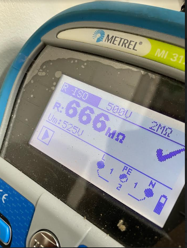

I got this IR result in a church last week which made me chuckle....
