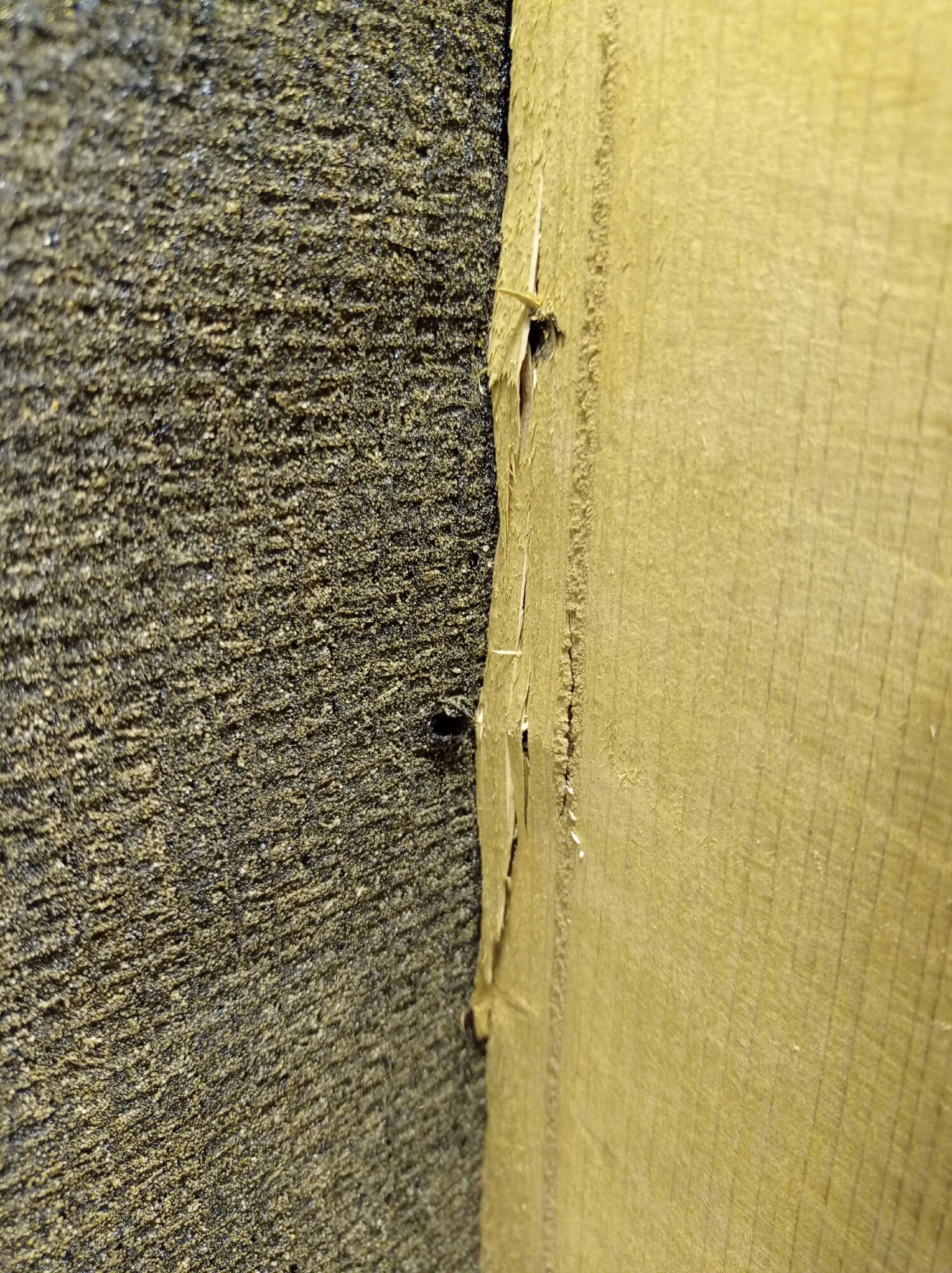

Hi, Recently I had solar panels fitted and realised how they have done it and I hope someone will be able to give me advice how bad and dangrous workmanship that is.
1. They trilled through the slate roof so hooks rest on the slates and then going into rafters. Basically slate became load bearing. I have noticed couple of broken slates when they damaged it whilst drilling and they used some sort of silicone to glue it together! I can only see 2 slates badly drilled through but I only have a view of the hooks which are closest to the gutter. God knows how many more are like that up the roof. 1 of those hooks has a loose screw, which you can see is not even screwed all the way in. Head is 2mm above the slate.
2. In the loft I realised that they perforated the felt by drilling through and not hitting the rafters, then drilling again and on occassions not hitting the rafters again! All in all I have noticed at least 10 holes where they missed the rafters and you can see silicone in those holes again.
3. They splintered 2 rafters slightly on the edges byt drilling exactly where the side of the rafter is instead of directly in the centre.
4. Also where there is one of the badly installed hook I noticed that both screws for the same hook did go in the side of the rafter hence they must be barely holding anything and I suspect with the strong wind this will be the first hook that will come of.

Drilling the slate or tile and fixing through it is not acceptable as they are not load bearing.
Should have removed the slate / tile, fixed the brackets to the rafters the cut the slate / tile to fit around the bracket.
The bracket manufacturer would not approve of the fixings done and any warranty with them would be void, nor would MCS approve.
The felt should not have been punctured, cables should have been pushed up through the next upper overlap of felt / membrane.
If done correctly and to industry standards then Silicon would not be required.
Any puncture in the felt should be repaired with a full width of tucked under the overlap above and over the overlap below, so if any water gets throught the hole it will run out onto the felt below.
Given the state of it I doubt they have used the required number and size of screws to fix the brackets.
And it's an absolute guarantee you'll have leaks in your roof.

I wrote an email to the company in question outlining the issues. I have started formal complaint procedure and indicated that they may wish to call me but I will still require response in writing. They still called me and explained that they will recitify the issues but when I said that I need explanation in writing exactly what method they will use to install the hooks and how other faults will be recified in detail he was not happy about this. Apparently they are multi-milllion company and do not have time for such level of details! This already does not fill me with confidence. After explaining why getting response in writing is important to me he did say that his secretary will respond to all my questions. We will see if this will be satisfactory. He said hook will be re-installed correctly (whatever that might be). I asked if they definitely will sit on a rafter and no directly on a slate then I got confirmation that this is how it is going to be. Time will tell. Before I sent a complaint I went to the loft again and checked the roof in more detail than before and discovered that one of the hooks it screwed into .... felt (approx. 5 cm) from the beam!!!!
What I did not like too much is the fact that he is not planning to replace the whole felt, but will apply patches to the felt from the inside. I replied that this solution would only be viable if all the slates that have been broked/drilled to will be replaced. On one hand it is positive that they have acknowledged the problem, on the other I get the feeling they will try to repair it at the lowest cost just for whole install to be "barely acceptable". Unless I am just being negative as they have lost my trust completely.
I forgot to discuss with him what is the plan for repairing the rafters. I have attached pictures of the damage they have done. Do you think from point of view of load bearing would this rafter be classed as requiring repair or is just slight damage that wont have any influence on load bearing and whole roof structure please?
Also is it acceptable that they will be sending the same subcontractor to remedy the problem? I do not like this idea.

I mean the felt is only a backup to the slate but patching up from the inside would do literally nothing in the event of a leak that goes over the existing hole. It will just leak through the hole, on top of the felt patch and then into your house, unless he's going to apply some tar sealant or similar to it.
I'd run a mile.
I am only a DIY guy but from the pictures the screws don't look to be long enough or even big enough. The ones I used myself were at least 100mm long by I am guessing at least M6.
That's what we use, M6 x 100's, but don't forget that on some flashing there is a 40 or 50mm void that the screw will have to pass through before hitting the rafters. If they've counter battened too this will make that distance even greater so imo it's not possible to tell the length used from these pictures.
