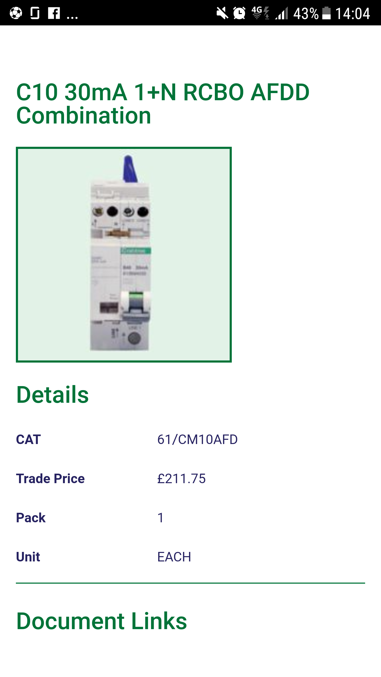

If they think these will take off i recon they are wrong. Retro fitting them will always have problems as the wiring cannot be guarenteed. Fair enough in industrial but not domestic. At 211 for 1 unit. I seen a picture today of a cu with main switch and 8 of these and a spare 2 way space. Didn't have cost but the board size is crazy would need to fit a extention to property to accomadate a new CU. Recon 5 years untill they try impose these.

I have prices a big job in which these would be required so I spoke to Hager and Eaton technical to clarify a few things.
1. Hager do not have any available to purchase yet.
2. Eaton have to import from Germany and are a 16 day lead time and £160.
3. These do not fit into existing DBs. So they will need a seperate enclosure.
As such I removed the need for them as clearly the market cannot currently support BS7671.
What an absolute farce.

You could fit multiple into a contactor like enclosure. My idea was to have those bolt on DB extension boxes and install them in there. I would install RCBOs in the DB for the circuits that required them as an MCB/RCD/AFDD is three modules.

Maybe in 10+ years. The issue is they need a L/N feed and a L/N outgoing so installing them on to a busbar CU/DB is an issue.
Also there is currentlu no 3 phase ones on the market.

It should easy enough if using Schneider’s Acti 9 range as a neutral bus kit is available which converts any live way in a standard DB to a Neutral.
As of a couple of weeks ago...
Despite all the hype and claims of ability to retrofit, whilst Eaton/MEM can provide the AFDD+ device, they recently advised they cannot provide a board in their UK range to fit them into. The best they could come up with was a botch, of having MCBs in the main DB, feeding AFDDs in a separate din rail enclosure.
As already stated, Hager have no product availability yet, although I guess they are close, as they have published SKU codes. These are 2 module width MCB+AFDD devices, no RCBO options, unlike the 3 module width Eaton offering.
Siemens, we gave up with, they were as helpful as a chocolate teapot.
Here is an out of date Wylex information sheet on the things.
  • Informative
Reactions: static zap
"Trade price 211," Oh well must be a bargain then.
