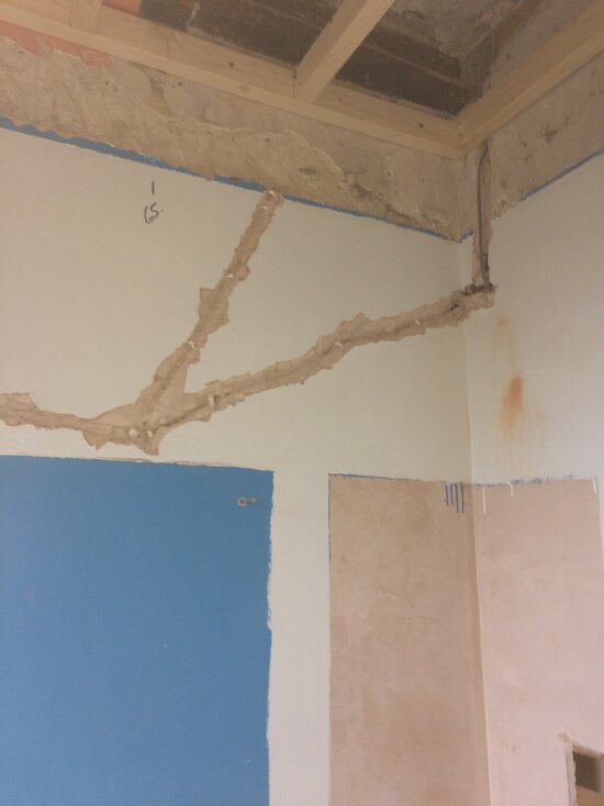

Earlier this week I was working on a bathroom refurb...
Taking a light off the wall - 2 cables - 1 x 2 core and 1 T&E.. the 2 core supplied the live off circuit 2, the T&E supplied the neutral from circuit 3, and neither run in a safe zone.
And the icing on the cake - neither circuit had an earth.... just shows the importance of safe isolation
