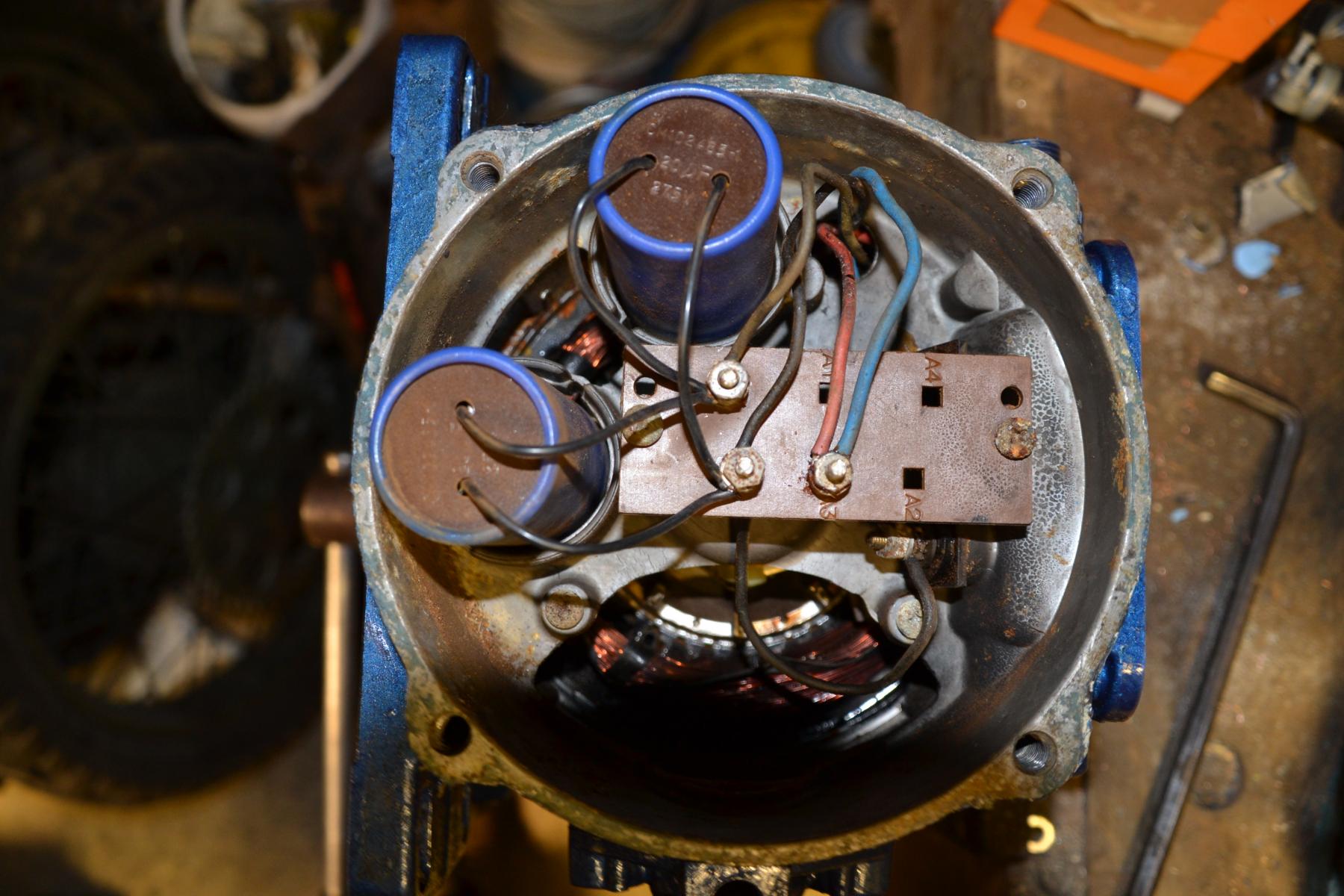

looks good to me do bear in mind Marvos advice
Quote "
  • Start up of the motor should be crisp and you'll probably hear the centrifugal switch operate with a click almost instantaneously. If it's slow to start or there's humming/buzzing then disconnect immediately.
  • When power is disconnected it should coast slowly to a stop and you'll hear the centrifugal switch operate when the rotation speed gets low.
  • If the motor has a running current marked on it check the supply with the motor running using a clamp on ammeter. I'd think the running current should be around 50% of the stated value if there's no load on the motor. If the actual run current is greater than or almost equal to the current stated on the motor there's a problem and disconnect quickly before the windings get burned. "
reassemble it exactly as it came apart and just reverse the black and the red wires that go to the windings to achieve reverse rotation.
Hang on - I'm confused now. Mykey said swap blue and yellow - the circuit with the switch in it. ?
What have I misunderstood ?
No Marvo said move the main winding (red and black) I said move the start winding (yellow and blue ) only one needs to be done or the motor will not reverse But any one swap should work
So both are correct just choose any one pair to swap looking at the picture you swapped yellow and blue so it will be ok to try now
Sorted ! Purrs like a kitten. And clockwise.
Mykey, Marvo and Lucien thanks for your help. If there was such a thing as a virtual pint I'd buy you one each.

Certainly did learn something - and re-affirmed my belief that anything is fixable. It amuses me that to start with my expectation of success was pretty low yet in the end it was just 'swap two wires'.
