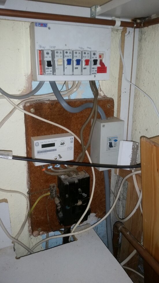

Hi all,
Maybe it's a bit long one but I've got a big task ahead!
I want to rewire my house and ungrade consumer unit.
I'm looking to achieve few things here. Firstly, as recently completed domestic istaller course so need to gain more practical side.
Secondly, it's our home so changing quite old wiring and CU upgrade is quite reasonable I think.
The house where we moved in recently is quite old, with red & black wiring, CU, service head and meter located in the kitchen cupboard underneath and it's not accessible for service(one of the reason to change), only good enough to reach the breakers, very old CU, no RCDs. Also no main switch to isolate power to CU which means I'll have to contact supply providors to remove cut off fuse before work. TN-S system
In the kitchen I have storage that we don't really use and I thinking to install new CU there. Its reasonably accessible. Or on the wall next to storage.
Also I would want to replace lighting circuit, probably replacing ring and radial circuit as well, adding one or two extra sockets. Currently cables are run in the loft, it looks messy, some not fixed and run on the joist. I want to put floor boards there so new cables should be adequately fitted.
I wish to do most work by myself. Apart from dealing with the service head.
My question is:
1)what is the installation guidance for meter tails if there are to be run for about 4-6 meters in the kitchen from meter to new CU if it's fitted underneath the cabinets and cooker. Or tails can go up to the loft space and come back to the storage unit (about10 meters)? Tails mechanical protection?
I thinking to fit isolator on the supply board then connect meter tails to it and run SWA from the isolator to the new CU. Any advice on that?
2)Electrical Inspection Certificate is to be issued upon this job. I'm not on self certified scheme yet but need another electrician sign off this work.
My relevant qualifications: Part P(Domestic Installer course), 17th Edition, 2391-52 Inspection and testing, PAT testing.
Have anyone had similar experience?
Any thoughts would be helpful and welcome.
Picture of current arrangement attached.
Many thanks in advance.

1)the max meter tails is 3mtr service head to c/u .
2)in order for you to move the c/u to new position a s/fuse need to be in place for sub mains
3) when Dno will replace your meter with smart /m by put in their isolator for the work to be carried out
4) considering you are not reg with a scam, it would be wise for reg spark to do the job with you .
5)for mechanical/p box in in the swa/cable to make in look nice.

Does it actually need rewired or just altered to make it tidier in attic and added sockets? Its T&E, and even red & black is still serviceable. Just check for c.p.c in lighting. Could be T with no E
Get an experienced electrician in and ask if you could assist. Tell him you'll do all the labour - running cables, clipping etc if he designs it properly and signs off at the end.

You may find it better to get a price from your DNO to move the complete service head to a position of your chosing.
The CU is not that bad condition wise, but the install is a tad messy, an eyesore to be truthful.
You talk about "cables are run in the loft" your house isn't a Bungalow by any chance is it?
On completion you would need to issue an EIC Electrical Installation Certificate, not a teasting certificate, you will probably have difficulty finding a third party to issue the EIC unless He/She had been present, or inspected the installation during the different stages of the work, because what He/She is signing for is prooff that the install has been done correctly. Wanting to do the work yourself is all very well, and whilst I don't want to knock your enthusiasm in anyway, are you sure you have the technical and practical experience to do this work, you will probably answer yes, but personally I doubt it.
Sorry if that is not what you were expecting, I wish you good luck in your endeavours regardless.

Hi Igor.
I may be mistaken but from the photo you have supplied it looks to me that the main earthing conductor to your proteus consumer unit is a small piece of un-insulated tinned copper. You might want to upgrade this whilst you think about what course of action you are going to take in regard of your future works.

I think you might first start with doing an EICR on the property to assay what condition the current installation is. This will then inform you of what problems you may encounter if you do decide to go ahead and what existing wiring/cabling is good and what is bad. I can see you are going to use this to gain some experience and I venture that it would be a good starting place without putting yourself right in the thick of it. As above I would echo the caveats of others that you may need to be shadowed on such a project as it is your first?

This is maisonette house, we are on the first floor and have loft above literally covering whole flat.
Main earth conductor
doesn't have sleeving and size doesn't looks to be 16mm. Plus another earth conductor doesn't have sleeving. Could be seen on the picture. Thanks Sym to point it out.
Upgrade is need it because cu isn't accessible for service, workmanship not followed, the terminations on few switches/points doesn't looks great, I'm not happy with T&E condition in the loft(signs of wear and stress due to improper fixing or lack of it) no RCD. Also there is no earth conductor on the lighting circuit(cpc not found on ceiling roses and switches).

Looks to me like TN-S and the Proteus rewirable fuse have been changed to Wylex plug in MCBs.
