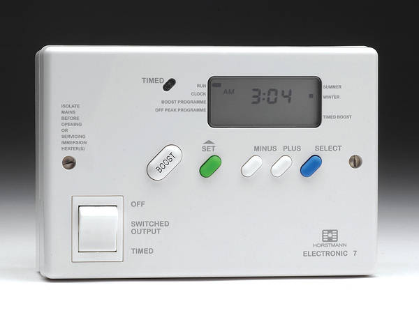

I have a Horstmann Electronic 7 timer switch in my kitchen which is faulty and I want to replace. However, I no longer have Economy 7 or off-peak supply, just standard rate. The timer is only for my immersion hot water heater (3kw) which I want to programme to come on at different times of the day or boost when required. What is the best recommended switch to buy, preferably close to the size of the Horstmann to limit the redecoration required

You may know the Horstmann timer you have, sorry had, can be linked internally (joining terminals 4 & 5) to just operate one immersion with all functions available for the single immersion. Or maybe it's wired like that already.
So buying another Horstmann might be a simple solution (new best price ~ £60)
You may know the Horstmann timer you have, sorry had, can be linked internally (joining terminals 4 & 5) to just operate one immersion with all functions then available for the single immersion.
So buying another Horstmann might be a simple solution (best price ~ £60)
The Horstmann I have is designed for use off-peak, which I don’t have. I’m not sure what you mean by one immersion as I only have one immersion heater, but the biggest issue is that the Horstmann only allows me to program one one/off cycle, when I would like multiple on/off cycles at various times in the day. The horstmann was installed when I had an eco7/off-peak option which has since been removed
The current Horstmann electronic 7 has three on/off periods per 24 hours, and it's not exclusively for off-peak. If you need more than 3 pre-programmed on periods during the day, I agree you will need a different unit.
A typical hot water arrangement was to have an immersion heater at the bottom of the tank, and another half way up. The bottom one would be using off-peak, and the upper one used for a boost (so you would only ever get half a tank of hot on 'boost').
The Horstmann is designed for the twin immersion situation, but with one immersion you can still use it as a conventional timer.

The "electronic 7" (which I used to have in our property!) has a single supply in, and is configured to drive 2 immersions but ensures that both can't come on at once (obviously!). The instructions include the option to link the off-peak and boost immersion output connections together, so all the features can be available for one immersion.
It may be that GaryMac's timer was an older version than the current model above
The E7BX has separate incoming supplies for off-peak and normal
Ie two supplies (off-peak and day rate) into one single immersion:
The Economy 7 Quartz has just one supply input, as per the electronic 7, but seems to be based on 'mechanical' timers:
Used for one supply to feed two different immersion heaters normally.
And the note about linking the outputs holds true for this one as well:
