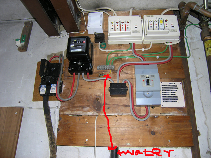

I am seeking someone advice on a consumer unit. I moved into an old house about 1 year ago. There is an old fuse box board in a garage which control whole house, the electricity system in the house seems fine as it should be. But I am worrying this old style fuse box may not provide as much protection as the modem consumer unit.
my questions:
(1) Do I need to replace it with a new consumer unit? and why?
(2) there are 4 ways in each of fuse box, each fuse box maximum load is 60A, what specification of the consumer unit must I get?
(3) What is the best brand of consumer unit would you recommend?
(4) I am in south London, what cost would like to be for labour and all material?

doubletiger watch the moneysaving comments they all seem to be talking about what I call the £250 cowboys who turn up change it over no documentation dont bother about earthing and if there is a fault sometimes they are on this forum looking for free help to fix it
Please see two additional photos
it is clear it bonding to gas pipe from 1st photo. I think it also bonding to water (black from bottom of board), may be yellow bonding it (behind the board)?
If it bonding to both gas and water, do I have to replace these two old fuse boxes?
thank you for advice!

Agreed with many of the other comments, Gas Water looks Fine, Just need an Main earth Now....

Top Cat -- "have no earth spike in the ground", I think you are right, I cannot it.
DurhamSparky -- thank you for website link.
My question now is -- Should I just install earth spike into the ground and leave others intact?
of course, I will use a competent person to do it for me.
thanks
thanks
First and foremost, contact your area DNO company and ask if there is PME (TNC-S system) available in your area. I would imagine there would be, being in South London, (...Bromley wasn't it??) This will give you a far better earthing arrangement than, relying on a an earth rod (TT system) installation
If you do have to go the TT route, make sure the electrician uses 2 X 5/8'' extendable coupled rods, and not these thin 3/8'' twigs that a far too common and basically useless!!....
