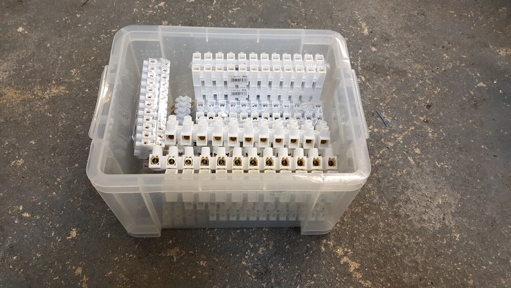

I try to be equipped with the best solution for every possible situation, not just one that works. There are some situations where therminal block is the best solution, so...View attachment 60567
hope you've got plenty of tape to wrap them in.
