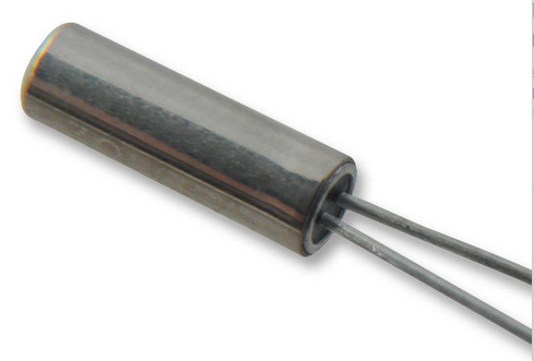

As pointed out by @Lucien Nunes the original watch circuit would use a low frequency crystal.
These days they are all 2^15 = 32,768 Hz for ease of dividing to 1 Hz for counting seconds, etc, and are quite cheap and available in many places. The original choice might have been less as Lucian's points out in the days before dedicated IC dividers and each step was done by using separate parts.
Low frequency crystals are troublesome beasts, they can be large unless 'tuning fork' style, have a high series resistance and today you would struggle to find anything that is not a mass-market frequency. In the past we got custom crystals from the likes of McKnight Crystals in Southampton, England but that sort of small company has long gone as standard frequencies were all that most need due to frequency synthesisers and related microcontroller control, etc, became cheap and ubiquitous.
Your circuit, assuming ideal transistors, would present a negative resistance of around 2*Rc between the emitters (basically a delta-I current through the crystal products delta-I*Rc voltage on both emitters) so if you get a 32kHz watch crystal such as this:
The data sheet has its resistance as 35k Ohm max, however, you need a bit more than that to reliably start up so probably you would be looking at 100k for the Rc values.
To preserve DC stability you need Re to be greater than Rc, so you might be looking at 330k or similar, also to keep operating current down to prolong battery life and to avoid over-driving the crystal (no spec on data sheet for drive level unfortunately). With such high impedances you would need to make sure you don't load the collector too much to extract the signal, so either a buffer or a 100k resistor + coupling capacitor, etc.
Lucian also mentions about the transistor frequency response, that is important as it limits the frequency at which you can get useful gain and (less obviously) it is also current-dependent in the transistor. Looking up the BC548 data-sheet the fT is nominally 300MHz at 5V and 10mA, but could well be below 10MHz in this circuit, so a high frequency crystal may not work without pushing down R to get I up for the transistor.
@marconi also raised an important point about biasing, but with 2V and approx 0.7V (a little less at low currents) for the B-E junction you should be seeing around 0.1mA or so per transistor with Rc = 1k and Re = 10k (so fT probably around 20MHz, marginal here with 20MHz crystal). Hence if you want to use it at 20MHz you might be better to accept high current and not lithium cell powered and just set the supply to 5V and maybe drop emitter R to 2.2k
...32,768 Hz ...
Damn. I made a big mistake. For some unexplicable reason I read the "20 000" marking on my OSX (crystal oscillator) as Mega. While it is 20 Kilo. Damn. And I can not EDIT the original post either to correct it... what a shame. Again, Im not working as often as you guys here, with these OSX's. My VERY simple goal here is to measure some Blank OSX's I have scrapped and collected for a long time. Blank = no markings, no letters or numbers on them. Simple. And quite recently I learned that I need a specialized tool for it, the frequency counter. That I am waiting for at the moment to arrive in couple of months. It would be good to be able to measure the fv only with the osciloscope, and I bet it is possible, but I am very sure not with what I have here.

Hmmm, I just checked the other known values and I didnt give this much attention to this detail which is very important. Which are the Kilo and which are the Mega. I ASSUMMED "20 000" marking is Mega:
So this is the OSX I used so far in all my tests and circuits:
As you can clearly see it does not have a K or M indicator at the end. Thats why I assumed and now I think probably certainly wrongfully.

So a "20 000" without the MHz specified in its end, it might simple be a 20 KiloHz.
Ha.... Right? I am thinking out loud here. Again, I am working with these components almost never. I am not used to them. I am not using them in my circuits that often. All that I used them for was for my PIC MCU external clock signal, and thats this shortcut term I borrowed from as well. Also I didnt used them for PIC's as often as well either. But I thought, to have a bunch of these OSX for some future experiments that never happened.
A 20kHz crystal would be very unusual, especially in that sort of a package. I suspect 20MHz as you initially thought.

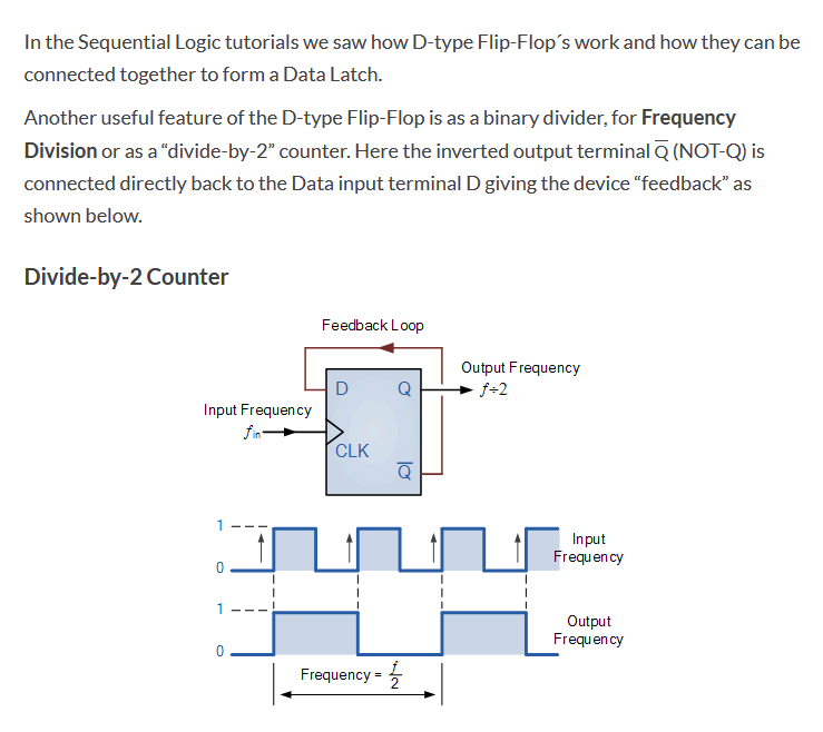

I have an Ingeeneerious idea !
Is there a way to SPLIT the fv of a BIGger OSX into a smaller fv? Just to bring it down under 200 kHz? Just enough to measure it with my dinky osc? Ha?
