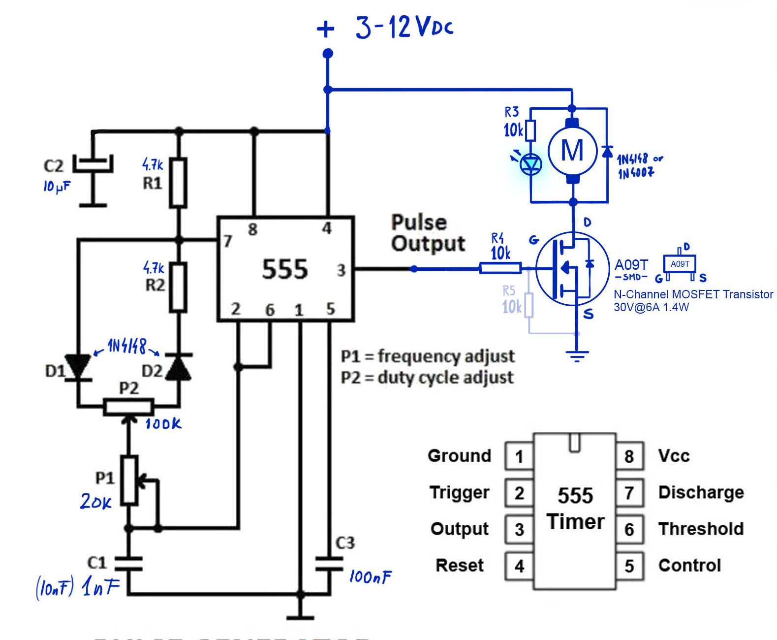

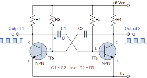

Hmmm... I find Frequency divider using 555 timer !!!
That sort of a circuit only works well for a limited frequency range. A typical digital divider works from "DC" (clock stopped) up to the clock limit of the IC (tens of MHz input for the 74HC family).

I believe you are trying to tell me it will not work using discrete D flip-flops or the 555 version of it, because they will not be fast enough for the 20M (or more) speed. If this is the case, please be clear with me now, before I start doing anything ((stupid)ly hard and slow).
Typically the data sheets only show the 555 going up to 100kHz operation. They were typically seen doing audio and below speeds, with newer variants having additional dividers inside to allow very long time constants without crazy sized capacitors.

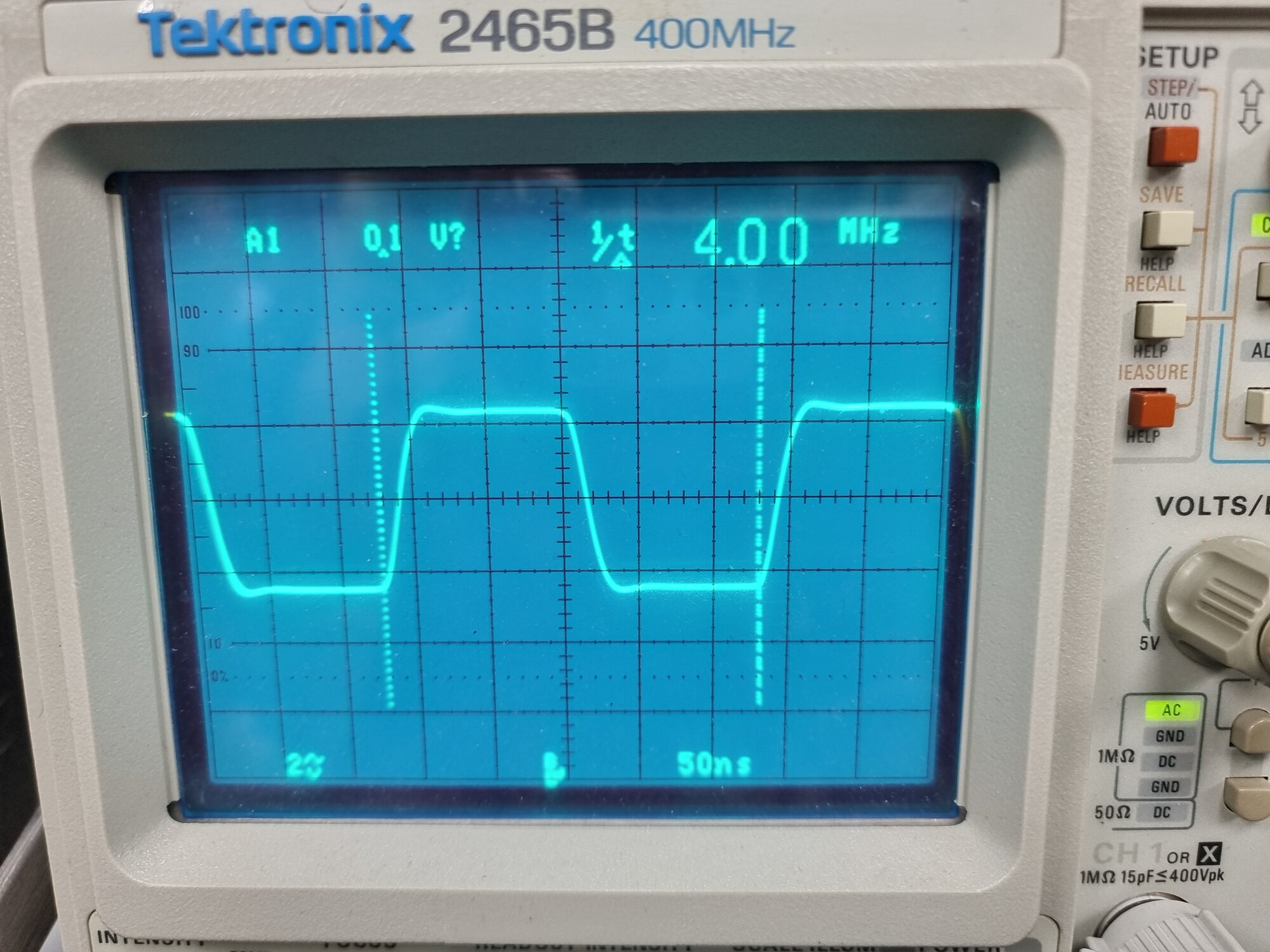

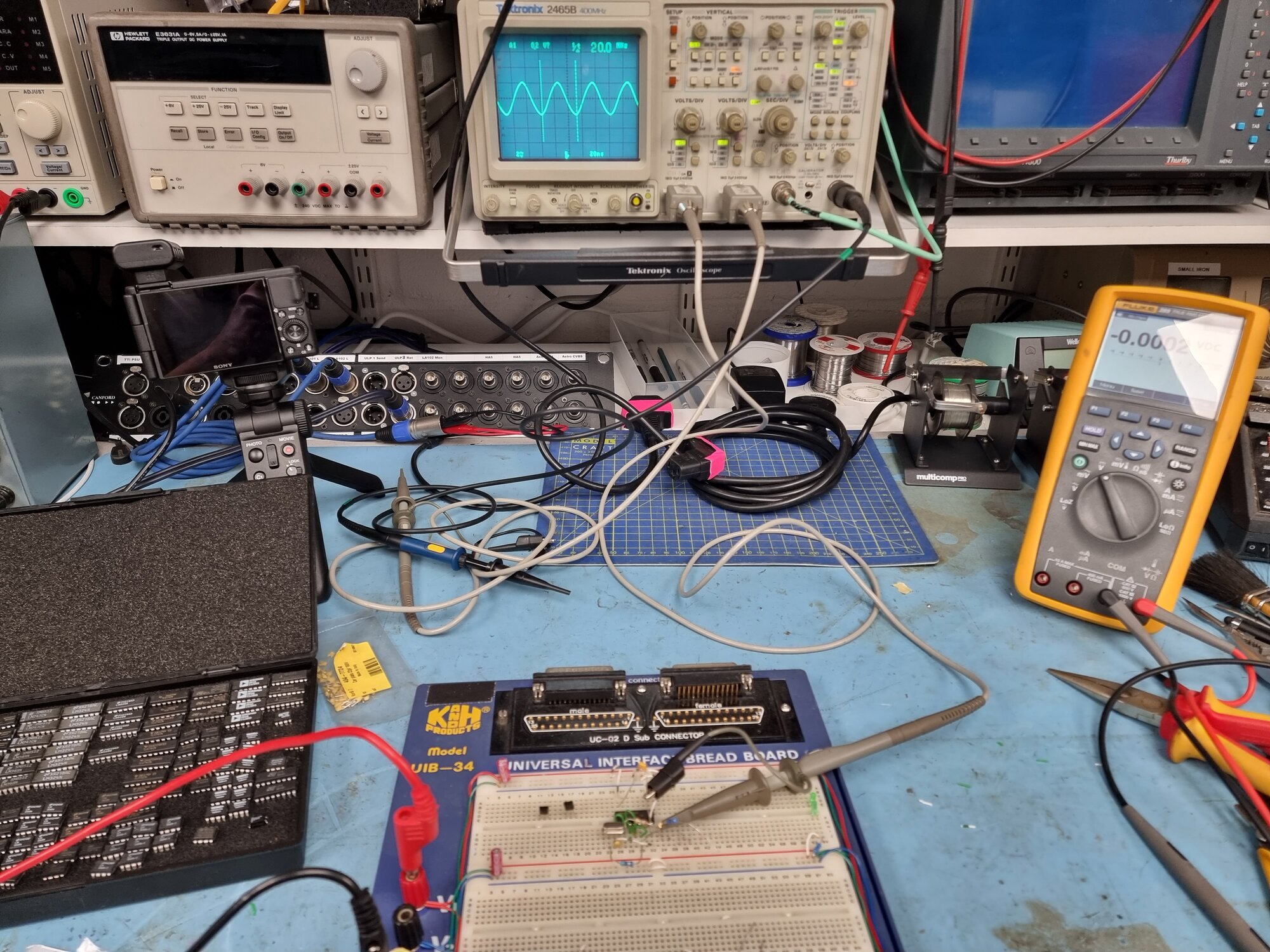

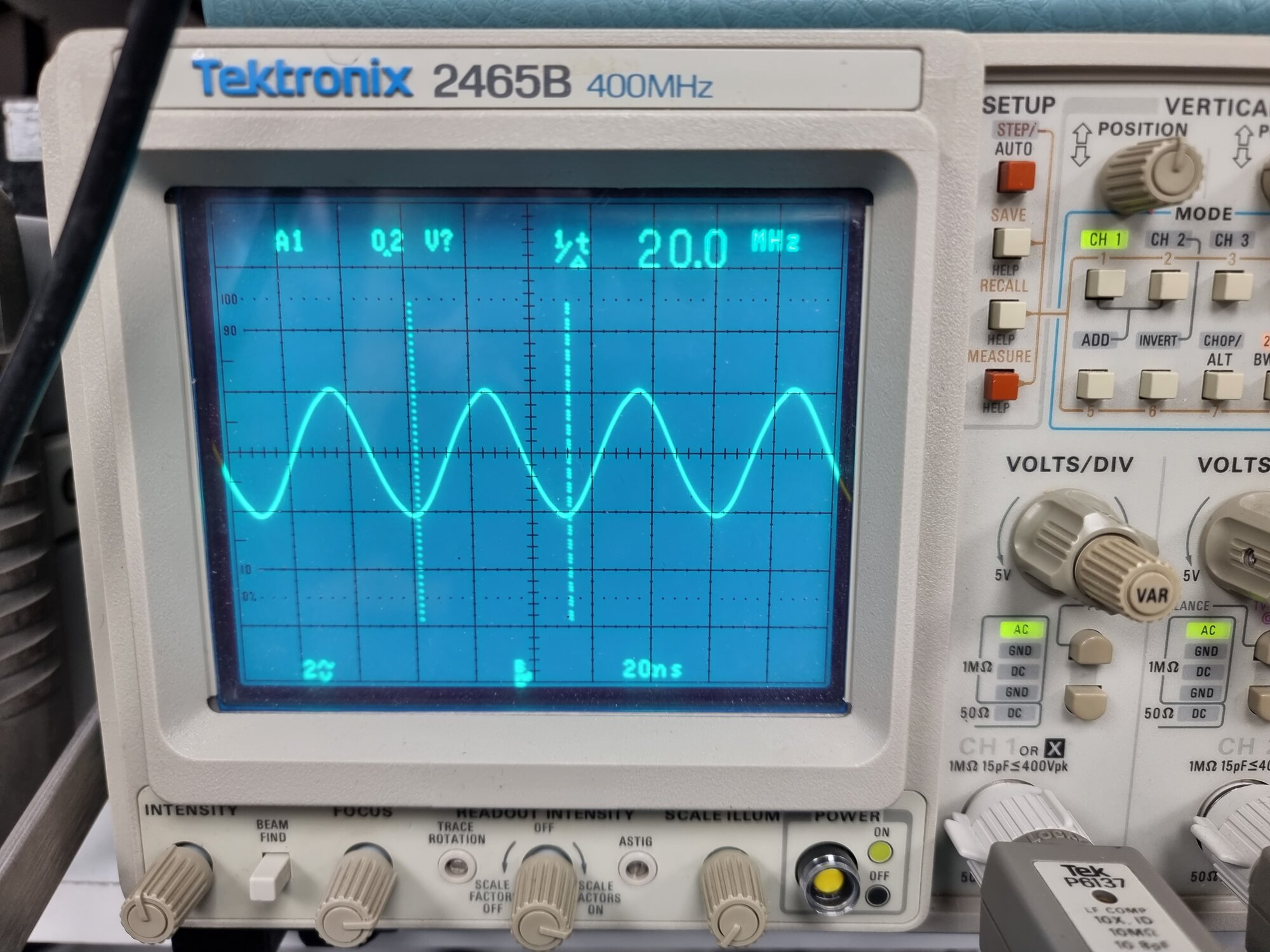

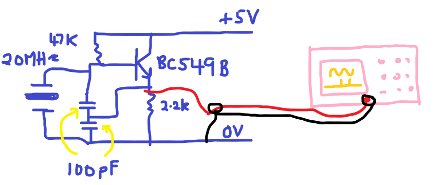

Here is my circuit to test the 20MHz crystals I bought. You can see the waveform and its frequency on my scope. I will draw out the single transistor circuit which uses an npn BC549.
The lower trace shows frequency in 25MHz horizontal divisions. You can see there is a second peak of lower amplitude at 40MHz to the right of the main peak which means the circuit is oscillating at two frequencies. The scope shows the waveform of these oscillations when they are added together.
