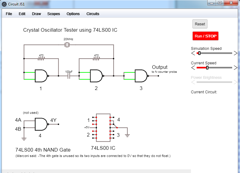

q12x Here is 74LS00 crystal oscillator which you can make when the box of ics arrives. Now you have three circuits you can make to test your crystals with.
Here is the circuit which uses three of four 2 input nand gates in the 74LS00. The fourth gate is unused so its two inputs are connected to 0V so that they do not float. The crystal is in the series resonance mode so low impedance at 20MHz.
I will look at the ics in the box to you and think about which one to use to do the division of fv and then construct the circuit. I am a bit slower off the mark than you are so be patient. :cool: I like to read the datasheets. I quick glance at the 74LS93 4 bit counter specification and it looks like it can operate the first divide by 2 stage with an input between 32 and 42 MHz so it might cope with your 40MHz crystal if the crystal test rigs will still perform at 40MHz. The last circuit using the 74LS00 was oscillating at 32MHz without the crystal in circuit - need to check again though to be sure.

Ive redrawn your circuit, to make it clear (for me).
This is not actually simulating anything, I use it just for drawing (and clarifying).
I think I get you now, thank you for it !!!

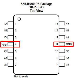

Vcc at 5V and 0V go to pins 14 and 7 respectively - but you knew that - just wanted to be careful.
