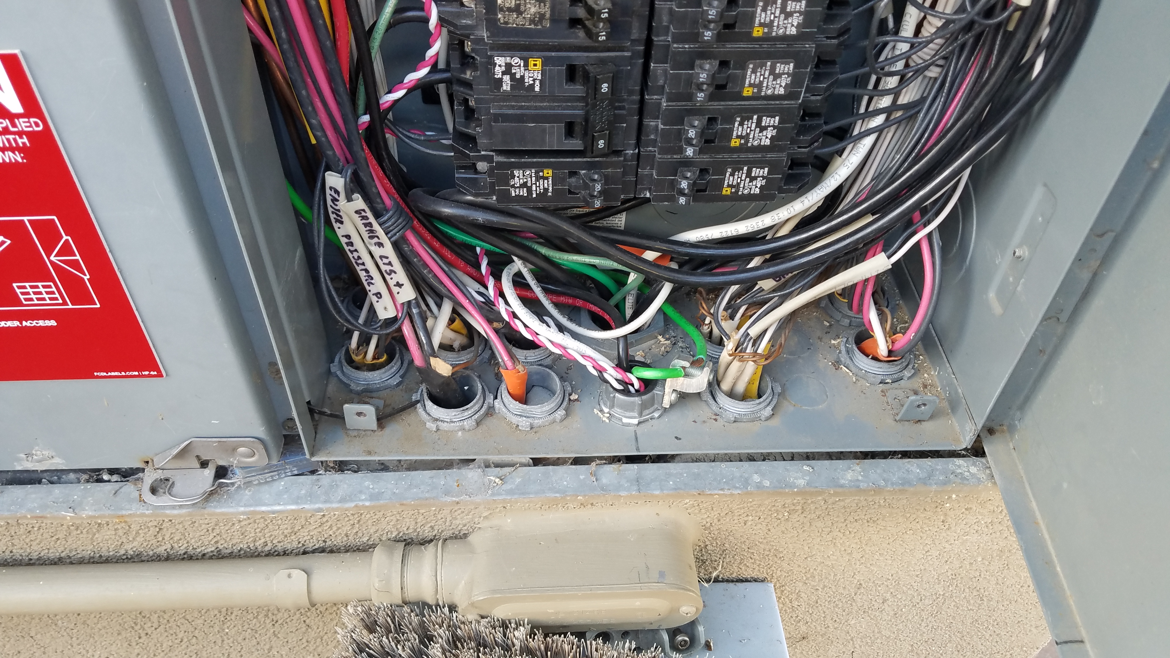

My electrical utility has decided to take our power away - occasionally - to prevent fires. So I have ordered a modest backup generator. To conveniently power the house without running extension cords everywhere, I need a transfer switch.
I have tentatively identified the switch I'd like to use - a Reliance exterior-rated unit, 30A, 10 circuits. It's quite wide, and will intrude into the space occupied by a telephone/cable box. But it will work if I mount it to the side of the house on 2" spacers.
The main panel is flush-mounted in the exterior stucco wall.
There is a junction box under the main panel that is surface mounted, and communicates with the main panel via a 1.5" conduit with some big wires ( which power our swimming pool, spa & sauna ). The junction box is almost empty.
I propose to mount the transfer switch next to the junction box - with a minimal length piece of conduit. Wires from the switch will go through the junction box and hence into the main panel. There will be 22 12-AWG THHN wires. Two wires for each circuit, plus a neutral, plus a ground. I believe the neutral is needed because there is a pair of wattmeters in the switch.
My question is - how do I get from the junction box into the panel? The existing conduit looks pretty full. So is the bottom of the panel. There are a couple of unused 1/2 inch punchouts, and space in a few romex clamps. There also might be a bit of legal space left in the existing 1.5" conduit - but not enough for 22 #12's!
I suppose I could run a pair of 1/2 flex conduits from the panel bottom , through the stucco, into the junction box. Doesn't look like much fun - the underside of that panel has to be just as crowded as the inside.
There is another concept that would have worked if we didn't have solar - an "interlock" - basically, an elegantly shaped piece of sheet metal mounted to the front of the panel. It slides back & forth, and guarantees that the "generator" breaker is never on at the same time as the main breaker. Can't use it because we have solar. No way to guarantee that the solar breaker isn't on at the same time as the generator breaker.
Anyway - anybody have hints or comments about how to get from the panel into the junction box?

Jerry I just checked and you can pull 70 # 12 THHN singles in an 11/2 PVC Conduit according to the NEC in the annex section in the back of the book

Jerry just turn the breaker off feeding the wires in the junction box and cut the green wire and tie the wires to the green wire and as you pull out the green you pull in the new wires in the panel and don’t forget to repull the green wire you cut and with all the circuits you need to pull more than one neutral. I would pull a neutral for every circuit or at least 2 circuits per neutral

Jerry that junction box is your path to the panel
OK, I'm going to go count the existing wires in that conduit ( from the junction box to the panel ), and measure their diameters with a caliper. Then I should be able to use an online NEC calculator to figure out how many #12's I can fit in.
Neutrals: in general, I'm a fan of separate neutrals. I hate it when the lights brighten when the fridge comes on. Not sure if it's needed here though. The way the transfer works, is you have one switch for each individual circuit. So, at the main panel, current comes out of an individual breaker, goes out to the switch box, goes through the individual switch, and comes right back to the main panel, where it is connected to the original load wire. So any neutral in the transfer switch box is not used at all during normal operation.

I don't think I'll need to cut & pull any existing wires. The junction box is about 2 inches below the bottom of the main panel. Pretty sure I can just poke individual #12's through from below.

I just investigated that pipe between the main panel and the junction box. It's internal diameter is 1.5 inches. I don't know what is its type or trade size. It has 7 wires in it:
two black wires, .306" OD, 2 black wires .251" OD, one white wire .251" OD, one green wire .222" OD, and a green wire .164" OD.
So I need to figure out the trade size of the conduit and the trade sizes of the existing wires, and can then plug it all into the Southwire online calculator.
I tried poking a #14 solid that I had laying around from the panel down into the junction box - it went right through.

Jerry if you can push one wire through with no resistance then I don’t think you will have problems with your wires. It could possibly be tight, I don’t know how many wires you want to put in the panel but leave the # 14 in the pipe and use it to help pull the other wires in. Good luck

It looks like it will work. According to the Southwire calculator, the total fill is around 30% with the existing 7 wires and my 22 wires.
The wires are supplied with the transfer switch.
