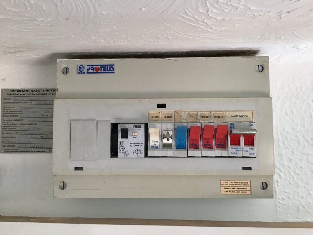

I need to replace an old FC005 5amp fuse holding switch with snapped switch due to old plastic.
Having trouble finding one and hope someone out there has a box of them somewhere I may be able to buy.
If you could advise on what could replace it if not that would be great.
Can I replace single with triple and just use one of the switches?
I do have room on the rail for it physically
no reason why not, but might be an idea to see if a singlepole proteus MCB will fit.
What is the whole assembly doing? Can you post a picture?
If the fuse holder has snapped due to age/plastic fatigue it might be worth looking at the bigger picture and seeing if it could or should be replaced with something newer. As Telectrix says, a MCB would offer a trouble-free way to reset after a fault if there is no special reason why a fuse was originally used.
this is definitely old but can’t afford the replacement at present. I have bought the triple pole that was suggested and intend to swap the two current light switches for two of the replacement switches. Thanks for all advise and help people it’s been an education. Sadly I’ll be back.

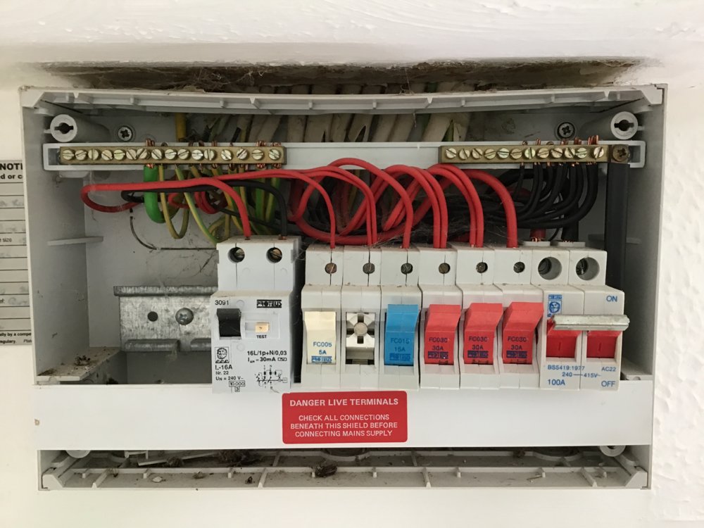

veryconcerned her. that looks like all those MCBs are direct from the main switch, and the RCD is feeding circuit/s without overload protection. in plain terms, it looks dangerous.
I think it is a 16A RCBO for one circuit.
The lack of RCD on the board for the rest is not good, but probably the norm when it was installed.
[automerge]1586957463[/automerge]
Overall it looks professionally installed and I don't see any major issue with replacing the broken fuse holder, etc.

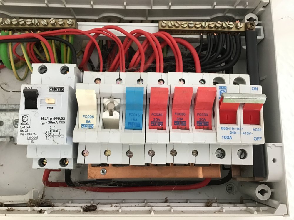

Hard to say, it is labelled "16L/1p+N/0,03" but no indication of B/C/D trip so I am not sure if the '16' is the limit for a small RCD or the thermal trip for a RCBO.

@Singed Could you post a close-up photograph of the RCD device on the left please?
I am certain that is an rcd. From the writing on the front L-16A nr22 I suspect that is third party produced Moeller maybe as I cannot find anything similar by Proteus in a search.
I see CEF/Proteus do sell a 16A rated RCD so they are available.
Very worrying as then we have some 2.5mm direct from a 60A+ supply! BAD!

While we are not taking bets, the current debate is if the device on the left is an RCBO or a RCD. The former is what I assumes as it looks a bit too neat for the sort of person who would not know any better, but other here point to the apparent lack of information on the face of it to back that up. Until we get a close-up photo or similar we are a little worried!
Yes, it has the thermal trip symbol on the live pole but very small so hardly noticeable. I wonder if it is thermal-only? Or maybe the 'L' part indicates the magnetic trip characteristic?
Either way, it looks acceptable all things considered.

this is the result.
I tried a mcb but physically didn’t fit. Would have been ok on the rail but box mounting bracket was in the way of locating clip.
This triple works a treat, just had to move mystery
mcb/rcd over a bit.

I may be using the wrong terminology. The mcb slid into position ok but it was upside down. There is a bracket to the wall behind that just happened to be in the way of the spring clip so I couldn't locate it securely. The other one clipped in either side of bracket so secure and working. I am not using the left hand switch.
It is a shame that the MCB did not fit, but at least you have a working fuse holder once more. Longer term replacing the whole CU would make sense but that is not a very cheap move even though it would bring advantages in terms of reliability and safety.
