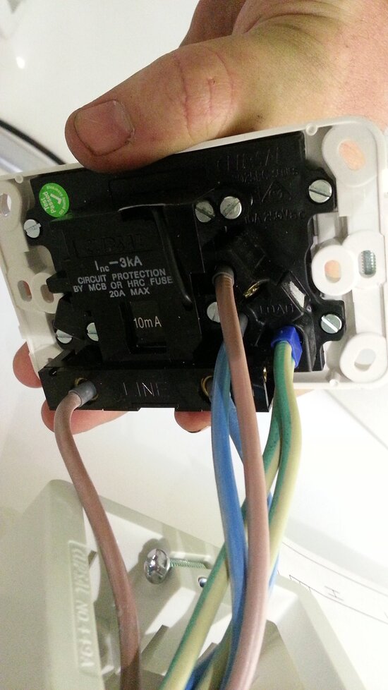

Had my first encounter with one of these today, wondering if any of the other trainees are familiar enough to guess it's identity from the back?

I'm guessing some kind of inline RCD/RCBO that operates at 10mA but you can plug in your own MCB or fuse on the front?
Either that or just an RCD socket front? i have no idea what your sockets look like down under!
i'd guess at a RCD connection unit, recommending that upstream ocpd is hrc fuse or mcb.

Got it in one, it's a 10mA RCD protected outlet for a mobile dentist van. Usually our RCDs are 30mA, but childcare and medical require 10mA.
Additionally, since 10mA RCDs are prone to nuisance tripping, we've used RCD sockets that have a line and load side so they can pass protection to the rest of the outlets down the circuit, while being accessible to reset.
