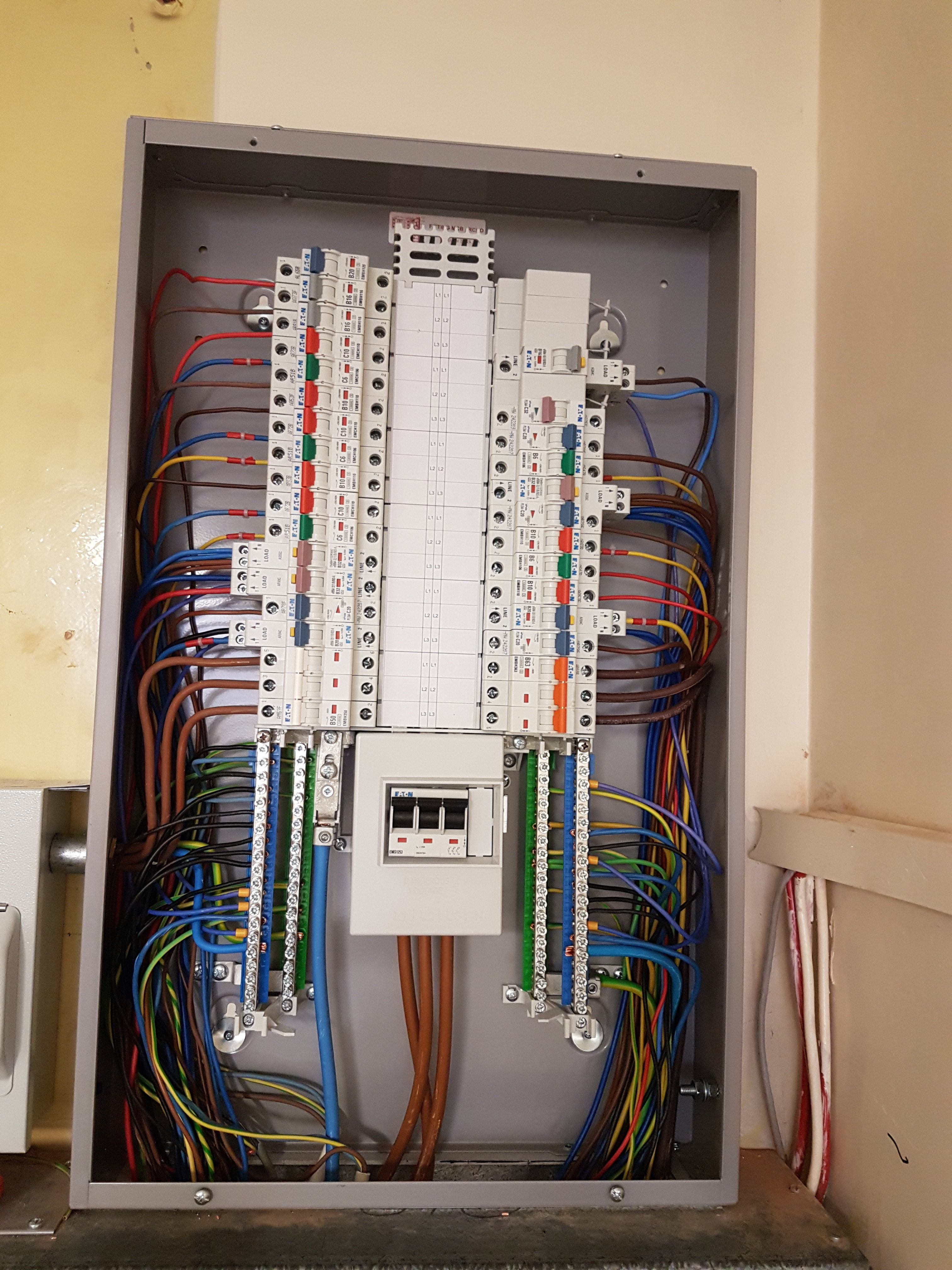

It is often said on here we criticise others work without having the conviction to show our own work. We have Dodgy Trade Pics For Your Enjoyment so let's show the other side. No job too small or to big, before or after let's see 'em. I can change the header if someone can think of a better one. I shall start the ball rolling with this considerable board change I did today:)

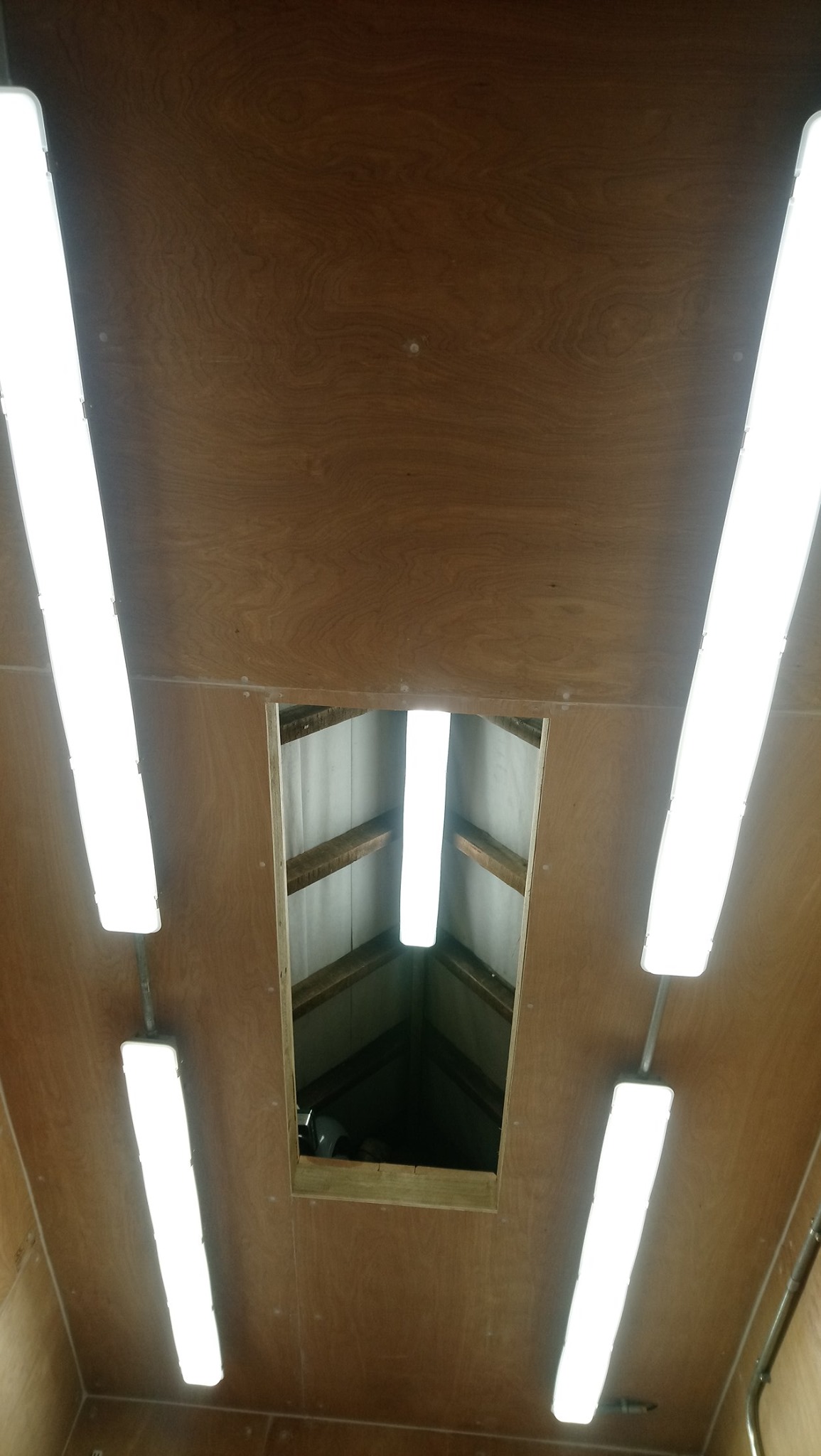

Did this for a good friend of mine, a carpenter, on a purely materials at cost basis. New (small) workshop, converted out-house. "I want it bright," he said. Took about a day and a half. Great fun. :)
Realised after I'd done first fix that I needed to put banjos on (to earth) the short 1 foot sections of conduit between the light fittings, which are plastic. No bother - at least I hadn't drawn the cables in at that point. :)

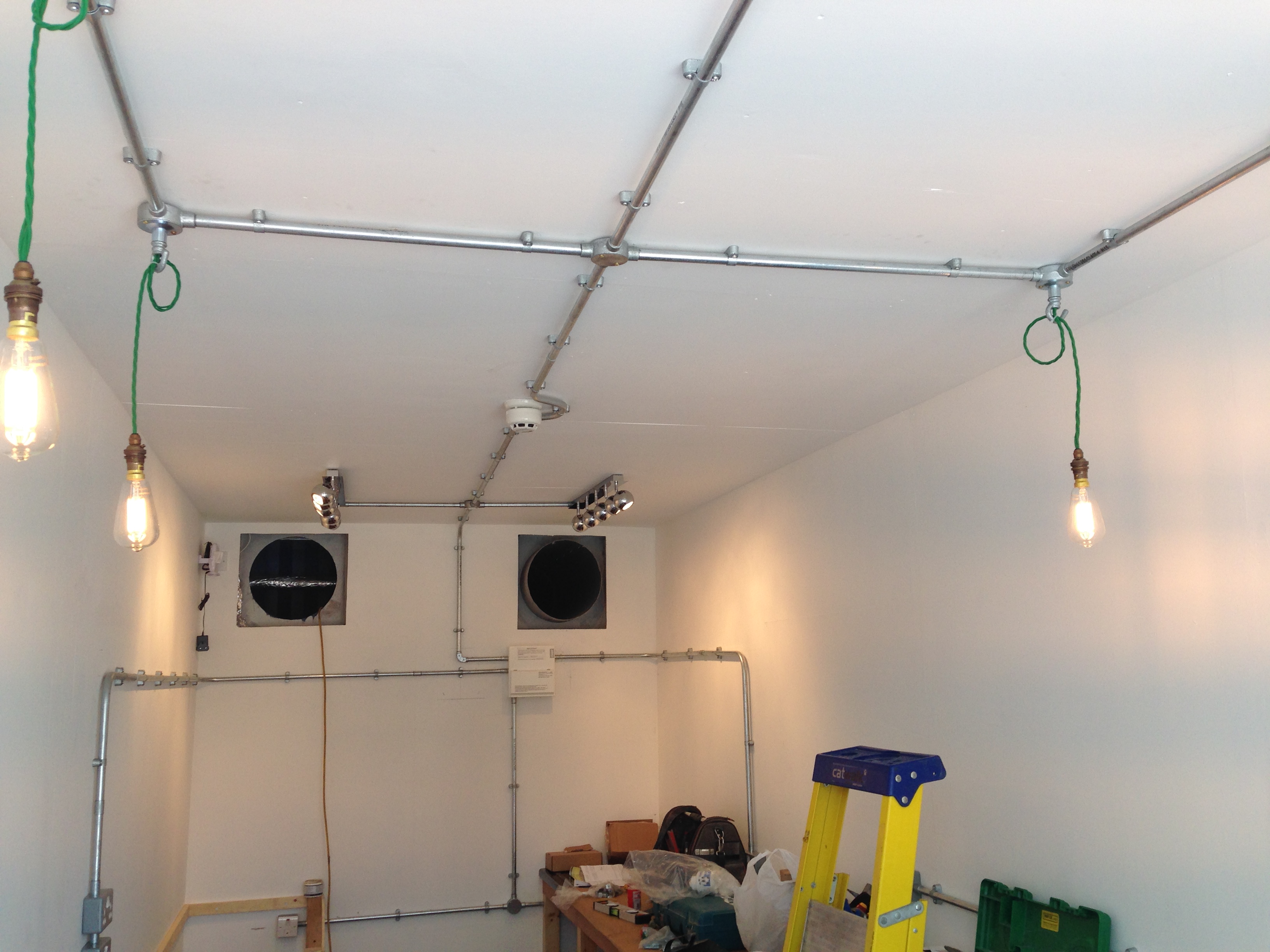

I take it they're loving the conduit theme
It is part of what they call Cargo a conglomeration of containers in Bristol docks and most of the units wanted this look for the industrial connotations. It did give me a wry smile when some younger sparks started in a three container concern in galv. and could not complete it as they just could not do it. i.e. they could not feed their wires due to using 90 degree bends and trying to pull too many wires in instead of bending all their corners, so they advised the client they would have to do it in plastic conduit instead.
It is part of what they call cargo a conglomeration of containers in Bristol docks and most of the units wanted this look for the industrial connotations. It did give me a wry smile when some younger sparks started in a three container concern in galv. and could not complete it as they just could not do it. i.e. they could not feed their wires due to using 90 degree bends and trying to pull too many wires in instead of bending all their corners, so they advised the client they would have to do it in plastic conduit instead.
Sigh. Bet it looked a pig's ear in plastic. Those younger sparks must have marvelled over your smoke detector bubble ;)

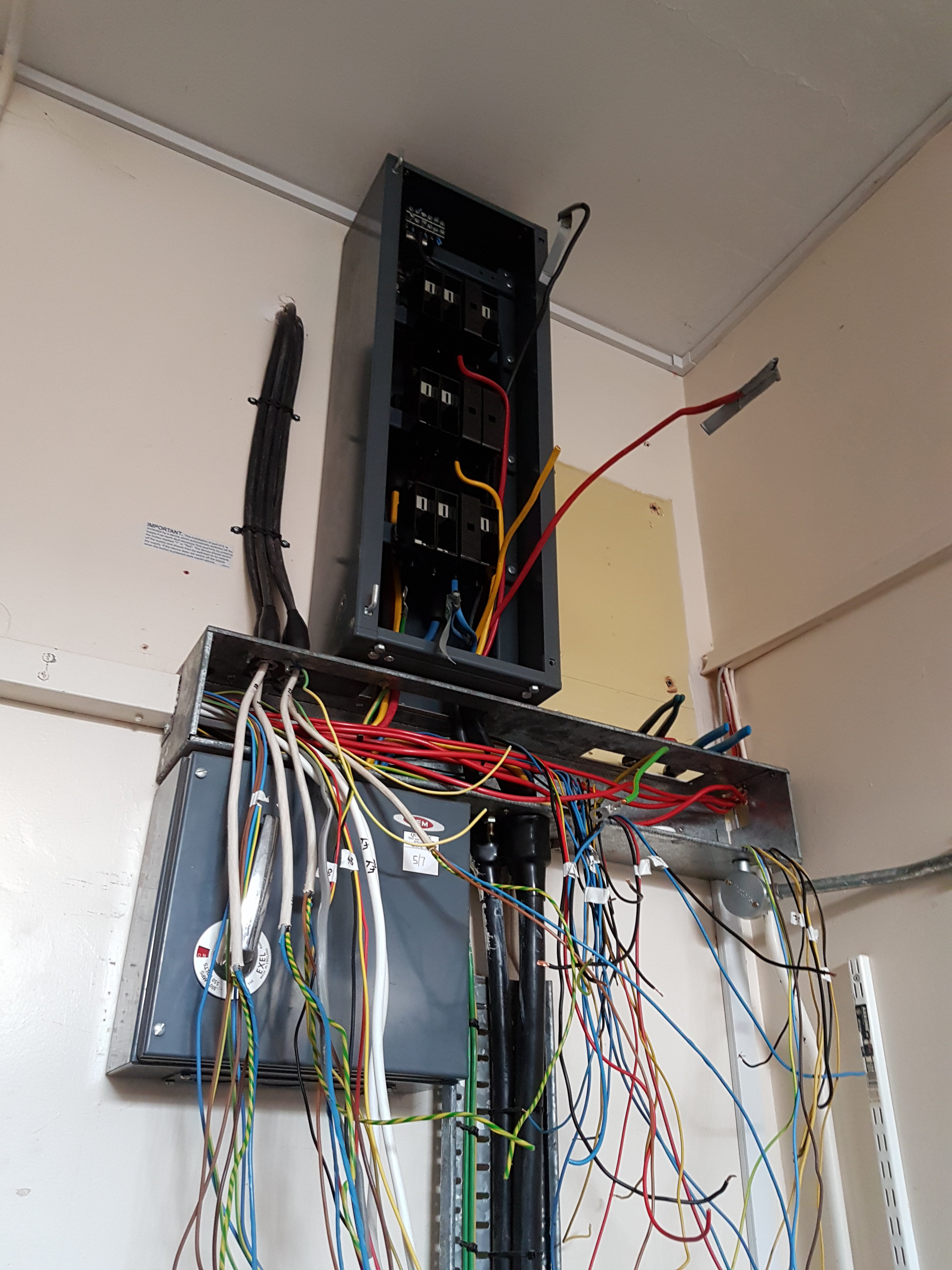

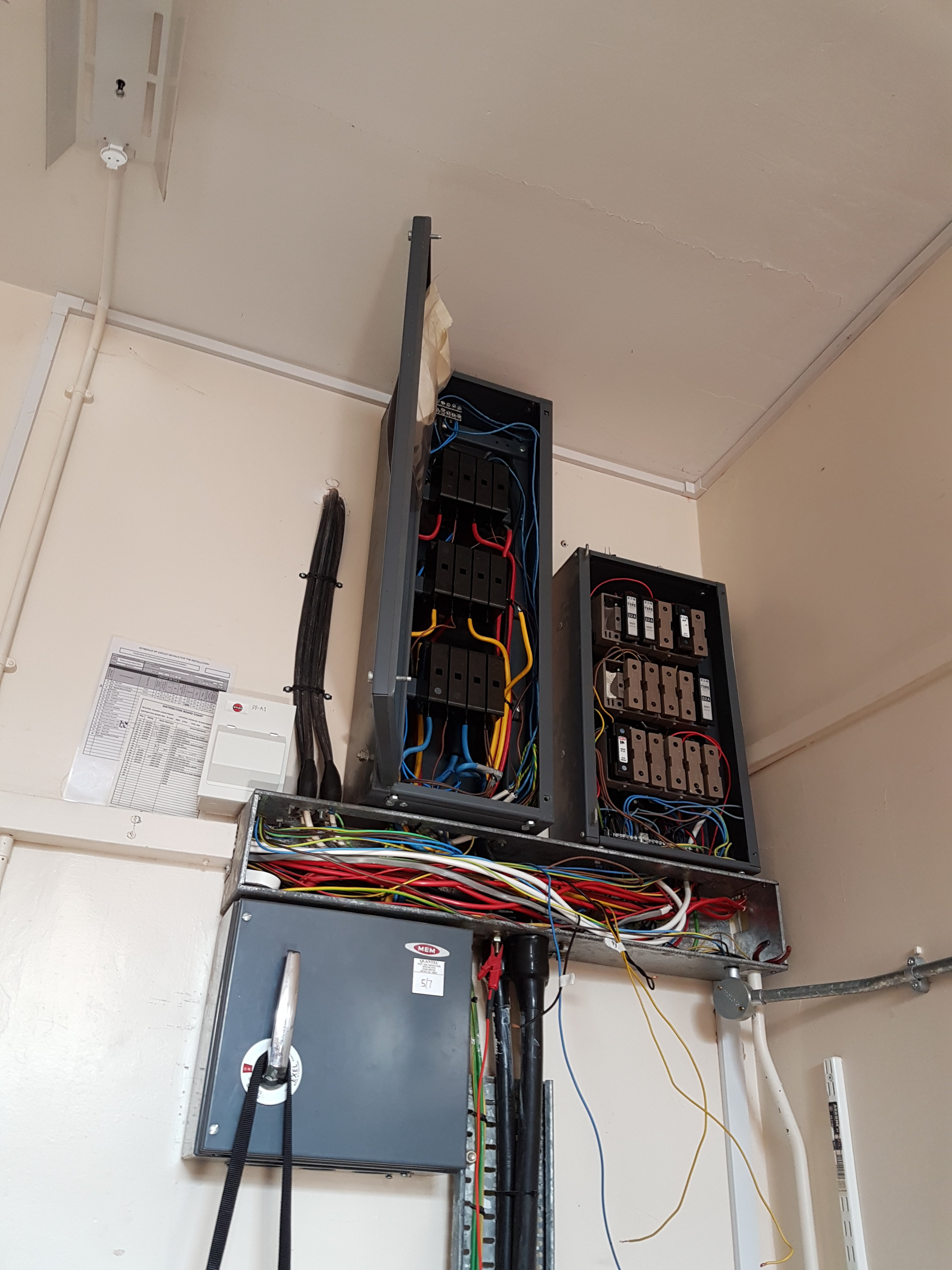

@westward10 how long did that take? That is a difficult job keeping track of all the wires and so on. Did something similar but not quite so tricky and was there from 7 a.m. until around 10 p.m. had no choice as it had to be back on by the morning. I suppose it was helped by the fact an EICR and remedials were done by us prior to starting the work.
Three days including solving some existing faults (we tested it a couple of months ago). Two unknown circuits also traced as all wiring was surface trunking/conduit so we dismantled a bit and found them. Was also 4m up to the top of the new board.
Ah I see. Same category as all those neutral bar covers that end up on the tops on DBs ? :rolleyes: :D
Funny you should say that. We had a pile of junk in the corridor as these weren't the only boards changed and I had fitted the cover, put the steps away, hoovered and swept up. Well you can guess what was on the corridor floor.
How long did it all take you?
Thanks for the compliment! Took four days if I remember correctly two guys on it. The designer of the whole complex was on the job watching us all (sparks) like a hawk! He started getting agitated with me as he thought I had put in 10mm² swa and I got out the micrometer and showed him different in two minutes. He did apologise, but the other sparks on site were looking sideways at me and him it was a bit of a laugh. With him and the site manager it was a pretty tight environment to work in!
As a side note could not believe how difficult it was to get TP&N SPDs, our wholesalers all drew a blank. Out of stock waiting list.......... Got some online in the end after much Googling and phone calls.
