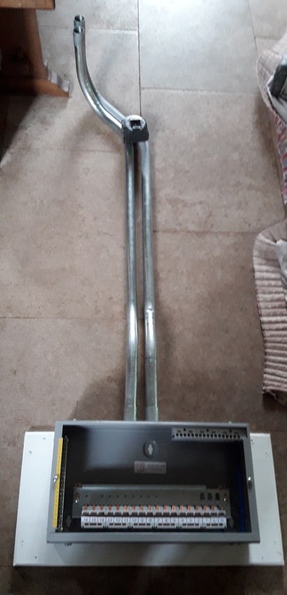

It is part of what they call cargo a conglomeration of containers in Bristol docks and most of the units wanted this look for the industrial connotations. It did give me a wry smile when some younger sparks started in a three container concern in galv. and could not complete it as they just could not do it. i.e. they could not feed their wires due to using 90 degree bends and trying to pull too many wires in instead of bending all their corners, so they advised the client they would have to do it in plastic conduit instead.
Sigh. Bet it looked a pig's ear in plastic. Those younger sparks must have marvelled over your smoke detector bubble ;)

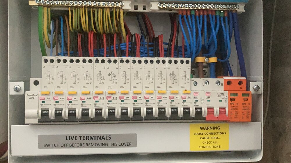

How long did it all take you?
Thanks for the compliment! Took four days if I remember correctly two guys on it. The designer of the whole complex was on the job watching us all (sparks) like a hawk! He started getting agitated with me as he thought I had put in 10mm² swa and I got out the micrometer and showed him different in two minutes. He did apologise, but the other sparks on site were looking sideways at me and him it was a bit of a laugh. With him and the site manager it was a pretty tight environment to work in!
As a side note could not believe how difficult it was to get TP&N SPDs, our wholesalers all drew a blank. Out of stock waiting list.......... Got some online in the end after much Googling and phone calls.

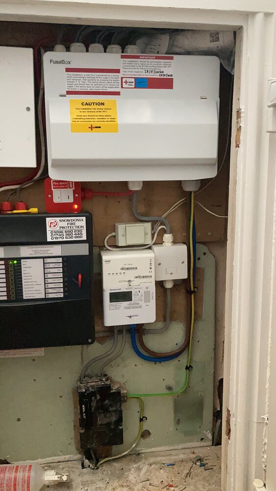

nice neat job, but those tails need cleating to the wall.
I did think about putting a loop of all round band on, maybe next time I'm there.
Reason I didn't is that the CU entry is through a tails compression gland, and the isolator also has a cable clamp inside. Once it gets full of junk under there though they could get dragged about.
