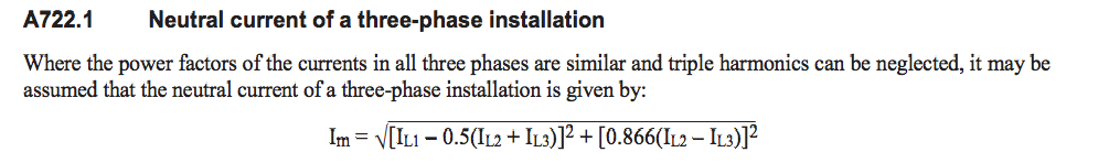

Had the 309 science and principles exam today at college and had a question on calculating the neutral current flow in a 3 phase 4 wire system with unbalanced loads. The formula is below, and definitely one to memorise.
N=√((A²+B²+C²)-((A×B)+(A×C)+(B×C)))
There's a much easier equation to use, see Annex A722.1 in Amendment 2.
The condition being that the phases are near enough 120 degs apart.
Screenshot 2014-06-22 22.49.17.png Cheers Archy:smile:
