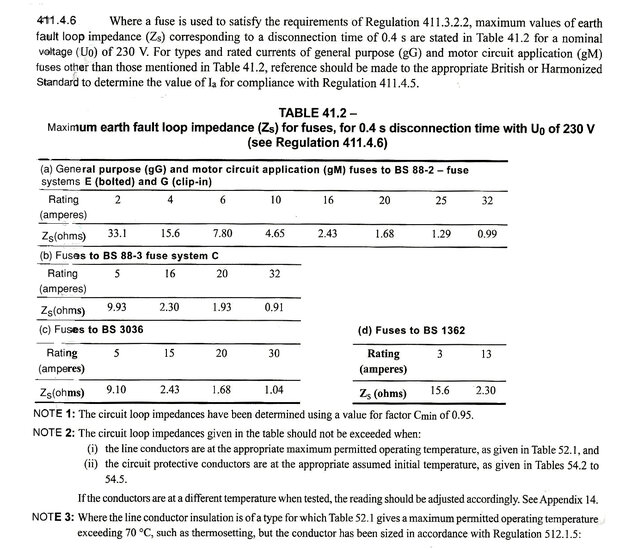

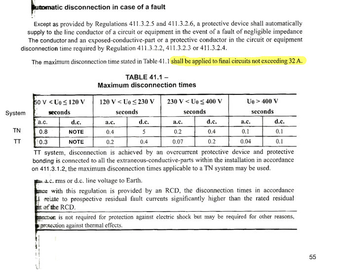

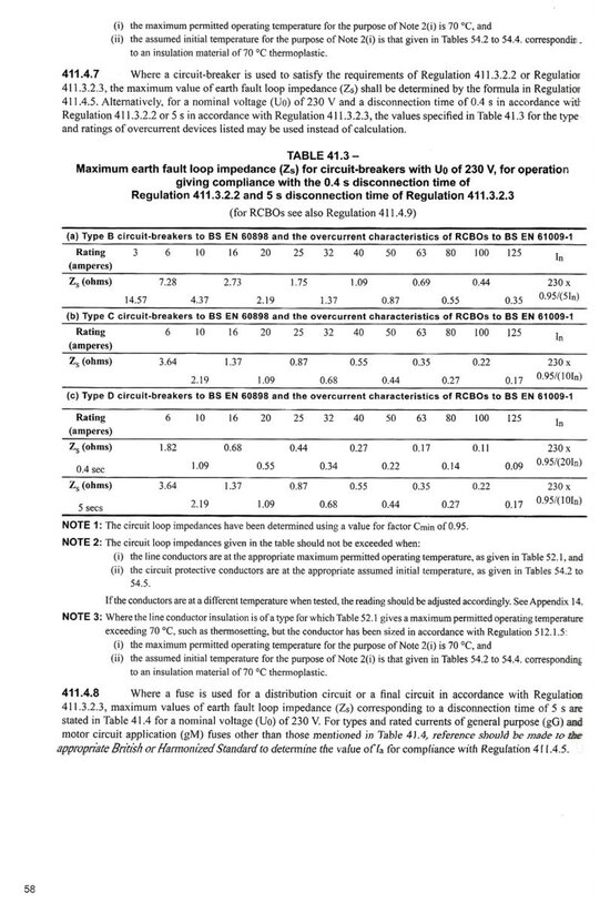

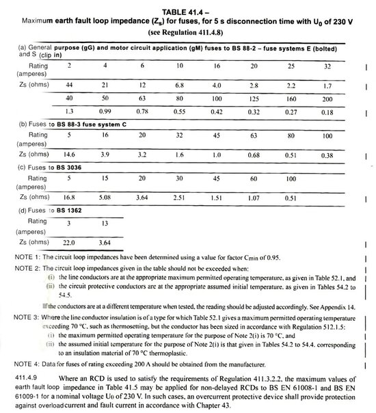

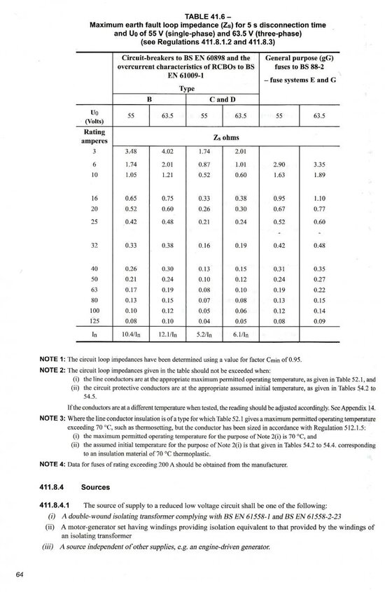

For reference these are the Zs tables from BS7671 Amendment 3, provided by Amberleaf.
I have cleaned up the scans a bit which is why they may look a bit odd round the edges.
Regulation Table(2) 41.1.jpgRegulation Table(2) 41.2.jpgRegulation Table(2) 41.3.jpg
