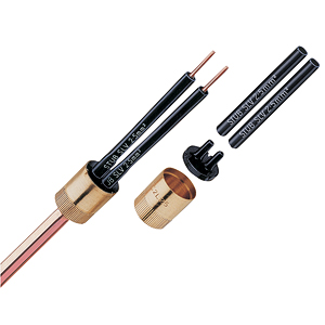

I was wondering if anybody has come across black stub slv? My mums church consumer unit is a nightmare. All of the connections are black stub slv, with half on them not marked as live. Thats ok for the ones that were already connected in the board. But in the board were some wires just connected loose in connector blocks! None of the circuits have an earth either. The main earth bond is there, i have just never come across a board that does not have a seperate earth with each circuit.

Not pyro, by any chance?
By black stub slv do you mean black stub sleeving i.e MICC cable conductor sleeve??
If so, the outer the outer sheathing of the MICC cable is the CPC and tbh, you wont find a lot better even after 30+ years.
What problems are you having??
Yes I've got loads of stub sleeve in the shed, along with all of the other parts of MICC terminations.
What you have there is a type of cable called MICC, it is the preferred cable type for church wiring. As for having no earth I very much doubt it, in fact I'd go so far as to say it most certainly does have an earth on every circuit!
Stub sleeve is exactly that, a sleeve, it is put over the bare conductors and the 'stubs' of the plastic seal of the termination.
I'm shocked that someone who is working in a church doesn't know what MICC is, what cable are you installing if not that?
Does it look like this?

Walk away if you have no experience of working with micc, it's easy once you know how but until then it is easy to make some expensive mistakes!
For a start the cable sheath forms the earth of the circuit which connects via a compression ring in the gland and onto the steel surface of the DB. You need to ensure a mechanically and electrically sound connection with the steel surface or find another way to earth the sheath, making a brass gland plate or using earthing nuts may work. Or reterminating them all with earth tail pots.
Also you may need to reterminate some of them which requires the correct tools and some experience. Plus knowing how far you can or cannot bend it without cracking the sheath if it's old.
And if it's imperial MICC you may well need to solder a new pot onto the cable or carefully shape the sheath with emery if you need to re-terminate. Not a job for the inexperienced!

Pyro is not for the uninitiated or the faint of heart Sonia. That said, you have an opportunity to gain a very worthwhile skill that will never leave you. You'll get rusty at it but it's like riding a bike, you never forget it.
Once you get used to it you'll learn to love the stuff. I, and most of the other dinosaurs on here, do. Watch, learn and soak it up. And see if you can get your hands on some scrap ends to practice on (NB the tools needed can be expensive)

the tools can be picked up for a reasonable price on ebay
the brands to look for with reguards to tooling are;
pyrotenax
bicc
joistripper is handy for the smaller stuff but a rotary stripper is needed for the bigger stuff (or snips and driver)
dont be tempted to snip itit either as you will struggle to screw the pot on
