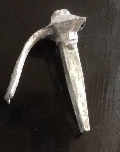

Do any of you old geezers out there remember ALEX plugs in the 70's. They were an aluminium rawlplug an always gave you a solid fixing - much better than the plastic ones. Perhaps they are the solution to this problem.
Yes I remember those, make that 60's and 70's.
When I started it was with the then GPO, (Electrical) they wouldn't allow anything else, certainly not those new fangled plastic things.
I can also remember using the Rawlplug fibre compound that you used to dampen and push into larger / oversized holes then screw into it. Used that at home before I started work and had access to Alex plugs.
I'm sure that must have had asbestos in it.
Just Googled , yes it was white asbestos, lovely I used to chew that to get it wet.
