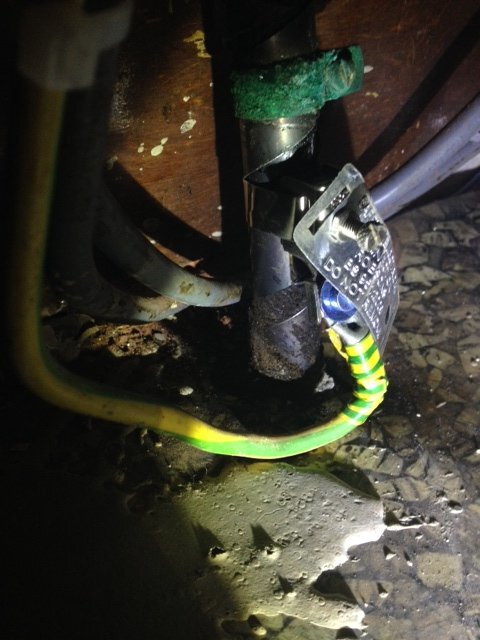

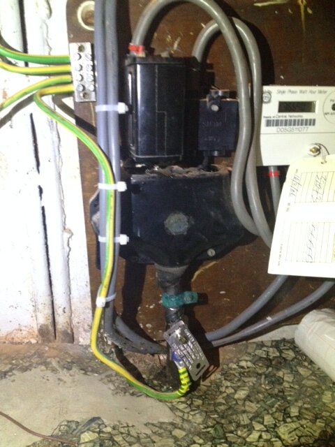

Hi, first post here and after some advice hopefully.
We had a new consumer unit fitted and some additional work, the electrician then tested circuits and got a high earth reading. I think the reading was something in the region of 1.05 and it should be 0.8, he said it was an issue with the earth coming into the house because the reading was high on all the sockets etc.
Apparently we have a TN-S and we should contact the supplier to get this rectified, all good and we called Western Power, they came out that day but the chap was quite dismissive upon seeing the unit and said that isn’t a proper earth which is why the reading would have been outside of the expected range. He also made reference to the bonding saying that an electrician had done that. He could arrange for someone to come out but it would cost us, he quoted something in the region of £130, further to this he didn’t even bother to take a reading!
The chap from Western Power said that the sheath (?) would need to be replaced – so surely this is their responsibility and they would need to repair or replace?
Our electrician made it clear to us from the beginning that anything before the meter is the responsibility of the power supplier, and he cannot touch it.
I am just a bit confused as we were told we shouldn’t be charged, and it seems like Western Power are actually going to be replacing something that isn’t doing it’s job properly – it is an earth?
I am at work at the moment so can’t post a picture but will do later, I would just like someone else’s opinion before we follow this up with Western Power, and then maybe further it they are still adamant that we should pay. Yes we could get a spike put in but I just feel we are being fobbed off by the engineer who came out and it's not right.

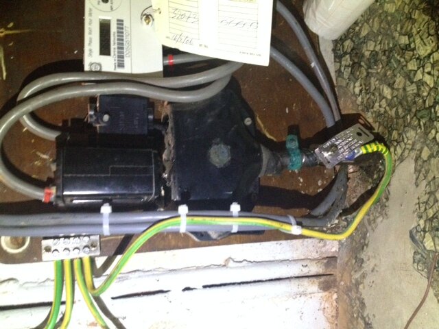

That doesnt look like any tn-s connection I have ever seen. Does look like an after thought. But do not quote me on this, wait for someone more time served than me
It looks to me like a DIY TN-S. That earth clamp does not look like the ones a DNO would use. It looks more like a 951 clamp that you would use for equipotential bonding.
If the DNO have said it's nothing to do with them I'd be looking at quotes to get it installed (expensive) and comparing them with an electricians quote to install a system of rods to make it a proper TT system as it appears to have been originally.
But what's with the "greenish" clamp above - seen loads of those around with the main earth connected with perfectly reasonable Ze's.
Tin hat on!
Also what DID the EIC the sparky gave you say about the reading etc??

Current reading is 1.05 (I think), holding off on the EIC (certificate I'm guessing?) until the earth is sorted. If not then it will be issued with that higher value.
We have been quoted £130 by the power company for them to do the work.
