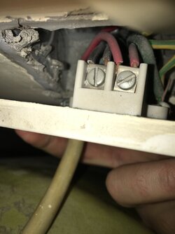

I have a plain old switch attached and wanted to install a new WiFi-enabled switch or, failing that, a timer switch.

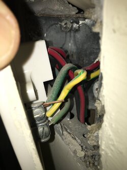

I've just opened up the switch and there's 7 wires! Most of these switches seem to have 3 connections, so i'm a bit lost as to what i'm going to do.
It seems that one set of wires is running upwards and powering the Hive heating so my assumption is they can be grouped together in 3 sets ?
There are :
2 green and 1 green and yellow wires
2 red
2 black
As you can see below, the 2 red and 2 black seem to be going into the same connection.
Any advice would be greatly appreciated.
You have a double pole isolation switch for your immersion, the L and N coming in at the top and as you suggest going off somewhere else, and hopefully an earth wire with each of those. Then at the bottom of the switch the L and N of the flex to the immersion, and the associated earth wire.
The switch is double pole for safety, so power can be switched off completely locally. These days a fused double pole switch (FCU) would be used.

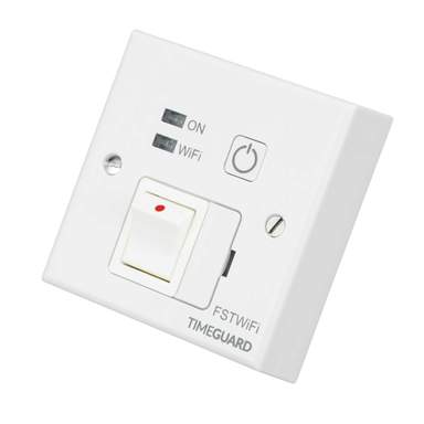

The wifi controller you are suggesting has only a single pole switch if it only has three terminals. So if you want to use one of those you should leave a switch in place (preferably replacing the existing with a fused version - FCU), and connect the output of that to your new controller, and then to the immersion.
Alternatively if you want to have a wifi unit in the place of the switch you have, I suggest choosing a double pole fused wifi FCU type, made for the purpose, eg:
Admittedly the apps for the above are perhaps not so slick, but they do work
Sorry to be direct, but given the age of the cables and that switch, your uncertainty about the wiring, and the relevant regulations with which you may not be very familiar, you should seriously consider using an electrician to make the change.
