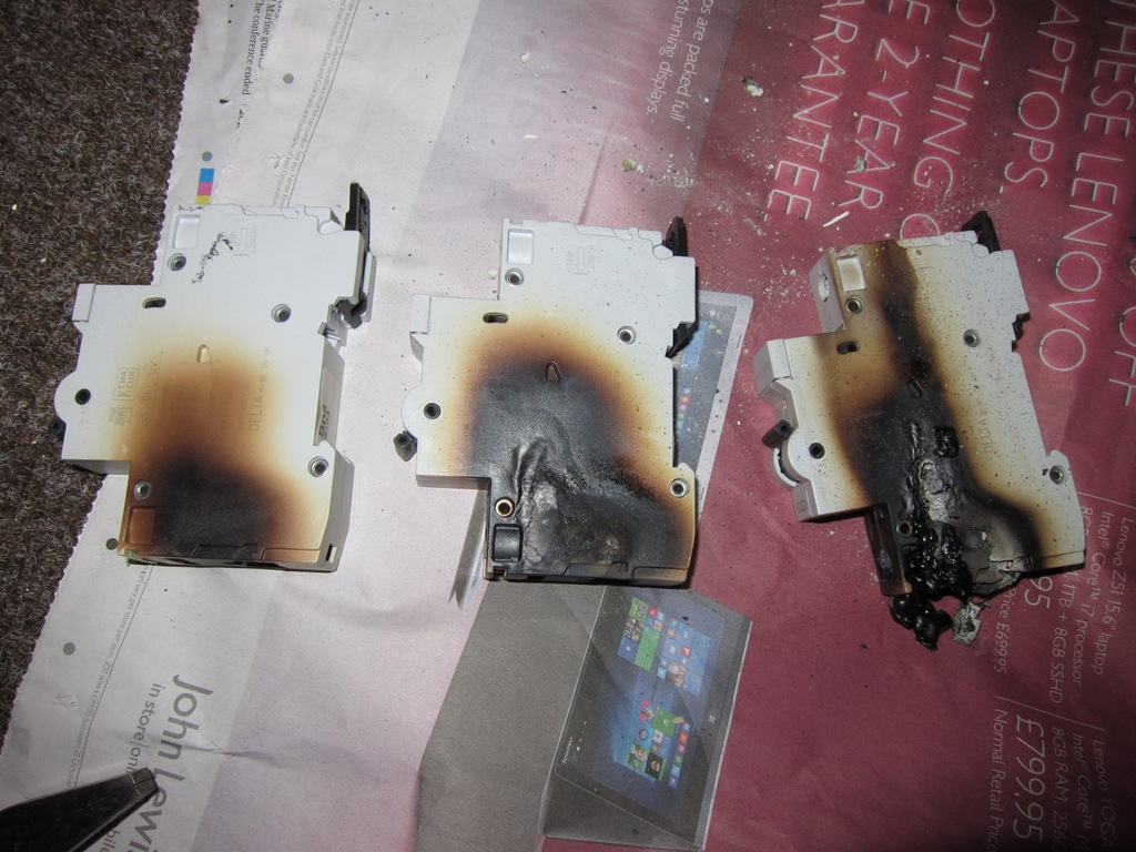

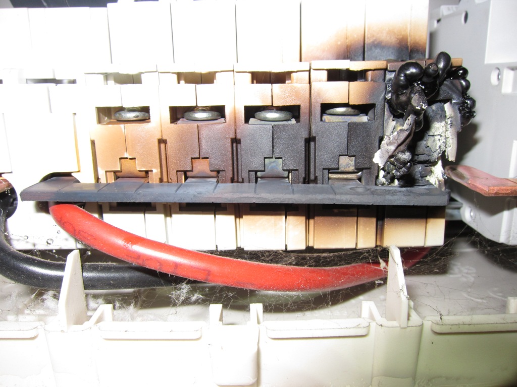

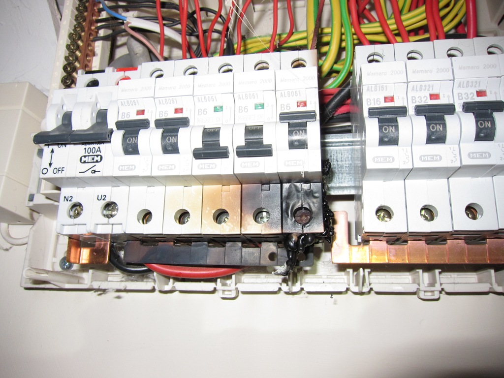

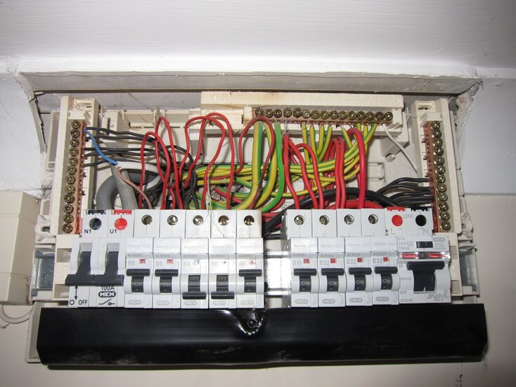

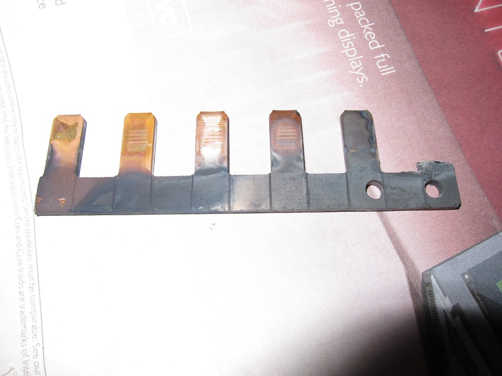

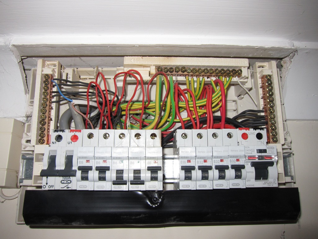

This was a recent weekend callout. House is about 15 years old, with no significant modifications, so I recon the busbar was installed like this from new.
Note that this is not high current stuff. All the breakers on the affected busbar are 6A. Two alarms and three lighting circuits. Quite surprised at how the busbar has been eroded away. Somewhat amazed that the occupants had only recently noticed anything wrong.

Great photos handysparks. Just shows what can happen even as you say at low currents. Daz

I had the same with that board and breakers a few months ago in a shop I was doing work in, the busbar was down to the same as in your pic!
I bet there's hundreds still out there that haven't been recalled. Thousands even. Daz

Probably hard to tell but the missing bit of the busbar will have been firmly 'welded' to the clamp on that last MCB. But nice but of damage there. I have had similiar that affected two breakers and to a lesser degree, client wanted me to leave them energised instead of replacing them. Talked them round by saying it's not like scraping the burnt bits of your toast off and then it's fine!

Picture 3 of Handysparks post shows the fortuitous contact when it is not fitted properly.
