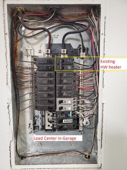

Hi folks.
I'm asking so that I can do some planning, and then hire a local electrician to do the work.
WHAT: This is my first question, ever, on this forum. I've joined so that I can understand better what I have in my home so that I do not run the risk of putting too great a load on my system.
I want to understand how many Amps my in-garage Load Center has going to it. (Please forgive me if my use of terminology may not be correct, as I am a DIY'er.)
WHY: My new On-Demand hot water heater (29Kw Atmore) requires 3 @ 40A DP 240v breakers. And... if I don't provide enough power these things tend to have the lights pulse when they are heating up their elements.
Here goes:
The home in the FL panhandle has 200A 240V service coming to it. I have verified that by looking up the permits for this property.
The meter on the outside of the home has a breaker panel built into it. In that panel are installed three DP breakers: one very small, one powering my Heat Pump, one for my load center (the only load center for the home)
The wires going to my load center are from the double-pole 90 amp breaker. There are some heavy duty aluminum wires (3) that are involved: One to one leg of the 90 amp breaker, one to the other leg of the 90 amp breaker, and one to ground.
The size of the wire, color and striping is the same that supplies power to the load center in the garage. That load center has the breakers for the home in it.
In the configuration as expected (line, line, ground) I have the wires coming to the load center. One line to one side of the GE load center, one line to the other, the third grounded.
So finally, my question:
Do I have 200 Amp service coming to the house with 90 Amps at the load center... or do I have 200 Amps coming to the house with 180 Amps in the load center?
Thanks.
