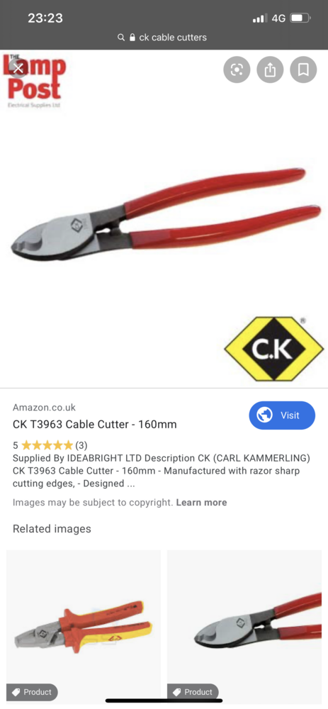

I would use a pair of CK cable cutters, these are what I have used for over 20 years.

I would use a pair of CK cable cutters, these are what I have used for over 20 years. View attachment 55287
Are yes, my preferred cutters, and with a bit of practice very good at stripping. I hardly ever use ordinary side cutters (outside of light current work for which I have a small pair) - it just hurts my hands and sometimes my joints will swell up if I'm not careful.
But the shear action on those goes (with a little effort) through 16mm T&E, 25mm singles, and ... 6mm and 8mm copper pipe. On smaller stuff, like a hot knife through butter and I have to wonder why anyone would use side cutters that (in comparison) need so much force to do the same job.
Doing network cabling, they are the only tool I normally use for stripping. Sometimes I use a variation on the CK automatic strippers previously mentioned, but on network cables they often damage the insulation on the cores.
Oh yes, and for cable with "hard" insulation, the shears strip with ease where everything else fails.
