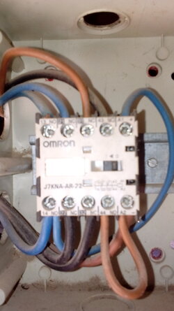

I have a Omron Transfer switch but not a clue how to wire it . It is in situ at the moment with wires attached however all the wires have now been cut off . When they were connected they supplied a house from either an Inverter or a Generator . Normally for most of the time the house is fed from a batter bank through an Inverter with 220 volts output which went to the Transfer switch then on to supply the house . If the weather is bad and a generator is used it plugs into a cable that goes t the transfer switch which then disconnects the Inverter and connects the Generator to the house . When the generator is turned off the reverse happens, the transfer switch re connects the Inverter to the house .
If possible would someone explain in simple terms which of the connection's i need to connect which cables to in order to have everything functioning again .
Many thanks

Hi - looking at the spec sheets, this device is a contactor. It has 4 double pole switches, 2 normally open and 2 normally closed. It’s rated at 10A. Perhaps it forms part of an Automatic Transfer Switch, as it can’t perform all the ATS functions by itself. So for me, I think its best to get ‘on site’ expert assistance to recommission your ATS.
Thank you Wilko but im confused now , it has been working as an automatic transfer switch for the last 10 years . Once a generator is started it automatically disconnects the power coming into it from the Inverter and connects the power coming into it from the generator . Once the generator is switched off the reverse happens and in the house continues to receive interrupted power , the change over is so fast its very rare tha anything will be effected , occasionally the Internet Router has to be rebooted or the TV goes into standby but thats a very rare occurrence . The Inverter is 1500 watts and the generator 1000 watts so the power consumption i the house is low .
I agree with @Wilko
it is not an automatic transfer switch, it is a contactor (big relay)

what you have there is a poorly designed changeover system, although it seems to work or at least has at some point in the past, it is entirely possible under some conditions to do one of the following.
damage the generator by back feeding power from the inverter.
damage the inverter by back feeding from the generator
injure or kill someone working on either part of the system by energising something expected to be dead.
this is what I have to switch between grid supply and backup generator, it deals with safe switching, auto starting of generator, warm up and cool down delays etc.
Agree with James. It is just a 10A-rated contactor wired as 2-pole changeover which in theory will act as a transfer switch and I don't doubt that it has been working. But it is not the proper tool for the job due to the shock risk or damage that might occur if it malfunctions or the contacts flash over.

Timbo , the answer to your question is the switch was in a building that also housed the generator but has now been demolished , the generator and switch were to be situated somewhere more convenient and much closer to the inverter and other equipment . Looking back i found out that the switch was installed closer to 15 years ago and i was the one to do it . I took the switch out of a friends house when he did away with all his solar equipment and recall having a simple wiring diagram with every connection number and the internal circuit shown shown so was a simple process of working out each connection . Now i feel rather stupid because i expected to go online again and find the same diagram when the time came , unfortunately i haven't been able to find it .
The switch was fitted by a self taught solar engineer to my friends house for the exact purpose i have been using it , i wouldn't be surprised if he has installed upwards of 100 between the early 2002 and 2018 as this part of Spain is very rural and without infrastructure cover outside the towns .
On the plus side i have taken note of everything explained in the advice posts and decided not to use the switch again but to return to the method i previously used before installing this switch which was a simple 3 position heavy duty 3 position manual switch . Center position was off , left connects one circuit , right another circuit , that way its not possible to connect one circuit without first disconnecting the other so only one circuit can be live at a time , the switch will be next to the generator so no hardship .
