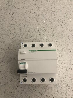

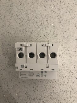

Hi there thank-you for taking the time to read this! I have a 300mA Rcd in a grain shed on a farm now every time I try reset it won’t stay on there are 3 phases that go into the main switch
And it isolates all 3 bar the neutral so when wen everything is turned off mcb rcbo in the board it still trips iam guessing this is through the neutral if I could some how isolate the neutral and then hopefully it would stay up then turn one on at a time thoughts on fault finding ?

Have you any pictures?
Main switch is for the whole installation now I have sub boards off this running icleast 20 meters then 4 led strip lights also part of the old lights are wired to in armour nightmare

Have you a picture of it installed?
