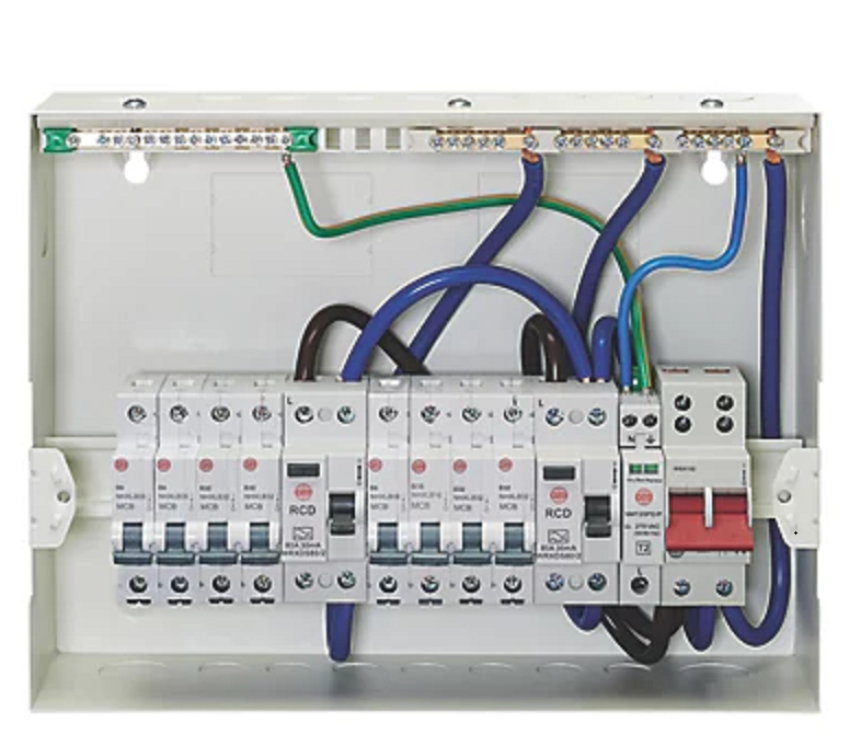

I like the Fusebox boards and would fit them if I got to choose, my mate reckons the newest Chint board he fitted the other week was the best he's used in a while, plenty of space and all the MCB's line up perfectly. As for the din rail in
Thanks for that suggestion.

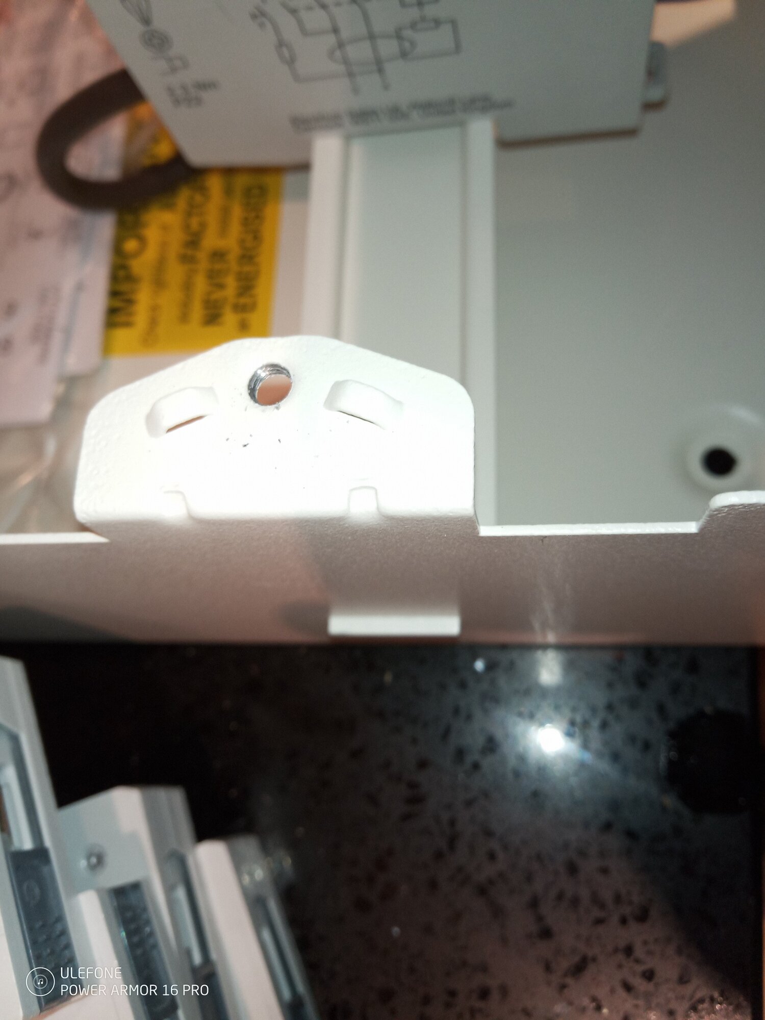

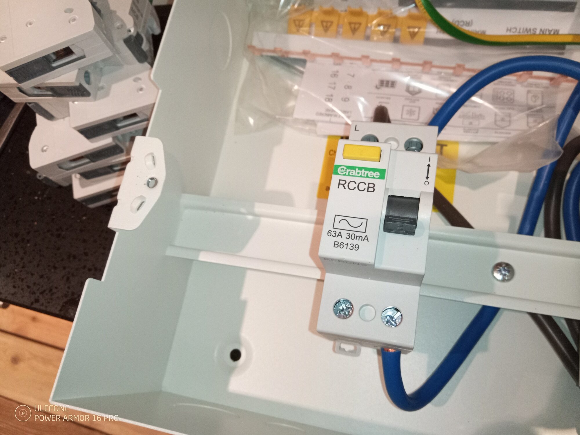

the new Wylex boards, they are riveted in and there is now way of removing them. Its a pain in the arse if you are fitting a dual RCD on as you have to remove all the tails to get them out of the way instead of removing them all in one go. Here is what I mean about the din rail. (Crabtree and Wylex are the same with this model)
OK that is not what I have used, here is the NHSPN00111L recently done:
And from a year or two back the NM606FLEXS (suspect that part is changed as now single-module SPD):
Unless they've changed in the last few months, DIN rail in Starbreaker boards is still removed with two screws.

I like the Fusebox boards and would fit them if I got to choose, my mate reckons the newest Chint board he fitted the other week was the best he's used in a while, plenty of space and all the MCB's line up perfectly. As for the din rail in the new Wylex boards, they are riveted in and there is now way of removing them. Its a pain in the arse if you are fitting a dual RCD on as you have to remove all the tails to get them out of the way instead of removing them all in one go. Here is what I mean about the din rail. (Crabtree and Wylex are the same with this model)
You probably could get it out if you bent the case enough but its not designed to be removed really.
O/T but I'm stuck with that board now, I was in a rush and the spec said Crabtree board so I found a Toolstation that had one in stock and bought it, it wan't until I was halfway through fitting it that I realised it had AC RCD's in it, I wasn't even aware they still sold that version. There was no way I was uninstalling it all and a new type A board was the same price as separate RCD's so I just got one of them, swapped the RCD's over and carried on. But now I'm stuck with something I cant take back as all the model labels and box are wrong. What can I do with it.
Didn't see this yesterday - seems to have been posted while I'd been replying to the previous comment.
Not sure why they'd design a fixed din rail and it seems a bit daft. Hope they don't go that route with Starbreaker, although it would be difficult to assemble as it would get in the way of the plug in busbar. The board in your images doesn't even appear to be that recent - even Screwfix have been advertising Crabtree stuff with Type A RCDs for at least two years.

It was a few months ago, it was related to a post I put up about a different make SPD in a consumer unit if you remember it, where the council official wouldn't accept it. I also assumed it was a board with type A's in as Toolstation definitely sold them at the time but they must also have been selling the older stuff off as clearance or whatever. Because I was in a rush I just wrote the number down of a 10 way board and purchased it without looking too closely at it, it wasn't until after I had done the knockouts and mounted it that a realised they we AC. I simply popped back into TS and purchased a dual type A board as well and just swapped the RCD's over. I couldn't even take it back as I'd ripped the first box up to write my readings down on it.
I could have just boxed it all up, said nowt and returned it as not wanted but then some other poor sap would have bought it as type A board and ended up with AC RCD's. So I thought there must be somewhere I can use it up but its still sat in my cupboard.
