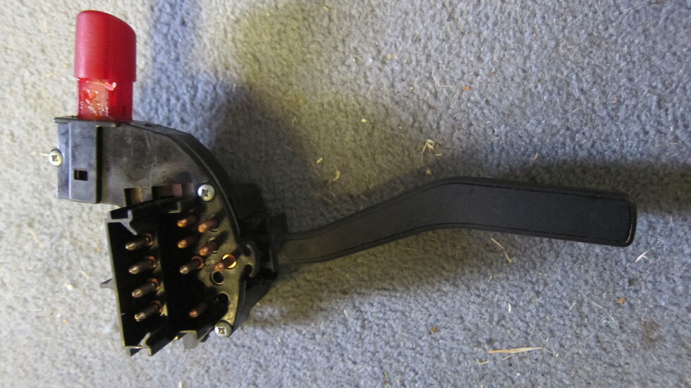

I am trying to help an elderly friend get his motor (Ford Sierra Mk III 1992 2.0i auto), which has been out of use but garaged for a couple of years, ready for an MOT. One thing that is proving to be problematic is the indicator stalk which has failed completely on the LH and only flashes for three or four times on the RH. We sought a replacement item off the interweb but though it fits perfectly it operates slightly differently - our stalk also provides headlamp flash when pulled and switches headlamps on when pushed whereas the replacement only controls the indicators. It looks as if obtaining an exact replacement stalk is going to be problematic so I was considering whether the existing item could be properly repaired. Is this something that an auto electrician could do? Or perhaps a computer technician who deals with PCBs and uses solder etc? Perhaps the idea of the latter gives some the heebie-jeebies.
In the photo you can see the 3 screws. Is it worth removing these for further inspection (not that my friend could do much himself)? By the way we are over 100 miles apart so I do not have direct access to the vehicle. He is in Lowestoft.

If you cannot get the correct switch it is an easy fix by intercepting the indicator switch wiring and fitting One of these
.http://www.demon-tweeks.co.uk/Produ...ign=Switches&gclid=CLP_h_f4zc8CFcWVGwodd4wJoA
This does require a bit of basic knowledge , but should be a piece of cake to a local garage.#

It could be that corrosion around the terminals at the extremities have failed or corrosion in connector blocks.
Taking a live to the out side of both stalk terminals in turn will prove the circuits if the lamps light up.
Have you tried the hazard warning lights , these should work irrespective of the stalk , and save you the bother of the last test.

Something you could try, is to squirt WD40 into the insides of the mechanism, then operate the stalk back and forth a few times.
These usually have some grease inside.
It may be, that the grease has hardened preventing good contact.

There may be no power to the stalk, Ford fuse boxes went through a spell where they were badly affected by corrosion , and the inline connector blocks were not great either .
When a stalk is U/S it usually feels indecisive to sloppy. The hardened grease might be a good call , as there looks to be an abundance of grease around the hazard switch. Check for a live at the switch , and if you have one , bridge it across to the out sides of the stalk to bypass the switch , if the flashers work it will prove the switch does not. Going of what you have said the flasher unit was working . I cannot remember if the Sierra had one or two units. Some cars did not have combined hazard/flasher units.
As spin has said , it could be solid grease . If the degreaser does not work try gentle heat with a hair drier , not a paint stripper gun. also wait until the propellants have evaporated because they are highly flammable now.
