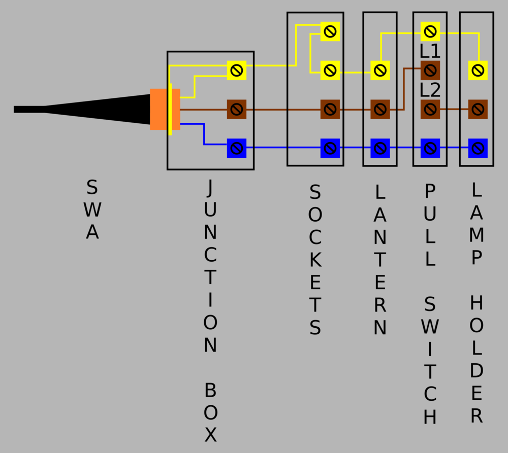

OK, so all the local electricians seem to be unavailable at the moment due to the COVID-19 thing.
While I wait, I thought I would see if I could work it out myself, just for something to do while I am waiting and to learn something new. Also, I will know how the job should be done properly when I get somebody to do it.
The sockets and junction boxes are now metal ones. There is also no fuse for the lamp which I think it would need.
So, if anyone is interested in teaching me, would this work?
Thanks, Nick.
you are nearly there ,but one thing missing is a good spark to sort it out .
Reactions: richy3333
Most here would advise you to get a professional in as learning the hard way can be very hard...
You really ought to have a separate fuse or MCB for the supply to the lights and the lantern.
Also I presume that lantern is a PIR sort so you did not plan to switch it? I would advise a local switch so you can independently turn it off/on for testing or replacing the lamp.
You could use a pair of FCU (switched fused spur, etc) to feed them to achieve that, but please not a 13A fuse! 3A should be fine.
Also don't go wiring it in to your consumer unit, if you really must try something out then put a 13A plug on a length of flexible cable and join that to the SWA at the sending end. Leave that part to when things are closer to normal and you can get someone in.

OK, that's all good to know - I'm not planning to actually do anything practical, just draw up a diagram of how it should all go together so that I can understand things. There is only so much housework you can do a day without it getting tedious.
Even if I can do this in the evenings then its something to sort of look forward to!
Thanks again for helping and I will get another diagram drawn up after I have had a careful read through of your instructions to make sure that I understand things in a practical sense.

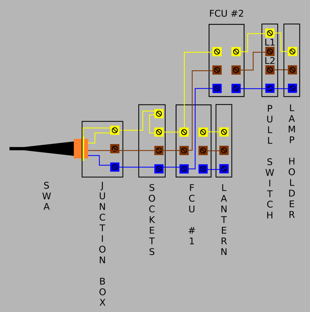

OK, so it would use two FCUs, one for the lantern and the other for the light and the latter would replace the pull switch? Or, I suppose one switched FCU for the lantern and one unswitched FCU for the light with the pull cord, but seems easier to me to just replace the pull cord with the switched FCU?
Ta,
Nick.
If you need to operate the light with any risk of wet hands then you should retain the pull-chord switch. Then use either an unswitched FCU or (probably easier) have a 2nd switched one that you don't rely on for the functional switching. They can be placed somewhere out of common reach so they are used only for maintenance.
Reactions: nick00
Excellent ideas there, thanks. I doubt very much that anybody will be using the switch with wet hands, but at the end of the day this is an outside shed, so it could happen. Better safe than sorry, I say - so I will be keeping the pull switch as you suggest and using the FCUs for fusing down and maintenance.

That is the basic idea, assuming the two earth's of the FCU are connected ;)
Yes, of course - so the supply and load earths in the FCUs should be linked together, yes? Bit of a schoolboy error there and I thought I was doing quite well! :rolleyes:
They will be as long as you use the correct terminals! Your diagram did not show that, though normally it would simply be assumed that whoever wired it up would have sufficient knowledge to do it right, and there is no need to link them as they are on a common strip of metal.
Generally FCU (and similar) will have two sets of earth terminals as the incoming power is connected to 3 terminals 'permanently' from the main wiring (i.e. L, N & E), and the other 3 are for connection of the load. You should not have to disturb the 'fixed wiring' to make that change as it would invalidate the test certificate, etc, if it were modified by removing and reconnecting part of it.
Originally 13A sockets would generally only have one set of terminals (i.e. 1 each L, N and E) as even when wired as an intermediate part of a ring (or multiple-outlet spur) there was no need for a 2nd as each terminal could take two wires.
More recently though you will find 13A sockets typically have 2 earth but still only 1 each L & N. This is for "high integrity earthing" on a ring, etc, where the pair of earth wires (going in and out) are separately terminated. The idea behind this is not to have a single point of failure for the earth in the event of a loose screw, etc, and it is really aimed at offices, server rooms, etc, with a large amount of leaky electronic equipment where an open earth has an immediate risk due to the sum of all currents being significant even outside of a fault situation.
Ah, yes, I was thinking that after posting but I have no experience with FCUs and its difficult to tell by looking at images on the web. With a bit of time after posting, I realised that they would be joined together.
So, all the diagram needs to make it right is to have one of the earth terminals connect the to the back box then?

The main oddity of the diagram is in some cases you identify terminals (e.g. L1, L2) but in other not. Though I guess you are using the colour to indicate function (with yellow for earth)?
If you have metal accessories such as back boxes then you ought to have them connected to the earth. Although plastic boxes often have an earth screw as a junction point if needed, the box does not require earthing as they are insulated.
Some installations only conenct earth to the fitting (socket, switch, etc) and rely on the fixing screws to earth any metal back box but that is generally not considered good practice.
Yes, I have generally used the terminals that are available on the parts, but I have not always indicated earth points on back boxes, I don't think. Let me redraw later for you.

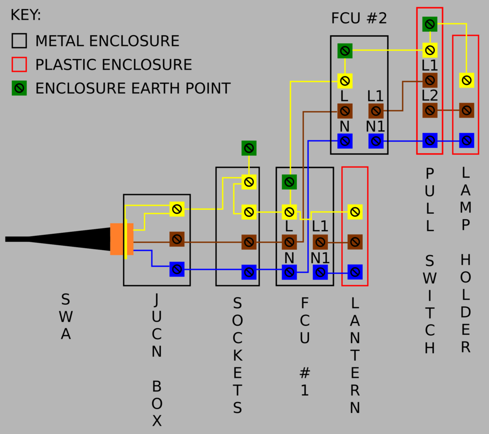

Okay, so here is hopefully the last instalment and I think that with all of your help, I finally understand things now.
I have the detail now for the FCUs, they are 5 terminal, 2 X L & 2 X N for supply and load, then one for E.
The earth terminals on the boxes are now made clear, in green, and I have added a key for clarity. You will also see that the boxes/enclosures are now colour coded too to show metal (black) and plastic (red). I have earthed the plastic pull switch box, too. I know it doesn't need it but I thought I'd do it anyway.
Thanks again for all of your patience!
Nick.
That should be fine!
There are many ways to do any one job but given the stuff you already have and the scale of it that is probably the most cost effective. If doing more circuits, or starting from scratch, it might have been worth looking at an unpopulated "garage consumer unit" to put in some MCB (instead of the FCU) for switching and current limiting, as well as being a point for terminating the SWA cable and an area for joining cables, but the FCU have the advantage of isolating both L & N which is better if you are working on something.

Ah, thanks so much. I really can't express how helpful you have been.
All I need to do now is wait until I can get a professional in to do the job but you have given me a thorough understanding of what is needed with the parts I have.
Its been good to learn something new. I had an idea but there were grey areas and this exchange has made me do a bit of reading up and a bit more listening to you to fill those grey areas in.

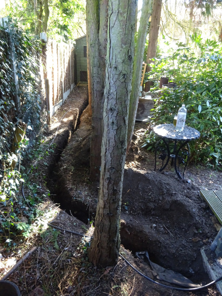

Pop the swa in some twinwall ducting.
Reactions: pc1966
If you are looking at a bulky transformer-plug then I would say you ought to put it indoors, or have a small box added outside to shield the whole lot from the weather. Outdoor 13A sockets are generally fitted with covers that are designed to close on a normal sized plug to provide shielding from rain, etc, and you won't get that with a wall-wart supply inserted.
Depending on your garden layout it makes sense to put a suitable 13A socket & protection in a convenient place (either summer house or shed) and then run the 12V cable(s) out to the lights.
As Midwest suggests you can put in ducting for running cables underground. For SWA you don't need to - but it allows you to add/replace the cable later if you do (and it is not too windy/tight to pull through).
If you want to run normal wire underground, of the sort that 12V lights typically have, then it would be a big advantage in terms of protecting it from damage in the soil and allowing cables to be replaced later if needed. If you are using 12V (safe from shock) and it is not a critical function (decorated garden lights) then you can get away with less burial depth if you decide the risk of a gardening accident is acceptable compared to the time/effort of trenching in the first place.
Some ducting comes with a pull-string already routed through it, otherwise you might have to use a "fish tape" to pull through a small rope and then pull any heavier cable(s) with it. No, I have no idea why they are called fish tapes!

EDIT: P.S. The ground I am laying this stuff in is usually dry, it's tree covered and doesn't see much rain.
Leaving wires exposed on the ground is a bad idea, not only is there a risk of damage when gardening, it is also a trip hazard and gives even more access to rodents, etc, which might chew the cable.
For direct burial you really ought to use SWA cable as it is the best protected, even then for very rocky ground you should sand-fill the trench around the cable to stop stones causing high local pressure and possible damage.
If you put in a duct you can put any cable in it really, but the duct ends should be sealed to keep vermin out, etc, and also when the cable does exit the duct it has to be suitable for the environment there.
A common cable that is OK for outside use is the 'HO7RN-F' tough rubber cable such as:
That is a bit chunky for lights, overall diameter is around 12mm, but it is pretty tough stuff. Also it would fit some of the sealed junction boxes that are advertised below the light you linked to, for example:
You can power the lights simple from a 13A plug with a 3A fuse, or hard-wired in to a FCU. If you do put it on a dedicated switch then, while it is not essential, I would typically put it on a double-pole switch just so if it gets badly damaged you can isolate both L & N with the switch (as you would get from a socket or FCU).
Unless it is from an RCD that you don't need for other things. Basically if you only switch the L then you make it safe by switching off, but an N-E short can still trip the RCD and the single pole switch wont stop that.
Edit to add: Use LED bulbs - lower power and longer life so less risk of damaging the water seal when changing them!
