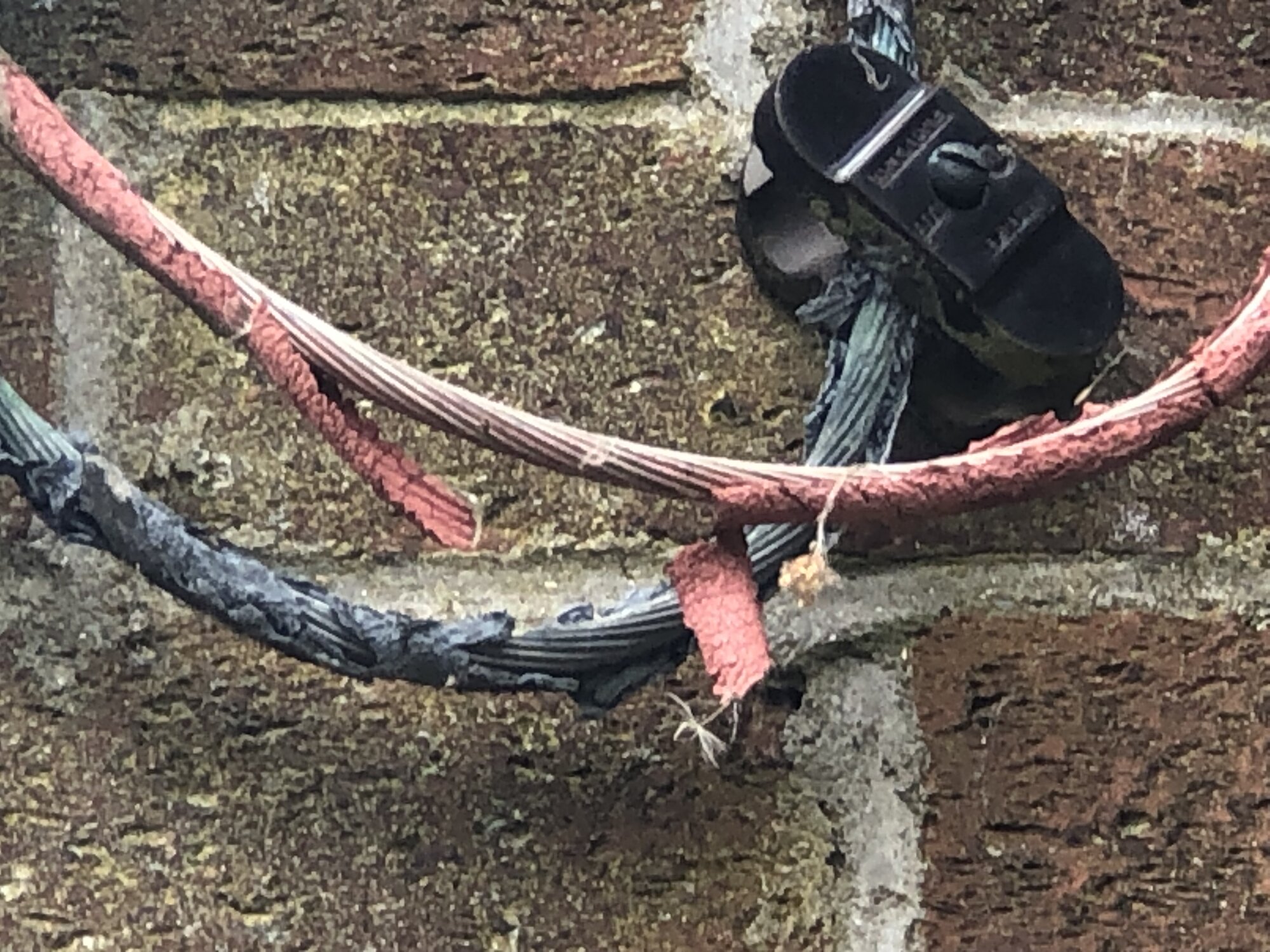

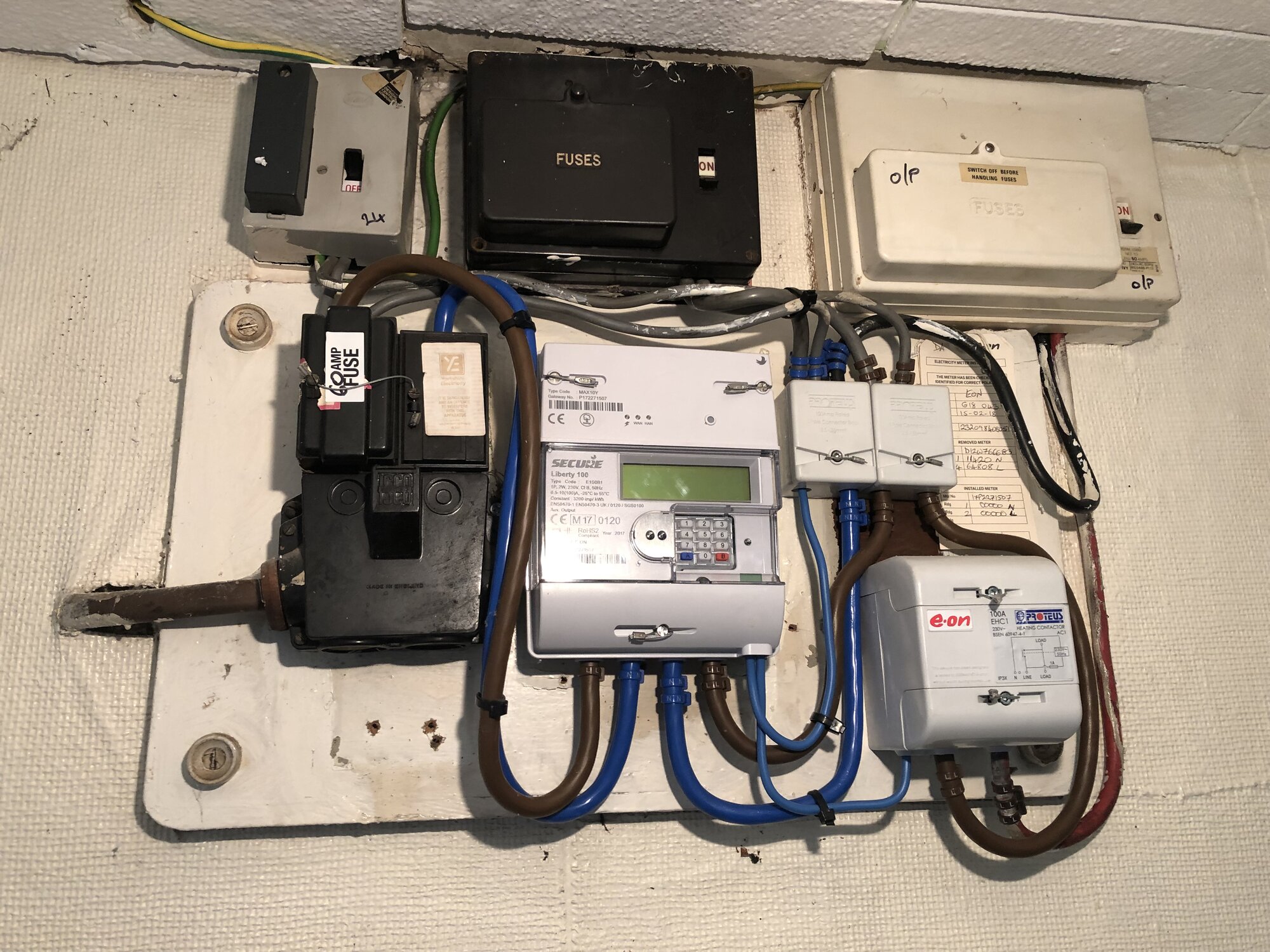

He's put the install as TN-S. TN-S would mean the earth is done through the sheathing of the supply cable. What he's attempted to do with the earth would make it a TNC-S.
That work is absolute cack and you're going to have to pay someone else to put it right. I wouldn't have the same guy back to try and remedy it.

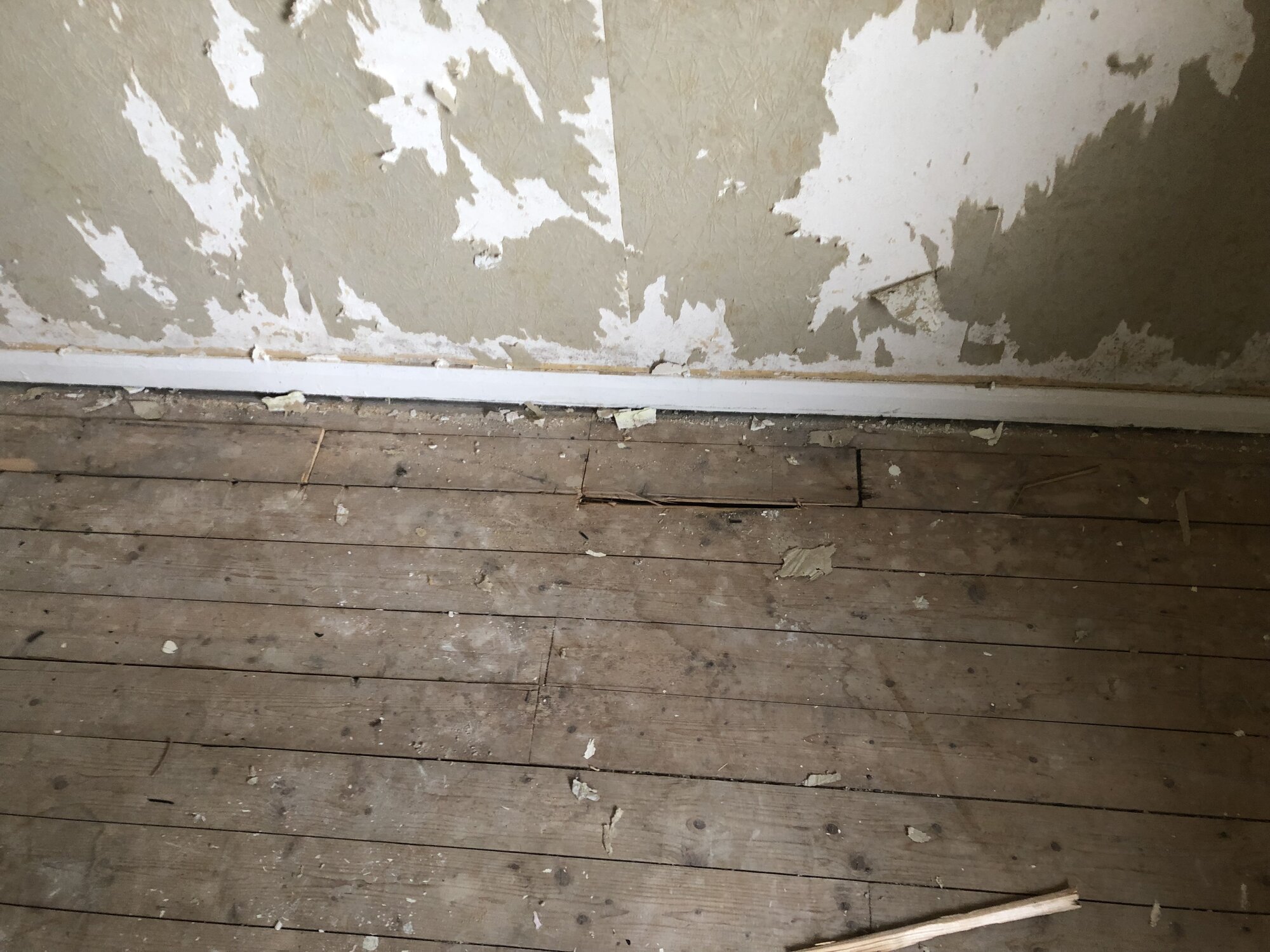

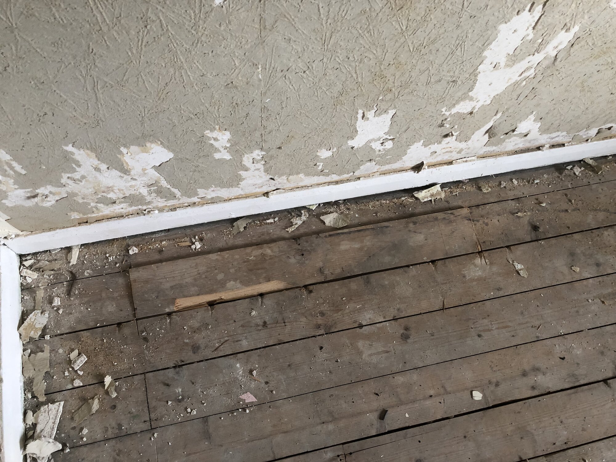

Before that, I'll try get the floorboards back up this evening or tomorrow and take some pictures of the 'floating' junction boxes, I'll isolate the supply and open the JBs to see what the connection are like and photograph.

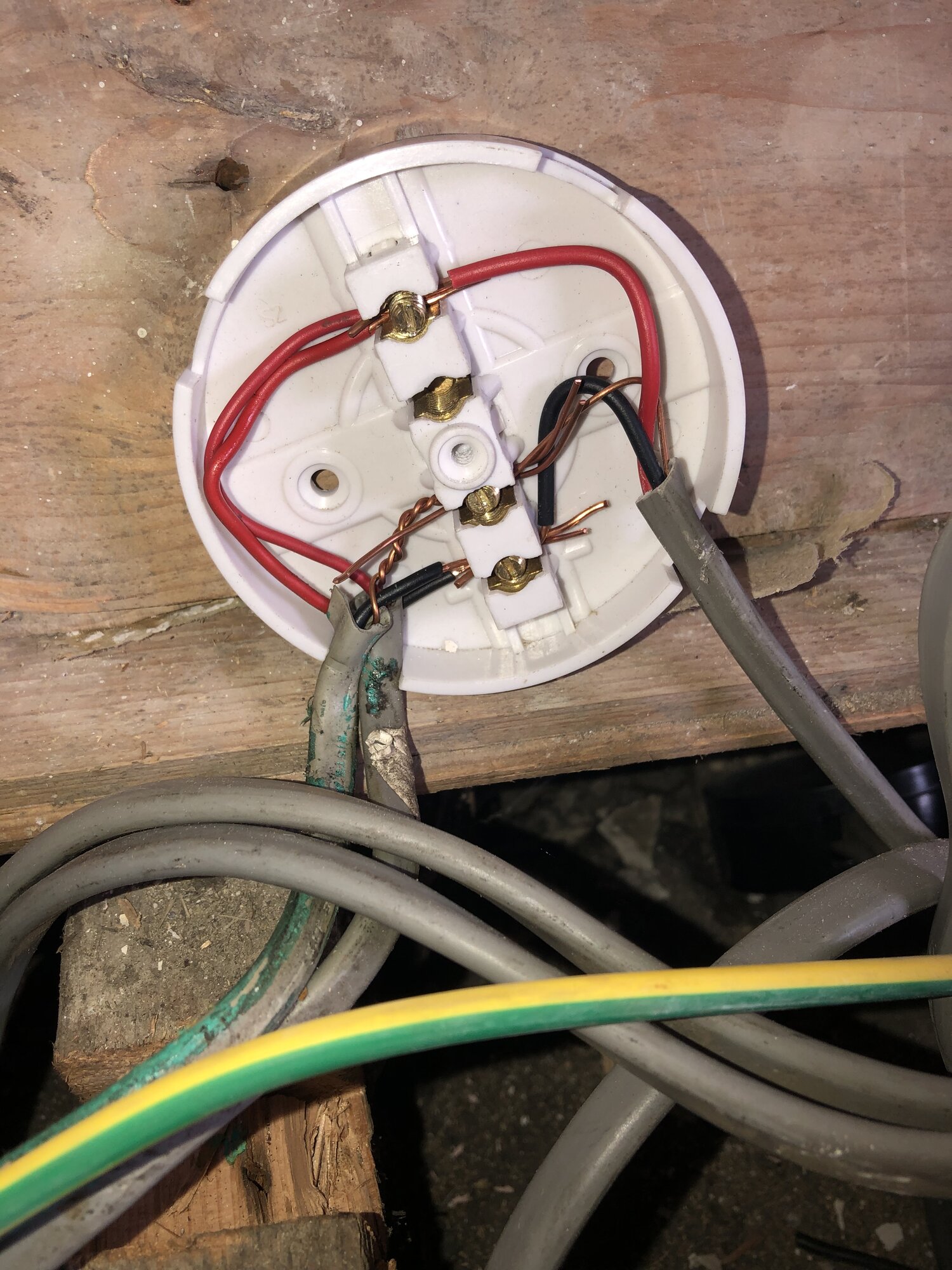

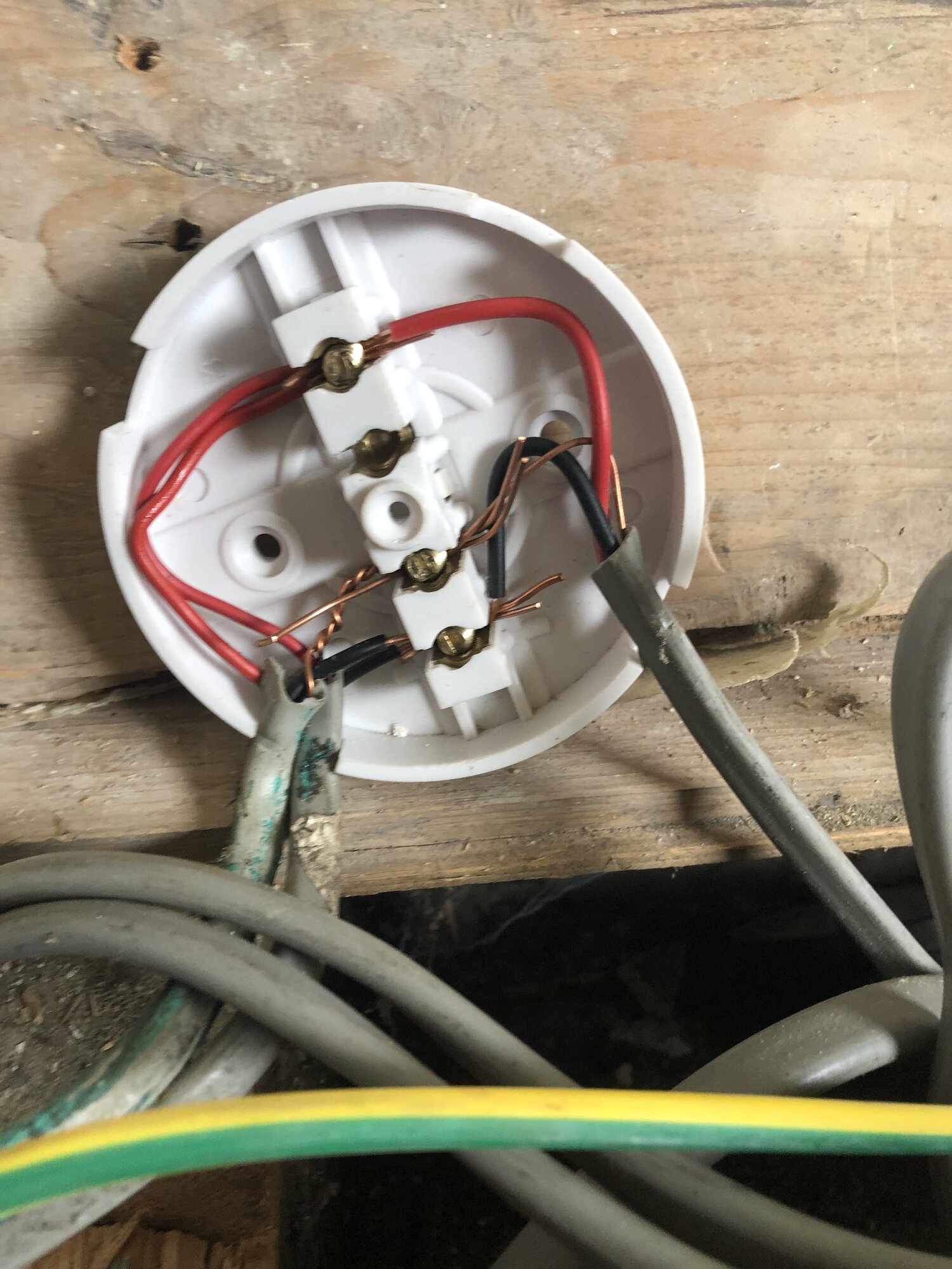

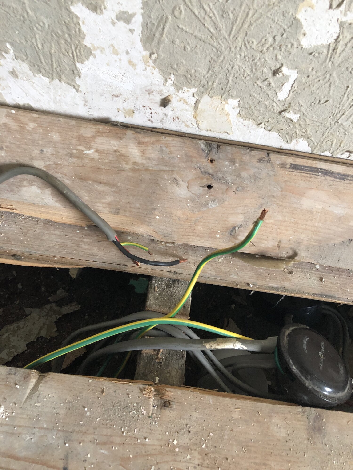

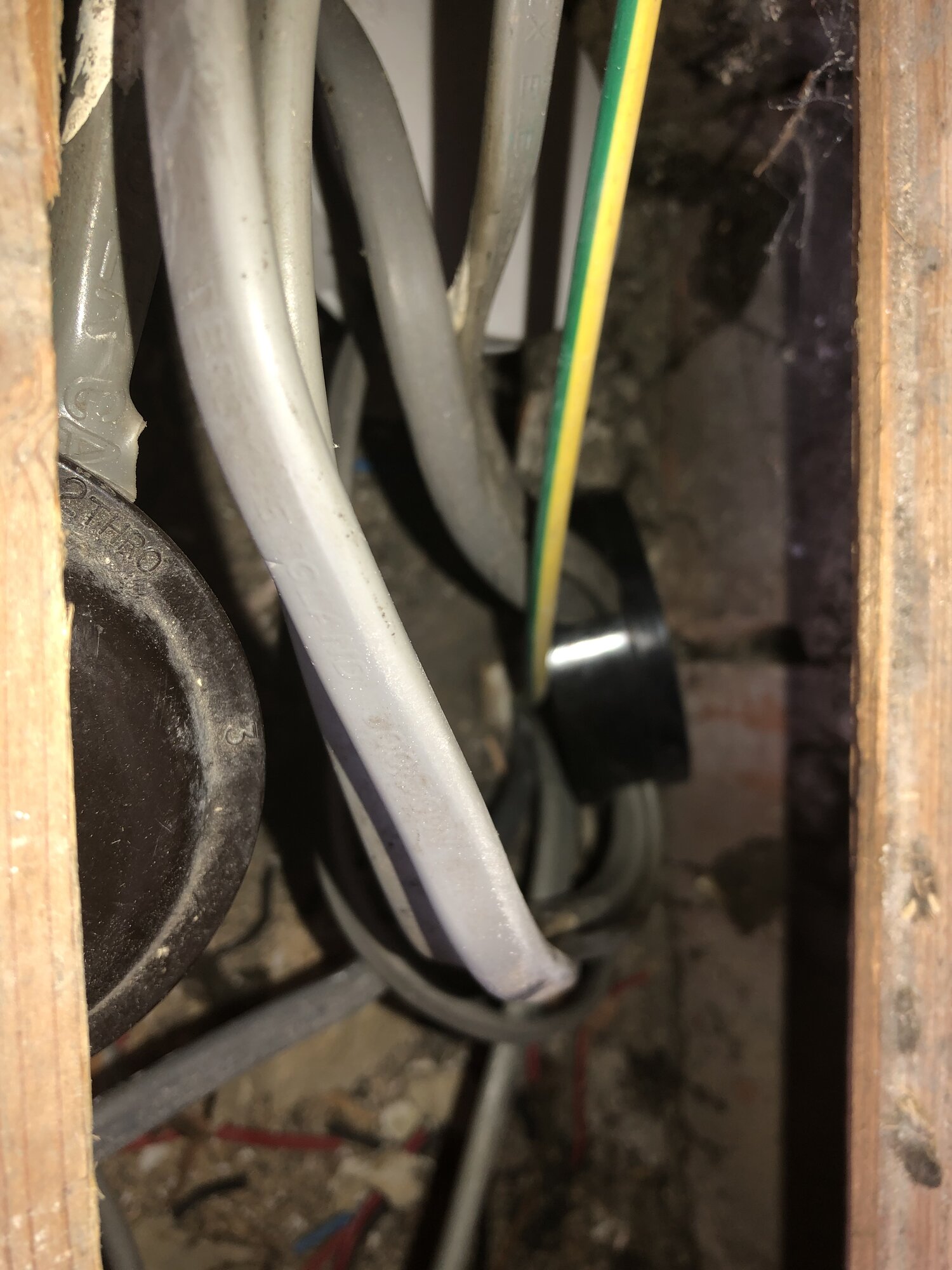

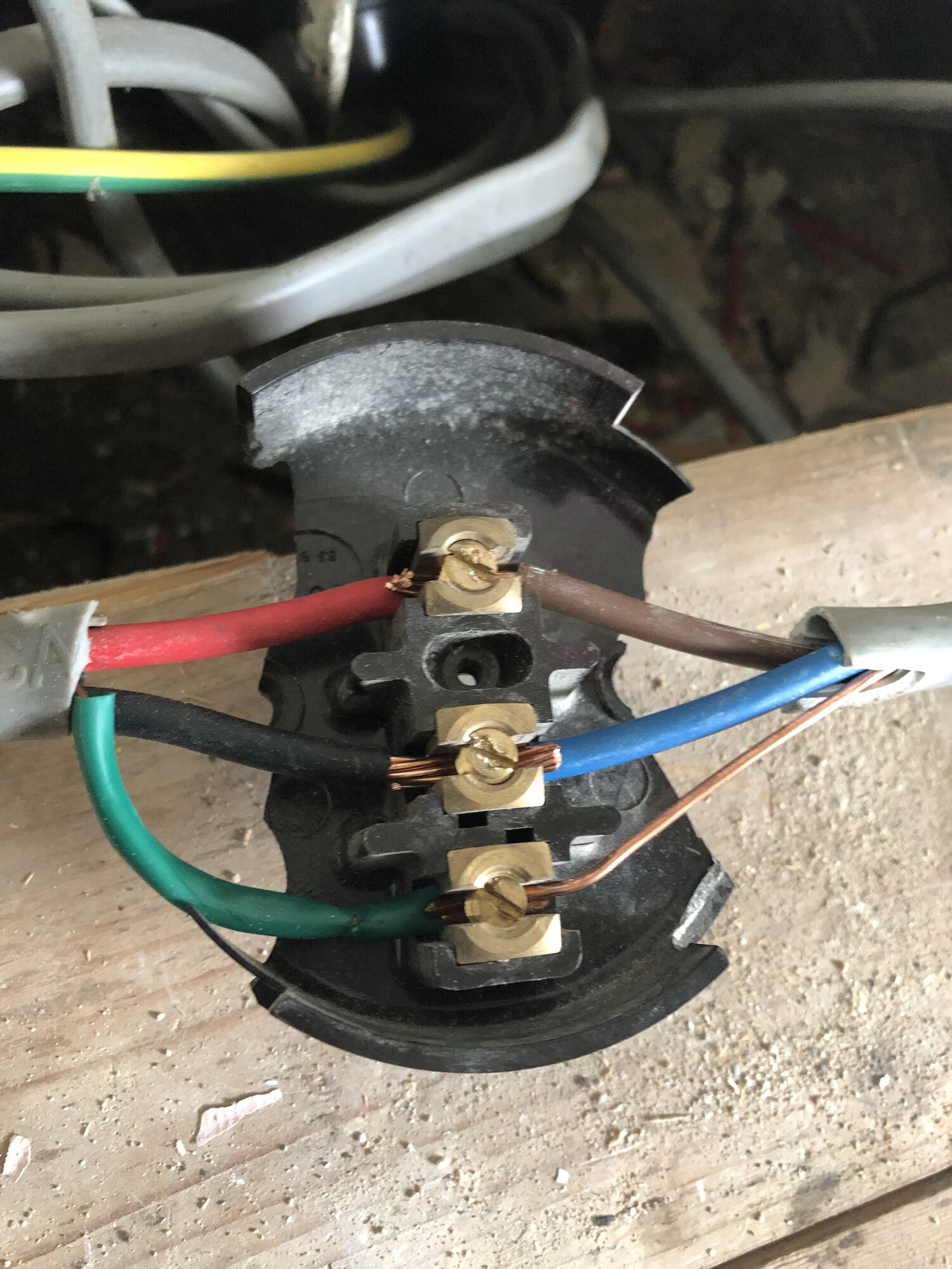

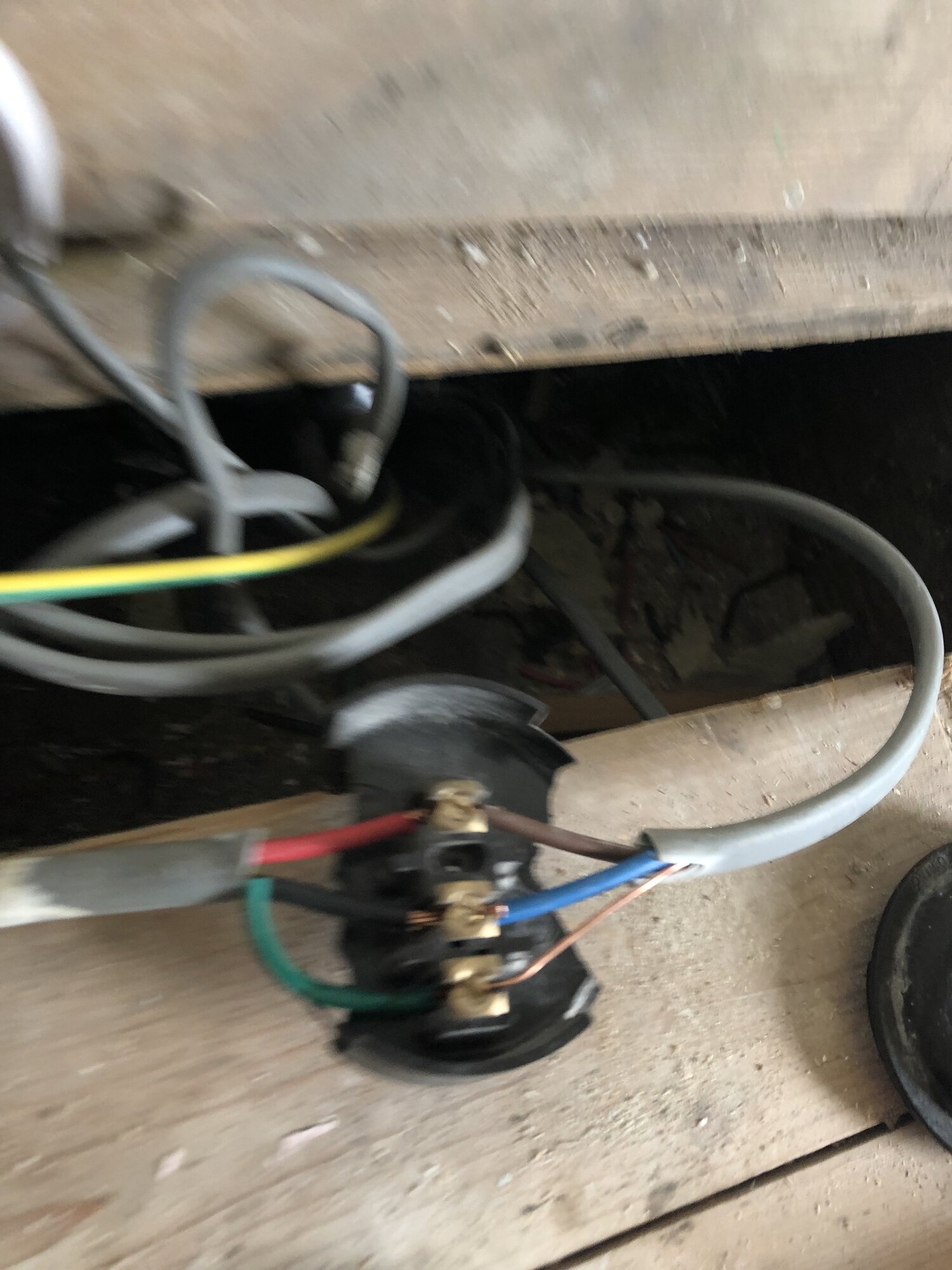

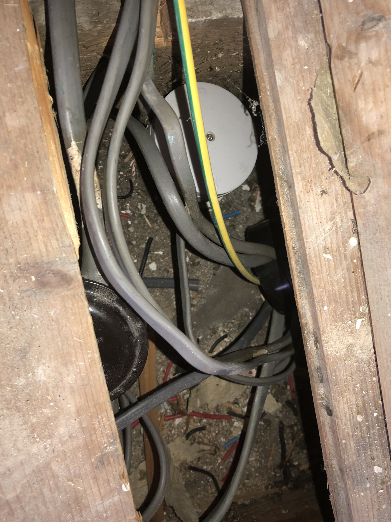

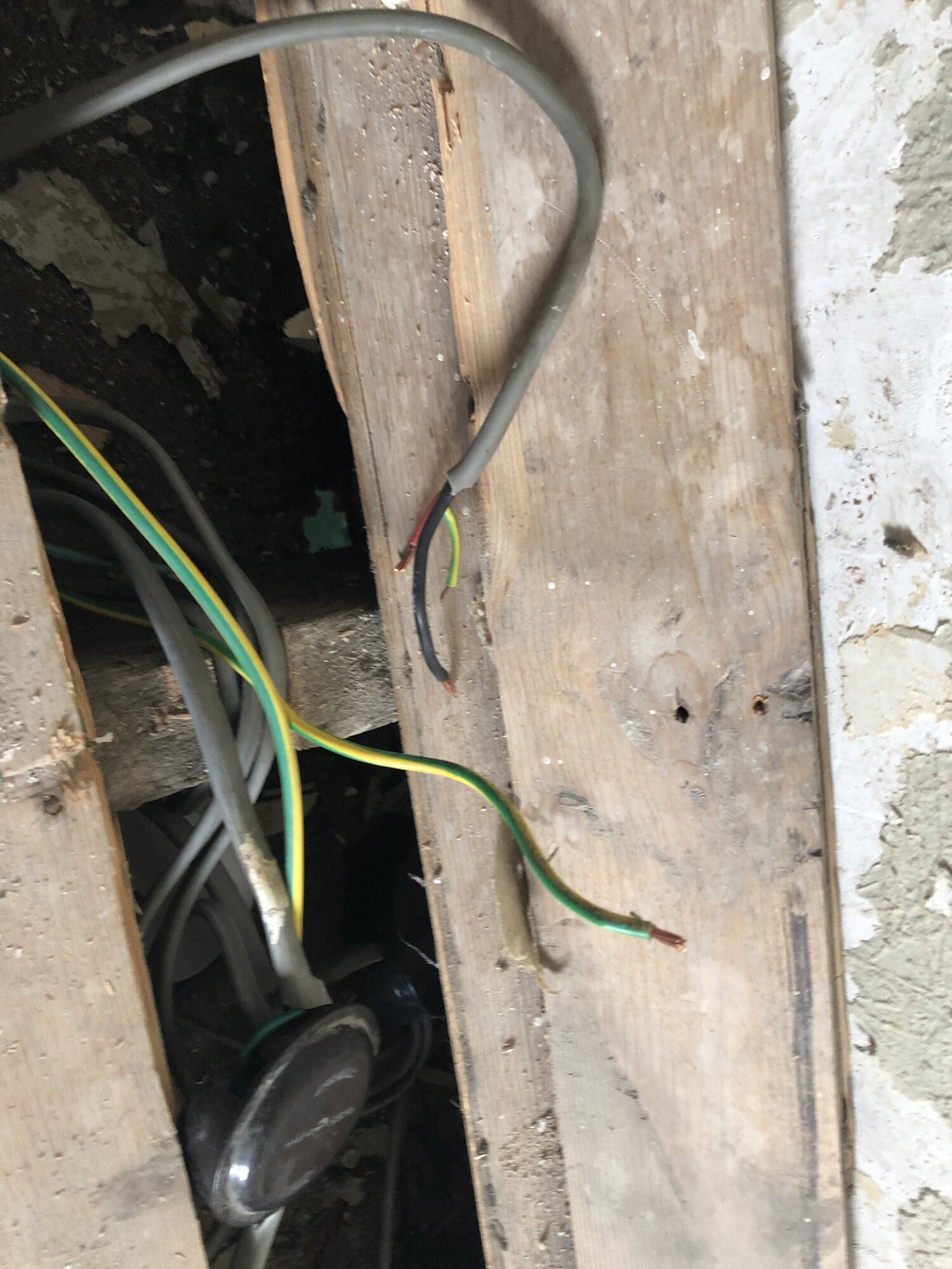

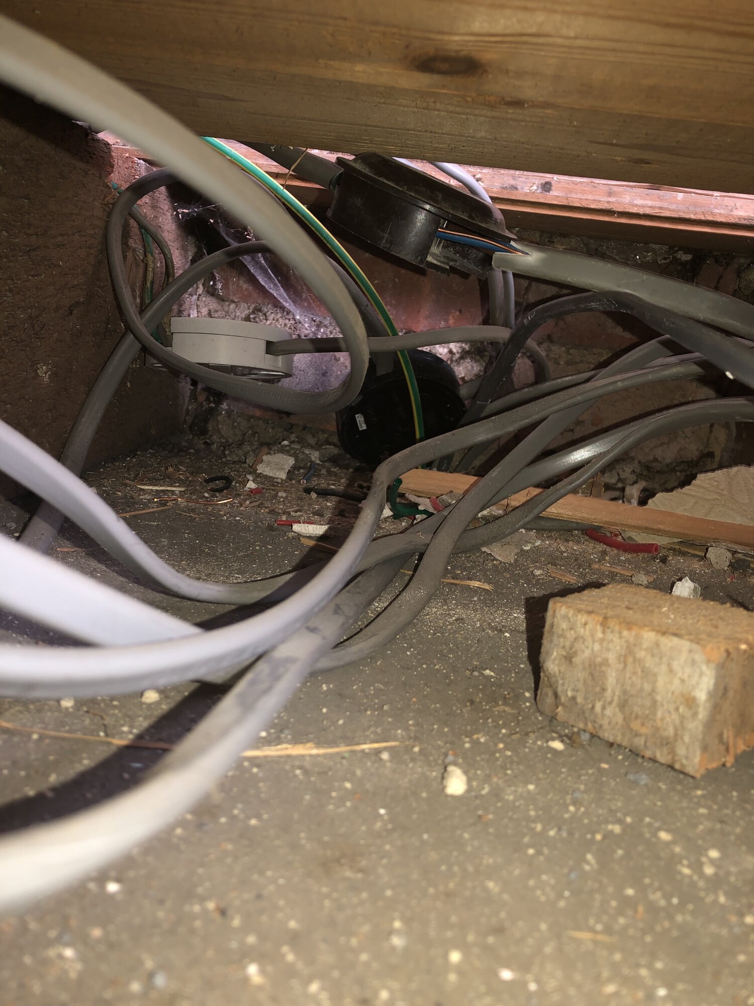

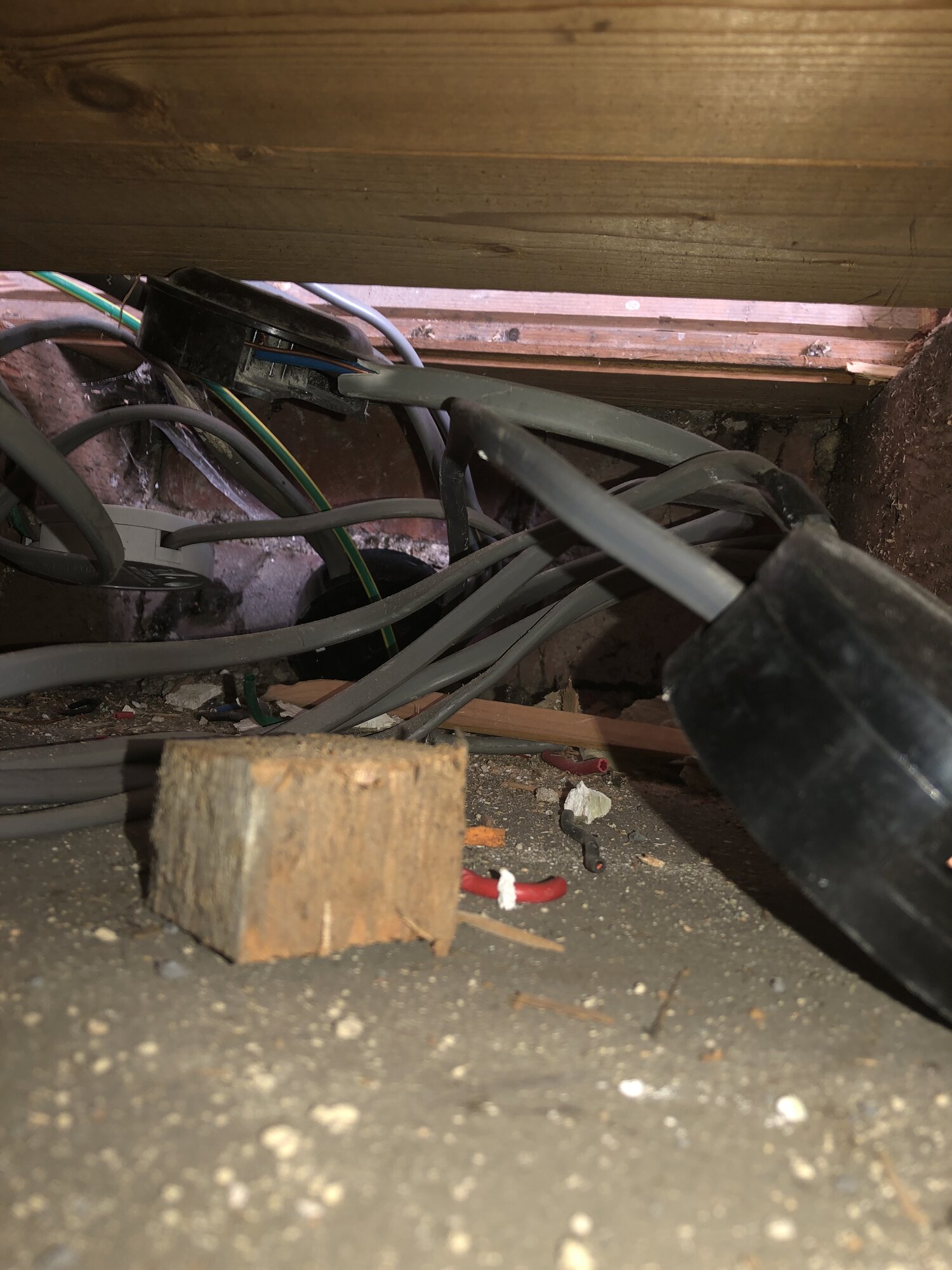

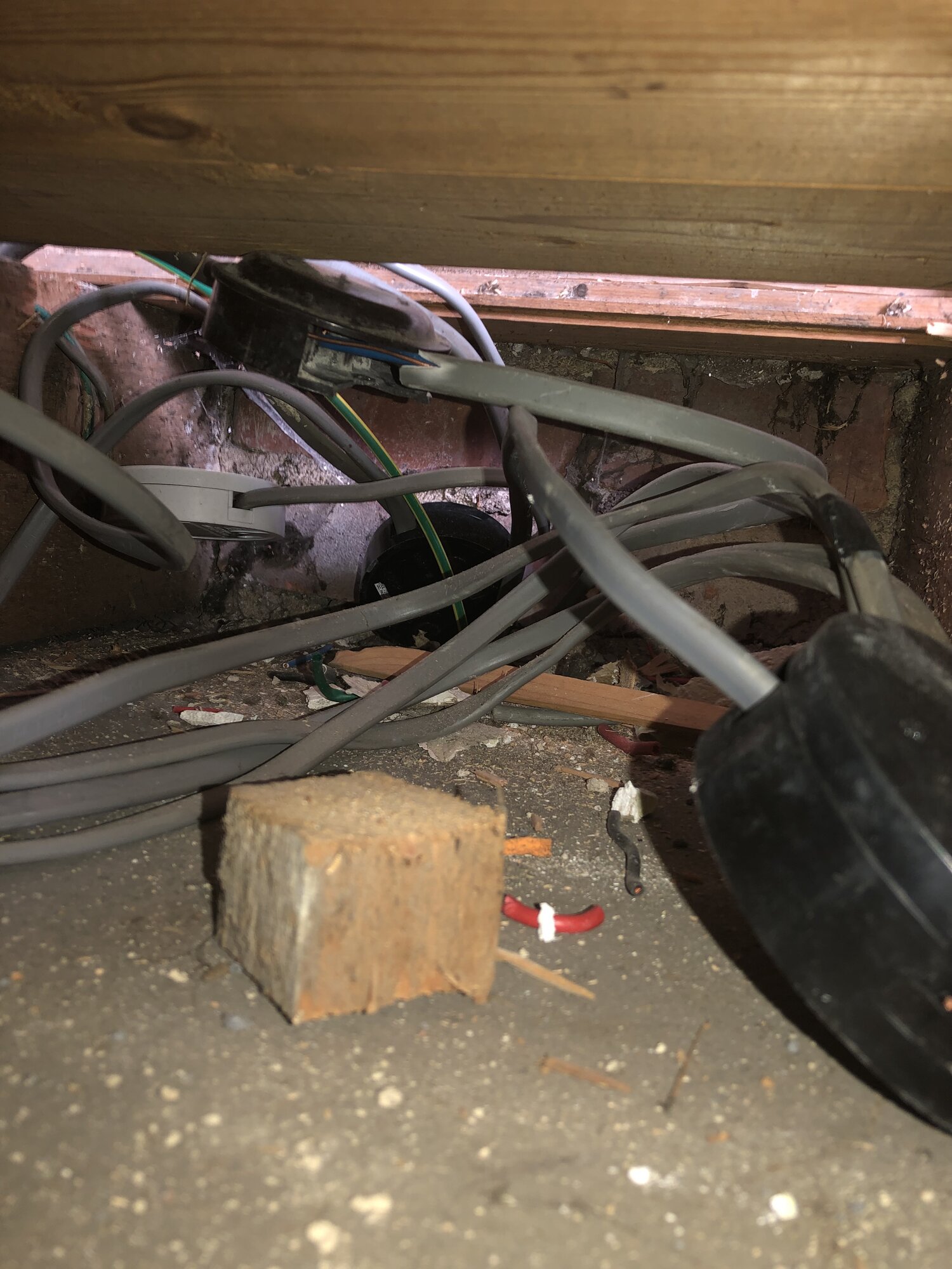

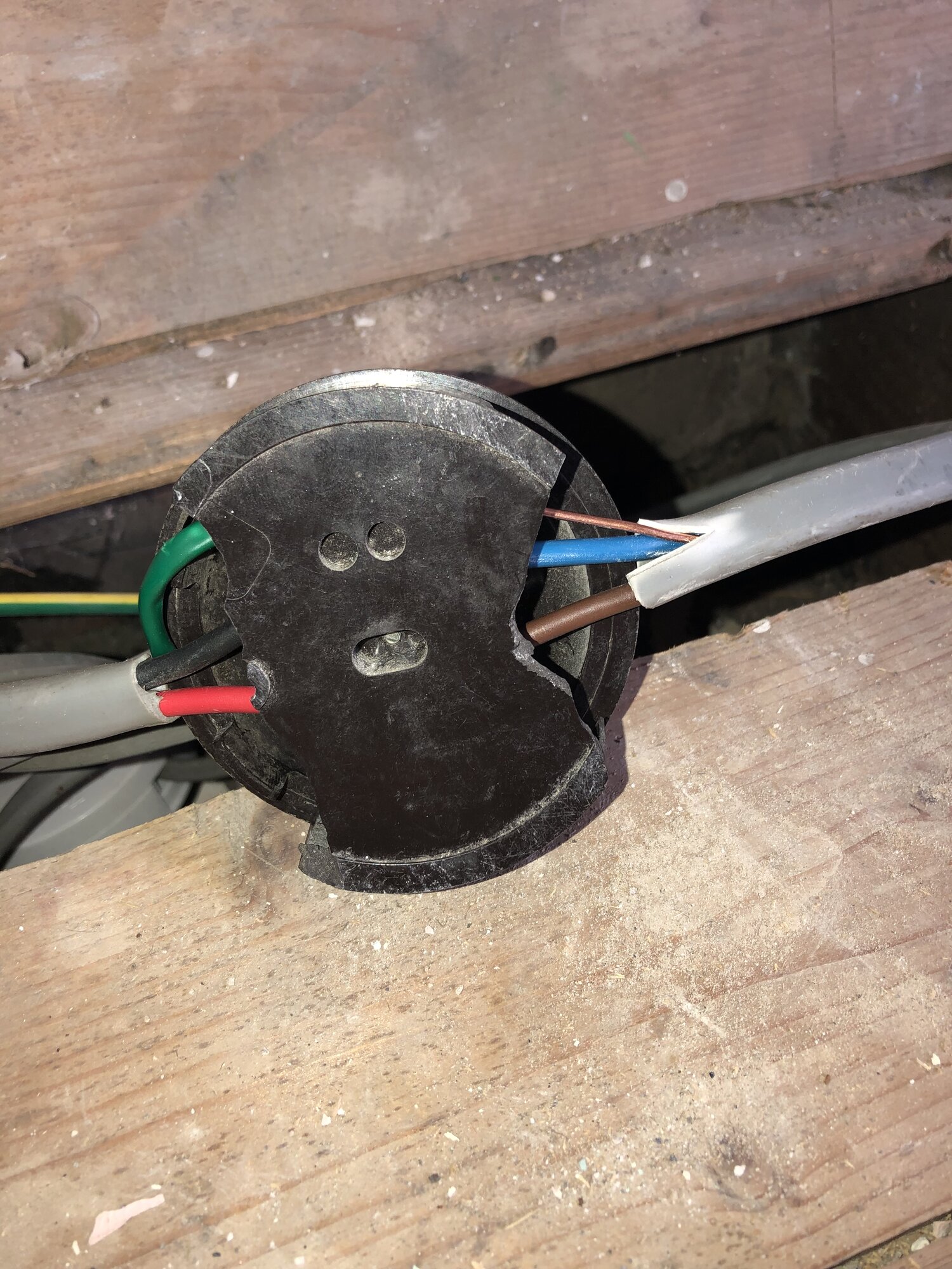

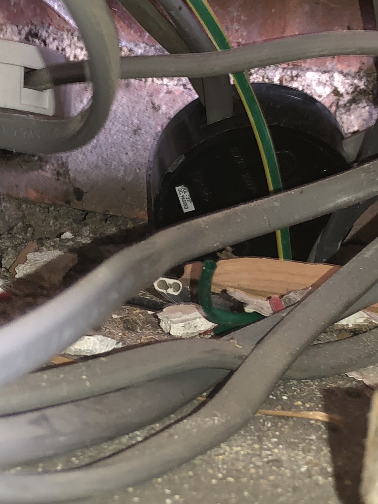

To be honest I couldn’t wait any longer myself so I’ve just nipped round to the house and pulled the floorboards (by hand) as he didn’t re fit them properly and to be honest I didn’t think it could get any worse
He had to extend the cables as they would not reach so everything your about to see is what he has done. They may be the original JBs but he has re used them and, Well. Here you go. Have a look
One of the JBs I couldn’t open because it’s so tort to the ceiling/floor plasterboard that there is no play to twist it enough to open the screw let alone move it. And this is how I found it so nothing secured all floating with bare circuits (al be it a dead old shower 6mm (doesn't look like 10mm, maybe 6mm so probably better i didnt have him re-connect it as it was running an 8.5kw shower). I asked him not to reconnect as we’re removing it for mixer shower off boiler)
I’m pretty upset to be honest. I know it was only £250 but I thought it would be done to at least a basic standard. I could have done that better if I was allowed, I’m not and he is and he has certificates telling people he is allowed to install that and why oh why oh why. Any way. Any Thoughts on the JBs?? (I say sarcastically), He couldn't even put any sleeving on the bare cpc's.
I did safely isolate before opening the JBs
426BC3FC-3FC3-4D69-8FFC-B852EF992C9A.jpeg9BCA2C98-5B95-46BB-8078-113D86DB4EDA.jpegA855C628-E391-458F-8A8A-BA062E8A0BF1.jpegA03DE444-02B6-4A0E-B620-454A8CA3EADD.jpeg1DDC5B2B-0C7C-4677-B63E-A97F11CCBEB6.jpeg1F7BF52B-F5FB-4F0D-A440-18DC18E520AD.jpegFA4DD7EB-DB5C-428B-B4C8-9FDEF5E60ACC.jpeg18485FE6-3947-47EA-BF58-12A3E76278CE.jpegA0BCFBE3-356E-4C0F-A544-4E3915513D53.jpegCED09FC7-58E0-4FAF-B577-F02B8B5BF574.jpeg0FB893A4-33A6-4868-BC4C-C1AD1C5C1EDC.jpegF150D77D-7258-4D9E-ADB6-A130484C1426.jpegE6FFB503-FB53-4470-A880-4B0831B65222.jpeg9F2C68AD-2829-4A91-91C2-392637378497.jpeg91FFB665-F234-4176-9403-CFEA0C5A08B0.jpeg
Even worse than I expected.

View attachment 98981View attachment 98982View attachment 98983View attachment 98984View attachment 98985View attachment 98986View attachment 98987View attachment 98988View attachment 98989View attachment 98990View attachment 98991View attachment 98992View attachment 98993View attachment 98994View attachment 98995
it's not clear exactly which bits he extended in that mess - any new cabling he added would be in the new colours surely? (perhaps I'm assuming too much!).
Any junction boxes that he worked on that were going under the floor should have been in Maintenance Free junction boxes - and to be honest it's so much easier to do things in Wago boxes with Wago connectors in any case that I have no idea why anyone would do anything else these days.
I assume the broken JB with the 6mm in is currently isolated completely at the consumer unit, not just turned off at an MCB? Surely that new cable (brown/blue) was not put in and left by him like that? :eek:
If it's not needed then it should be cut off or removed from that junction box so that it can't be reconnected by error in future...
JBs under the floor like this should always be mentioned on an EICR (even if only as a C3) - usually of course they are not detected because floors aren't pulled up, but in this case if he had to work on them then there's no excuse for not correcting the ones on any circuits he worked on at least - and ideally replacing the whole lot as part of the work...
Shocking work. Just an FYI, 6mm is fine for an 8.5kw shower as long as the run isn't massive.

wow, this is shocking. It might be worth noting that the board is in the same configuration as is sold on Screwfix. If you have any photos of the original boards it might be useful to check if the circuits are on the correct size devices. Odd that they used a tails gland
Given that cables were extended, the board could be dressed in any configuration.
Why would you consider it odd that they brought the tails in through a gland?
I think he means it's surprisingly professional compared to the rest of the work.
Yup exactly that. The glands are £7 on a £45 board.
He took the Proteus Heating Contactor, looked on CEF they're not cheap, did that belong to me or EON? the sticker said EON on it
He most definitely should not have taken it, it belonged to EON. Were the off peak circuits no longer required.

Is replacing that broken JB under the bedroom floor for say a new wiska box and wago connectors notifiable? Am I allowed to do it?
I've been around the building industry all my working life until disability laid me up, I am competent in doing it as long as its non notifiable. As said before, I am more competent than his attempt and if it was allowed I would have done a much better job than he did.
I won't touch it if its notifiable, just checking
It's actually a £70 board, with Type A RCDs - he really went the extra mile 😉
The gland confused me too - shows that some competence went into it, which makes the rest all the more baffling.
That work isn't notifiable no. Is that the circuit that is no longer needed, or is it planned to be reused for something in the future?
If it's 6mm, then Wago do 6mm lever connectors, but they are not suitable for use in their Wago boxes as a designated Maintenance Free box (for whatever reason) - Only the push fit Wago ones (773-173) are.
Te
There are 2 x 6mm circuits. one is bare and not terminated under the floorboards which was the old shower which I told him to leave out. I wont be re-suing it and will be ripping it out from the bathroom eventually. ( un-terminated 6mm shown in one of the images)
The other 6mm is the cooker circuit. Its roughly a 6 meter run from dp cooker switch up the wall to under landing floorboards through bedroom and down to that junction box just over the ceiling above the cu.
I thought 10mm was better for cooker? Now I know its 6mm I take it I should stay away from installing an induction hob when fitting the kitchen!
