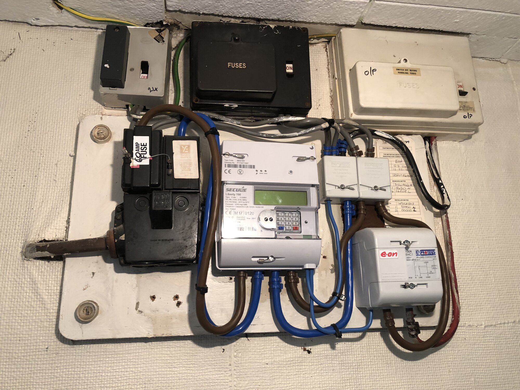

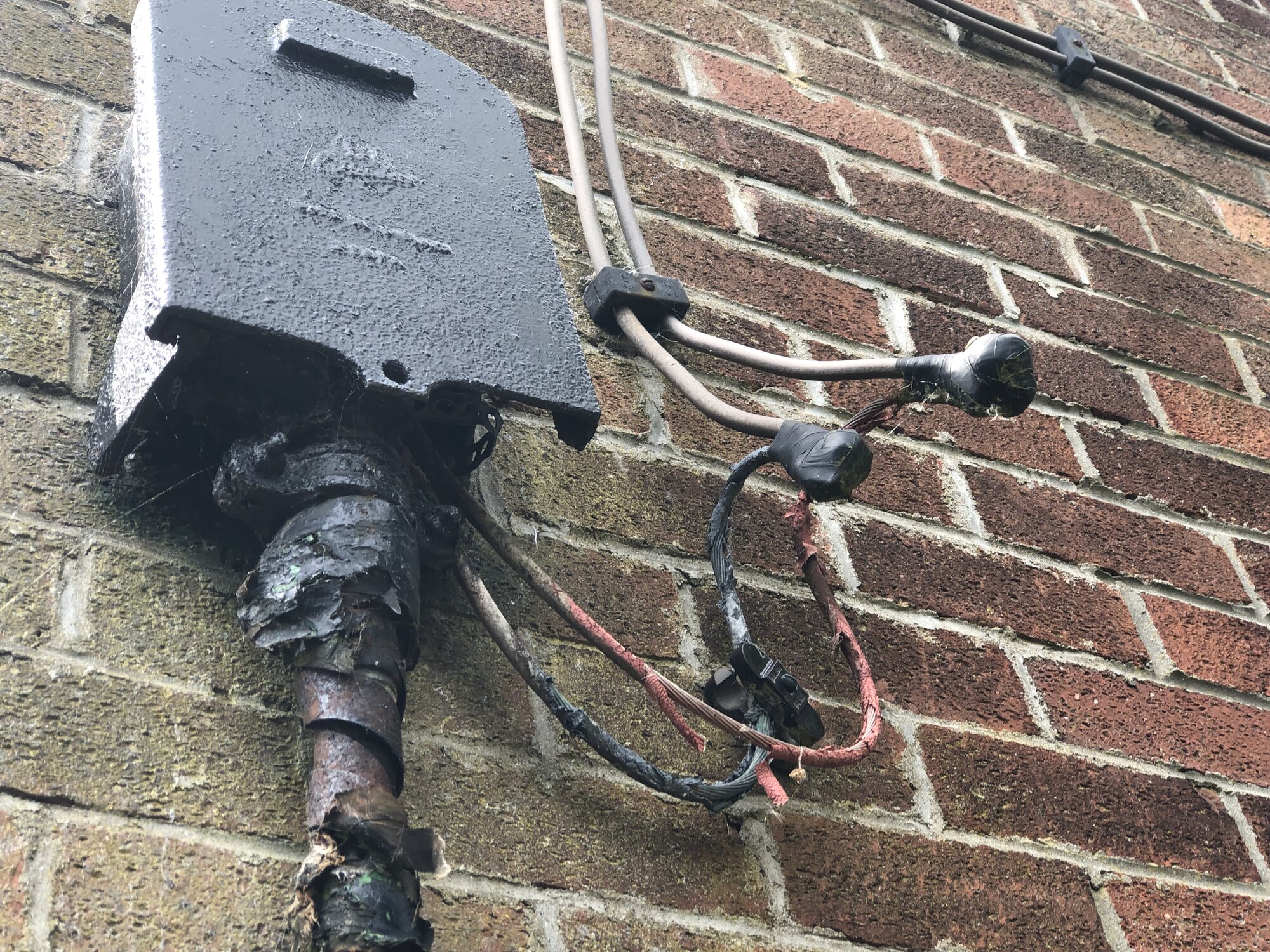

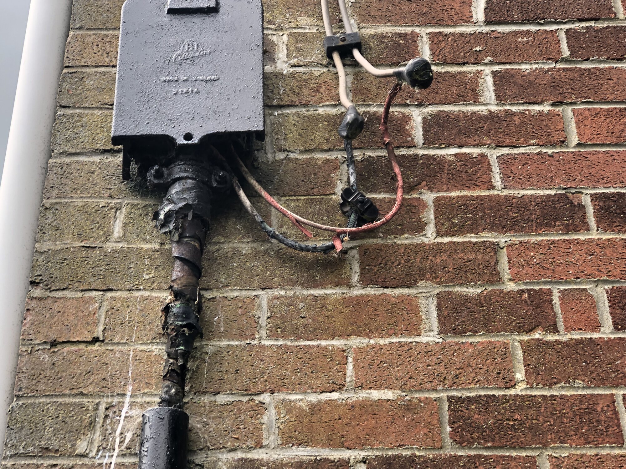

He's put the install as TN-S. TN-S would mean the earth is done through the sheathing of the supply cable. What he's attempted to do with the earth would make it a TNC-S.
That work is absolute cack and you're going to have to pay someone else to put it right. I wouldn't have the same guy back to try and remedy it.

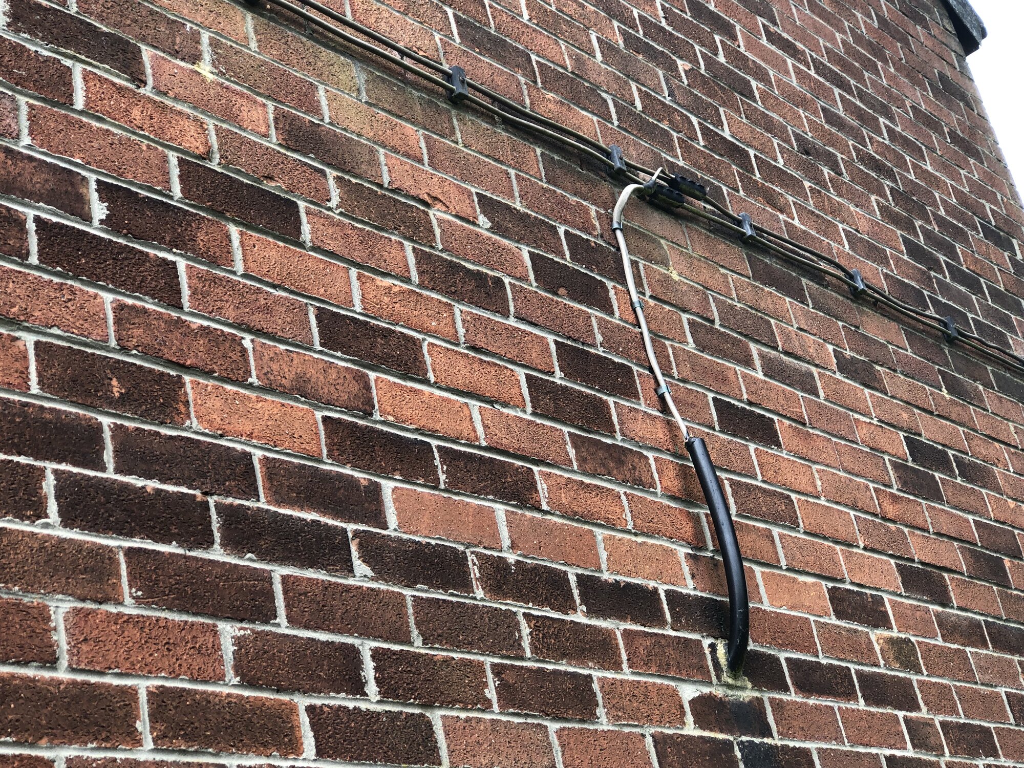

To be honest I couldn’t wait any longer myself so I’ve just nipped round to the house and pulled the floorboards (by hand) as he didn’t re fit them properly and to be honest I didn’t think it could get any worse
He had to extend the cables as they would not reach so everything your about to see is what he has done. They may be the original JBs but he has re used them and, Well. Here you go. Have a look
One of the JBs I couldn’t open because it’s so tort to the ceiling/floor plasterboard that there is no play to twist it enough to open the screw let alone move it. And this is how I found it so nothing secured all floating with bare circuits (al be it a dead old shower 6mm (doesn't look like 10mm, maybe 6mm so probably better i didnt have him re-connect it as it was running an 8.5kw shower). I asked him not to reconnect as we’re removing it for mixer shower off boiler)
I’m pretty upset to be honest. I know it was only £250 but I thought it would be done to at least a basic standard. I could have done that better if I was allowed, I’m not and he is and he has certificates telling people he is allowed to install that and why oh why oh why. Any way. Any Thoughts on the JBs?? (I say sarcastically), He couldn't even put any sleeving on the bare cpc's.
I did safely isolate before opening the JBs

I’m all for giving someone the chance to put something right, but he’s knowingly done that shoddy work and then issued the wrong type of certificate, that’s been hand written so it’s harder to trace back to him.
Now, that in my eyes is very deceitful. He could have quite easily used NAPIT Online to issue the correct cert and notify LABC, but he chose not to because he didn’t want to take the chance of his scheme providers seeing what he’d done.

it's not clear exactly which bits he extended in that mess - any new cabling he added would be in the new colours surely? (perhaps I'm assuming too much!).
Any junction boxes that he worked on that were going under the floor should have been in Maintenance Free junction boxes - and to be honest it's so much easier to do things in Wago boxes with Wago connectors in any case that I have no idea why anyone would do anything else these days.
I assume the broken JB with the 6mm in is currently isolated completely at the consumer unit, not just turned off at an MCB? Surely that new cable (brown/blue) was not put in and left by him like that? :eek:
If it's not needed then it should be cut off or removed from that junction box so that it can't be reconnected by error in future...
JBs under the floor like this should always be mentioned on an EICR (even if only as a C3) - usually of course they are not detected because floors aren't pulled up, but in this case if he had to work on them then there's no excuse for not correcting the ones on any circuits he worked on at least - and ideally replacing the whole lot as part of the work...
