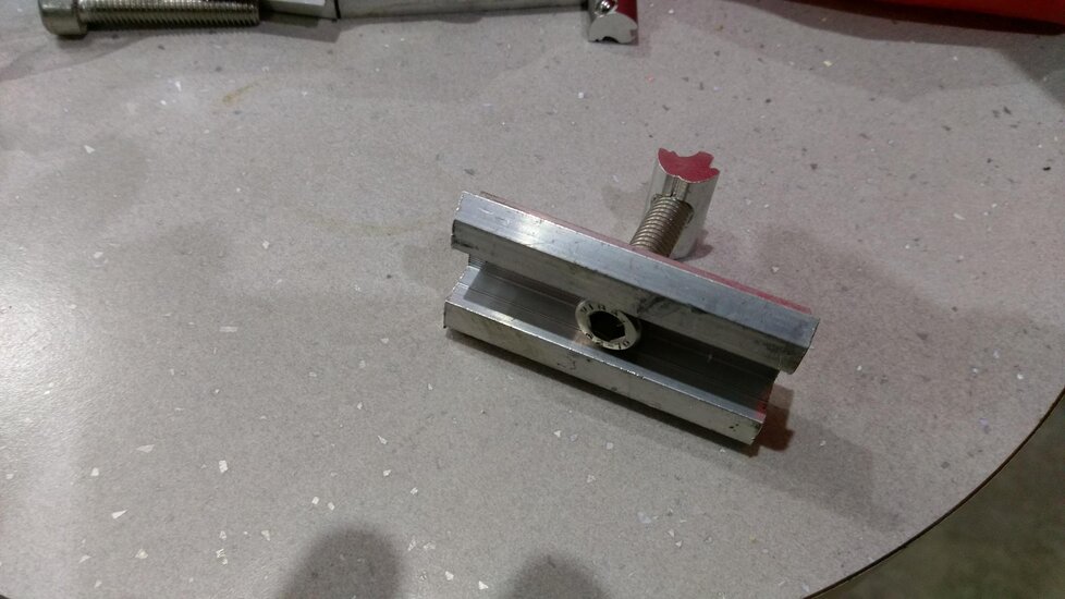

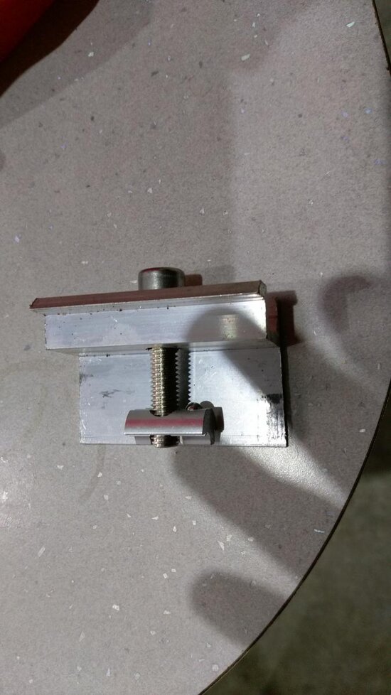

Does anyone recognise this clamp? We've been called out to sort out a job where the installer's apparently gone bust and disappeared after fitting the rails and left a pallet-load of panels on a customer's patio.
There's no scaffold - they did it from ladders - but now it's snowing. They seem to have left just enough clamps, although we've never used this mounting kit. It looks a bit like Hilti. The rounded bit of the fixing could also face downwards - we're not sure about that.
All the paperwork for MCS & FiTs seems to be complete along with most of the electrical work. The customer hasn't got any insurance details and has paid the whole amount already.
Could be Mage.
Edit: Looking again I think its schuco...well the rounded bit of the fixing does.
schuco, but with the bit that slots into the rails fitted the wrong way round.
Not the usual 1 turn fittings, so suspect they were using up old stock and you may have issues with the length of the bolts depending on the panel thickness.
Yes, thanks - that's good. It certainly looks like this:
Schüco Middle clamp Black for module height 35mm (set) - Black - Middle clamps - Schüco - Solar Mounting Systems - GPC Europe
I was concerned whether the clamps would fit panels awaiting them. They are 38mm thick so hopefully both the 35mm & 40mm clamps will work. Or maybe neither will. We won't know until we are up there.
