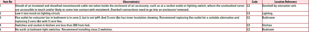

I recently had an EICR carried out and there were 3 "C2" codes identified. I have pasted below.
I have also posted the remedial work quotation from the same electrician
The questions/points I have are as follows:-
1) Is there such a thing as a class 2 light switch? From the remedial work quotation, it seems to be normal light switches with screw covers. There are two light switches that have no earth.
2) As I am based in London, does this seem a reasonable quotation? The extractor wiring is 10 inches from the flex outlet to the fan.
3) The doorbell wire is redundant (I didn't even know it existed). It would need to be detached.
Any advice much appreciated.
For a domestic situation there is no such thing as a Class II switch. All insulated maybe but this will not solve the issue of no earth being present if the back boxes are metal, fitting caps over the metal cover screws is not a solution they are for aesthetic purposes only plus you cannot use Class II protection in a dwelling it is not permitted.

So, regarding the remedial work quoted - is the electrician incorrect in what he is proposing?
The light switch replacement will not resolve the issue.
Reactions: loz2754
Obviously the best solution would be to provide a CPC to the light switch.
As an interim measure, I have, in the past, used 3.5mm nylon socket fixing screws in this situation.
And a notice placed on the consumer unit, warning not to replace the switch with a metal one.

Thanks for the responses on the Class 2.
So , an alternative would be to use nylon fixing screws - I assume I would be allowed to do this under Part P?
If this is the case, how would I have this signed off, or show that the EICR findings have been addressed?
What about the other C2 findings - can they be undertaken by myself - and if so, how would the work be certified? I am keen to ensure that I follow the guidelines and everything is done correctly.
The bathroom fan would appear to need some rewiring so this should be done by a competent person. I don't advocate the use of nylon screws as this still does not resolve the issue. Any works carried out a Minor Works Certificate will be evidence of the works being carried out.
I've used PVC flush boxes before for damp walls. I don't see why you couldn't use one here to avoid having to rewire the switch drop? Of course, you'd never be able to put a metal switch on it in future, but it would be safe.
