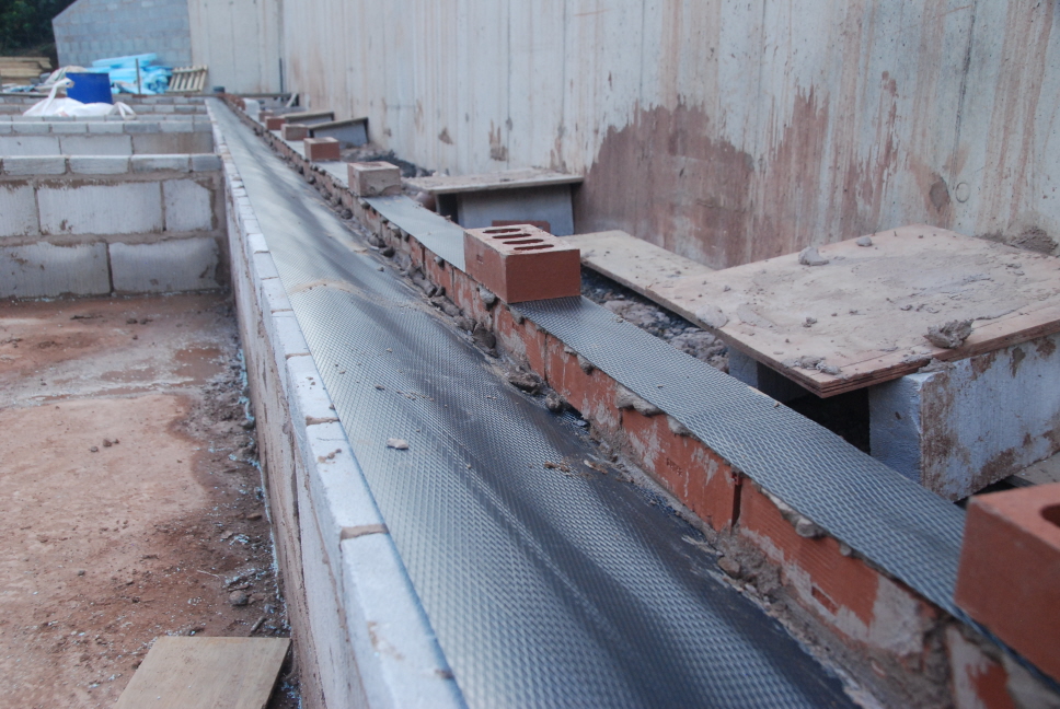

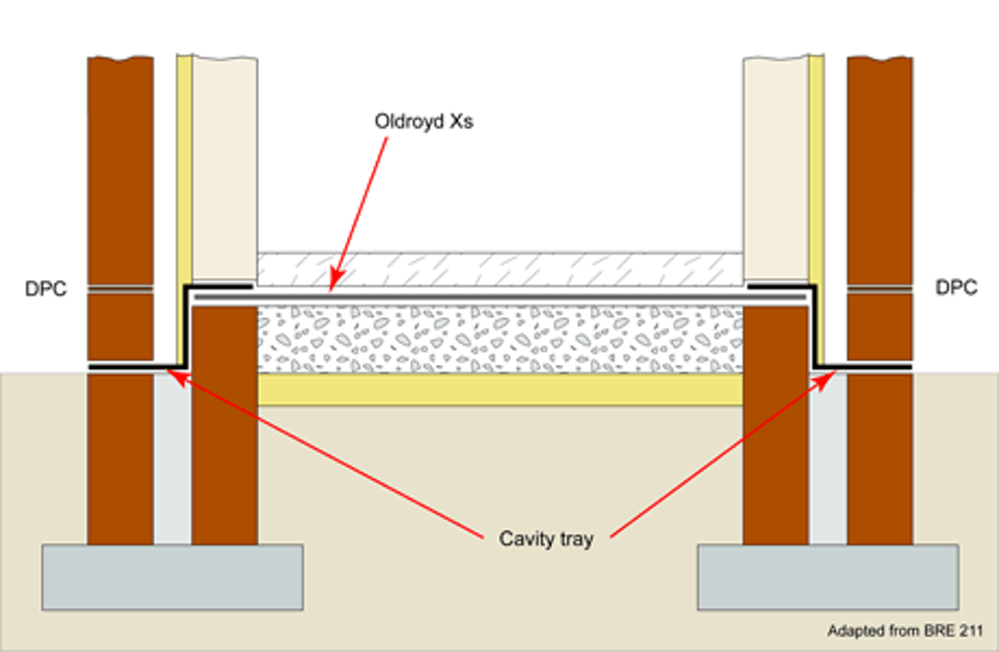

Cavity trays and weep holes are the standard method of draining a cavity, and damage to houses by full fill cavity insulation has been well publicised by the RICS and the Institute of Civil Engineering, you will note below the insulation is only part fill any penetration of this by cables will cause a thermal bridge.I have never heard of cavity trays and weep holes being installed at the base of cavity walls, or of any houses being damaged by cavity insulation. What are your sources for this? Genuinely interested to hear more about this.
Mike this diagram is for radon protection rather than damp, see here: Radon Protection in Above-Ground Environments - https://www.safeguardeurope.com/applications/radon-above-groundCavity trays and weep holes are the standard method of draining a cavity, and damage to houses by full fill cavity insulation has been well publicised by the RICS and the Institute of Civil Engineering, you will note below the insulation is only part fill any penetration of this by cables will cause a thermal bridge.
We did to, but they were all fully occupied rewires the council tenants were still living in them back in the good old days, so you had to keep disruption and mess to a minimum cant think of a better way to use the cavity pull through old to new lovely job.During my apprentice years we done loads of council houses using the wall cavity as a wire way as more often than not it was quicker and cleaner than chasing (we didn't have twin disc wall chasers back then)
I trained and worked as a bricklayer for a few years in the early 2000s, so I know a little bit about this.The purpose of the diagram was to show the cavity tray which someone said they had never seen, this is all standard building works you guys need to get out more.![]()
No Mike, this doesn't tell us anything.Will this. do, note the perps not filled to act as weep holes to stop the cavity filling up with water and coming out the top.
Mike, can you please define 'strawmanning', so the forum can understand where you're coming fromThe original issue was and is the use of the cavity to run cables.
Cavity trays are used when solid concrete floors are cast supported by the ground or beam and block floors supported on lightweight fill, the construction of suspended timber floors is very rare in this age of quick build, cavity trays where used in all the housing estates I was involved with during my working life in the South of England due to the possibility of marsh gas from the clay sub-soil.

There are lots of references to the use of cavity trays at the base of buildings, so it's strange that with all your building knowledge you hadn't heard of it before, It should make you happy that you have learnt something from Mike because as you have said in the past you come on here to learn.That's the theory. Real world, even a 9" solid wall doesn't allow significant damp to pass through to the inside, unless it's very exposed to the prevailing wind, or the rainwater goods have failed and are pouring water all down the wall. The odds of significant moisture making its way to the inner leaf of a cavity wall via cables run in the cavity are very low indeed.
