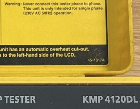

also do those newer meggers do P-P IPF nowadays, I was waiting for the bang. Day one of the 2391 course and our tutor said never ever test phase to phase whilst doing IPF with a single phase tester if you still want eyebrows. I've always doubled the highest single phase reading.

As far as I know all of the megger, and most other name brand, testers have done loop tests at 415V for a long time.
I've certainly always tested phase to phase with both my megger MFT and megger high resolution loop tester.
If anyone is manufacturing a tester which would fail catastrophically if connected phase to phase then it is not fit to be on the market. Even if it can't test at that voltage it should be able to handle being connected to it and at worst be able to safely contain any failure which occurs due to it.
Meggers from 15xx onwards will in all cases handle phase to phase on high-current. The 15xx gets very upset if you accidentally select no-trip and connect phase to phase. The manual says it isn't 'supported' but doesn't talk about the undocumented internal fuse! The 17xx onwards just beeps.
It can be the case (not wishing to cast general aspersions) that college tutors have been out of the day-to-day game for a while and not been exposed to more recent equipment. He is right that you could once easily break a tester doing this:
By the time Robin became Kewtech (in simple terms), the KT63 doesn't blow up but also doesn't handle phase to phase.
So in general, if you have a Megger, crack on!
It was in 1999 I did my 2391 so he was probably correct at the time. I've never had one of the more posey meters (fluke/megger etc) and just had something cheap and functional, I currently have a KT63 and before that I had a Unitest one which I've still got in the van as a backup, 20 years old and still works perfect.
