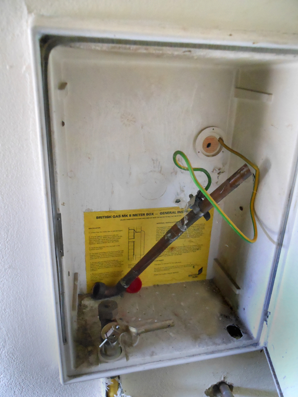

I am reminded of this one I saw:
Where the bonding clamp has been removed this would not affect the other service as the bonding would still be connected through the clamp.
Well there's only one cable there so it would make no difference one way or another.
If there was another earth cable going off to the water then it makes sense to have it continuous in this situation, something floating like this is always susceptible to being pulled or damaged.
