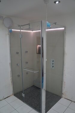

Schluter make a variety of different lighting trims: Trim - https://lilleytileandstone.co.uk/tile-trim.html?cat=460 I have used the tile trim on quite a few different applications, including above a skirting, the lighting tape is available in different configurations, to project downwards only or downwards and forwards, for downwards read upwards according to which way up you have fitted the trim.
