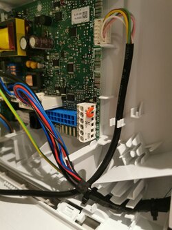

I have just had my boiler replaced which was a potterton suprima 60l. Heat only boiler as it kept cutting out.
I have had a vailent ecofit 425 fitted by engineer but now my pump is running continuously.
This wasn't the case before.
It's s plan with two heating 2 port valves and 1 hot water two port valve.
I have two stats and they are both 3 core.
The boiler as far as I can tell has live neutral and earth the a second cable linked with live which. I think goes to the pump and another in rt.
I have checked boiler setting and they Re set too intermittent with 5 min over run.
The fitter says he doesn't know and has asked vailant to attend at my cost.
Help appreciated. I am an electrician but my heating side is limited.
Ideas most welcome.
Thanks

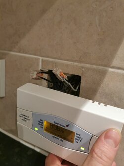

Hi thanks for reply.
The link has been removed and the heating is working on programmer as you would expect.
The pump is even on if I disconnect the programmer because the L and RT cable in the boiler are fed to connectors behind programmer no to the programmer itself.

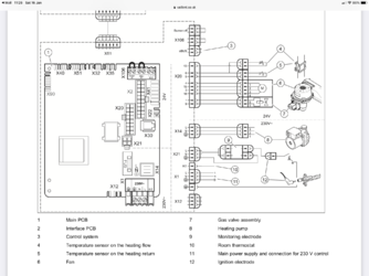

The pump needs connected to the pump terminal block in the boiler, at present there is nothing connected to that block.
Good eyes 123. I couldn’t see the pump terminal in boiler. Where is it?
Reactions: loz2754
X14 - it's hiding under the mains cables, obscured by the brown & blue wires.
Reactions: Edward67 and Timbo
Wow good spot. Couldn’t see it even after you pointed it out. The wife had to point it out to me.

I'd be concerned what else the boiler installer has done as the wago's in 1st pic look like they have just been installed as well.
The one's in the roomstat termination?
TBH I'd rip the lot out and start again.
If I understand you, no, the one in the roomstst terminal is probally correct, the one in the live is probally for the boiler terminal.
Looking at the flex I would have said both go to the roomstat but as the pump's running on who knows what's going on with the wiring...

By moving the the doubled up live to x14 the pump started operating normally. The RT does go to the room stat. As chased it through.
So thanks andyb you are correct.
The installer just missed the x14 because he usually installs worcester but couldn't get one in time.
Thanks for all replies and help.

Should be a 4C flex into the boiler and a 3C out of it to the pump from X14. As it is, it looks like the neutral to the pump could be disconnected during maintenance, leaving a live connected to it, which could be dangerous.
