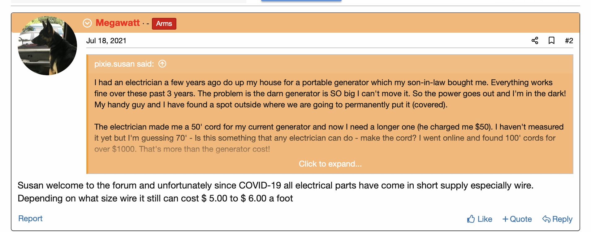

Actually, I just looked it up, no he didn't give me an answer, he said "depending on what wire size you need." That's the problem I don't know what wire size I need. The manual puts it at 6, my handy guy said 8. My friend who is a boat captain and has installed tons of generators on boats said I could probably use a 10. So that's the problem I don't know. And I don't really know who's advice to take.
I know that this is a late reply but # 8 is fine since your plug is rated at 50 amps
