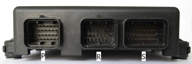

I have an ECU that has 2 x corroded pins that have broken clean off. It's from a jet ski and a new ECU isn't an option. At some stage sea water must have leaked past the seals on the plug and the rest is history :(
The ECU is a hard plastic enclosure and it's filled with a high density rubber potting agent of some kind so I really don't fancy my chances of being able to open it up without damaging it.
Just wondered if anyone had any ideas on how I can repair the pins. They've broken off flush with the back of the socket so there's nothing protruding that I can solder to. My best plan was to take it to a watch maker and see if he could drill and thread the broken pins and screw on an extension pin but I think this would be a long shot.
This is what the socket would look like in good condition
This is what the back of the ECU looks like.

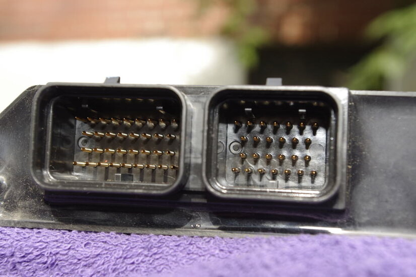

This is what the corroded socket looks like.

Is there no way of getting to the back of the connector? Ideally you might be able to extract the broken pins and crimp or solder some new ones on, effectively making it as good as new.
The back of the connector is completely potted in a hard rubber compound. To dig the potting compound out would probably cause extensive damage.

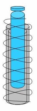

An off the wall approach attach a male pin to a spring and fit the spring over the female pin with the male pin inside it but sprung out so that when the plug is pushed together the sprung pin presses on the (smoothed) stub, not good for high current but may be OK for a control connection.

At the moment the broken pin is flush with the back wall of the socket, if anything the corrosion might have gone slightly below flush and even if I manage to use a hollow drill to remove some of the plastic material surrounding the broken pin I think I'll only have a protrusion of a millimeter or two to play with. I might just get enough to install some kind of sub-minature crimp but I don't think there will be sufficient for a sprung pin connection or any other similar mechanical connection to make stable contact.
You really would have to drill it out, and hope there is enough pin behind the plastic to work with, the link I gave is for the micro size drills, and if you were not keen on the solder idea then you could, if you were careful, manage to just do a friction fit into the drilled hole, if you turn / sand down the end of a pin (of the correct od) to the size of the hole but taper it, it could be drifted into place.
I'm going to attempt to excavate around the broken pins with a hollow drill this weekend and see how much pin material I can get, this will probably determine my options for repair. Drilling a hole in the center of the pin won't be possible for me to do, I don't have the equipment or the eyesight :). I would need to fabricate a guide to go over the remains of the pin to keep the drill on center and I don't have a drill capable of running a bit that's 0.3mm or thereabouts. I'm really no good at sub-miniature work.

Okay, I finally got around to this yesterday. I managed to excavate around the broken pins with a home-made hollow drill and I soldered wires onto both the broken pins. The corrosion was quite deep and I had to excavate about 8 or 9mm to unearth sufficient bright metal to solder on to, it was deeper than I intended going but luckily I didn't hit any circuit boards or components whilst digging. I removed the corresponding pin in the plug and threaded the wires through the plugs as they were reconnected to the ECU. I then manually joined to two new wires to the two now loose wires on the loom. Probably not the most professional job but fairly effective, I wanted to play it safe and drilling the broken pins wasn't going to be easy.
I couldn't run the motor for long because it was out of water but it started and ran for a couple of minutes like a brand new one so I'm going to grease pack all the plugs and get some rubber potting agent to patch up the holes in the plugs where the wires come out. I should get it all done this week and depending on the weather I'll get suited up and give it a test run in the sea next weekend.
