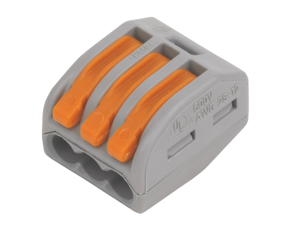

@bailes1992 - You might find these handy in future mate, take 6mm comfortably and rated at 41 amps.
